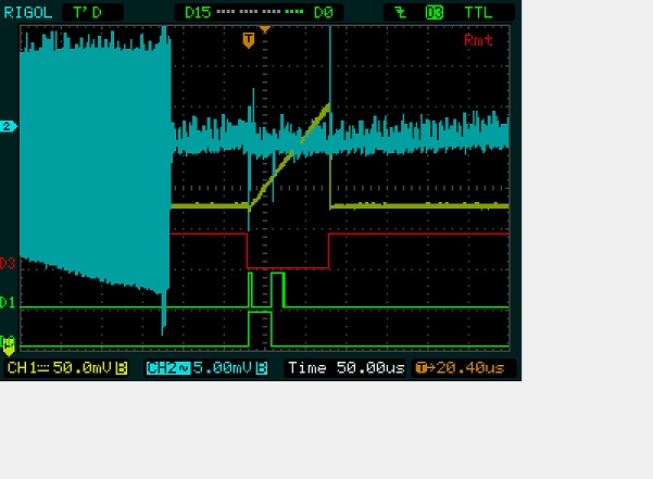

      • hello jon,
        the "FEF Drive" would be used to turn off the receive signal path turing the tx pulse, but you will also notice the adg 1419 is able to do it also with the enable pin, they seem to work very well.
        the PWM_PWR is used to turn the smps (- voltage) power supply off during the target sampleing, by doing this it reduces the power supply noise from getting into the target sample. The frequency is set by either the microprosser as in Bug's version, or preset in the smps driver chip in my version.
        in the attached picture you can see were i turn the power supply off. you can also see where i was taking my time before turning it back on.........

        also here's the software code for doing it:

        when you first look at it it may seem complex, but it's really not, it just take thinking about it in logicial steps

          Thanks for posting the screen capture. It truly is graphic ! I guess seeing that, would make any builder want to implement it into their P.I project. It cuts out a whole lot of noise rubbish.
