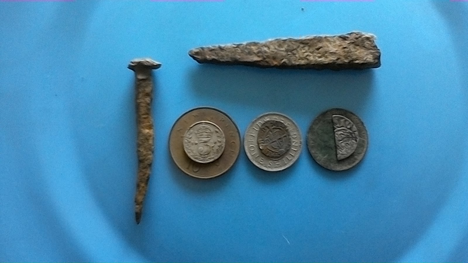

                    With my Bandido and there is a big difference with coin size and testing. With a large coin it can be touching a rusty nail and still be detected. However a cut half, sixpence or sovereign penny the best I can do is 1/2 the coil diameter or 3"
                    Here is what I have been testing with

                    We should come up with a standard test for recovery speed. I compare my home built against YouTube's "Norfolk wolf" test of a cut half and nail
                    https://www.youtube.com/watch?v=RuASrFUdxQQ
                    Depth in fields near me is rarely the limiting factor
