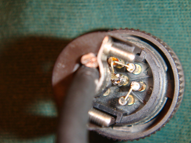

                      Dear Sir ,
                      Would you please explain how to connect the wiring for 1m*1m coil ?
                      I am having a problem with my 1m*1m coil connecter ... as you can see below :
                      Thanks in advance .
                        BINDER connector for all Lorenz detectors frame coil:
                        Pin1 - connected witch MASSE wire
                        Pin2 - Not Connected
                        Pin3 connected with Pin4 and Pin7 and connected witch HOT wire
                        Pin5 connected witch Pin 6
                        This is all
