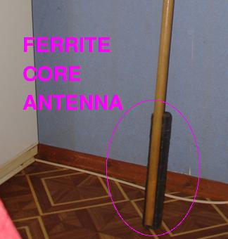

Of course , I am not satisfied , because sensitivity is quite medium now ... for example , search distance for coca-cola can is about 50 cm , nickel coin of 2,3 cm diameter - is something about 12 cm . But my sensor coil in this experimental device is far from ideal now , so I hope to improve the parameters after ferrite core replacement . I couldn't find a good monolithic core and made it from 3 pieces with total length 27 cm , and of course it's not goodOriginally posted by WM6 View PostHi deemon, did you take some sensitivity tests on different targets?
Are you satisfied?
1,5 mA current consumption only is really a great achievement.
. I think that it's better to use longer monolithic stick , if I find it - about 40 cm must be OK for such a portable metal detector . Of course , for special deep search purposes one can make an even longer sensor - because a search depth depends here not of diameter of the coil ( like it does in conventional search coils ) but of the length of the coil - longer coil makes magnetic field to penetrate deeper into the ground .
And another important thing here - is magnetic permeability of the core . Now it's 2700 ( ferrite core for power pulse transformers ) , but there are much better ferrites , as I know . Another idea - to use amorphous iron core - it can have permeability of 50000 or even more - such a coil must be a real champion
. What I think to do - is to find something better than I use now and perform more experiments ... anyhow , I hope that my sensitivity result is not a limit for this kind of PI detectors .
About power consumption - 1,5 ma is consumption of signal processing circuit only ( gain stages , correlators , etc - all shown on page 2 of schematics ) , and the power chain with compensation circuit ( page 1 ) eats about 11,5 ma , and about 1,5 ma for sound ( page 3 ) , so the total consumption is something about 14,5-15 ma from 24 V supply . But because of switching mode stabilizer all device does consume 13 ma from 3 fresh 9V batteries . And of course , this power saving recuperation technology can be used in different manner - not to save a battery with the same pulse energy ( like I did ) , but to rise pulse energy with the same power from the battery . And this can be useful with the big coils for deep search , as I think .
Not bad for ferrite core antenna. Max. detecting field is in front (axial) of coil?Originally posted by deemon View Post
.Attached Files
Yes , maximum of sensitivity is directly on the axis . And this is why I like this ferrite antenna - it can sense big and deeply buried objects like the conventional search coil does and at the same time can sense and precisely locate little objects ( coins , etc ) near the surface . But if we don't need to sense little metal junk - we can reject it electronically , using information from 2 detector channels . In another words , we don't need a special pinpointer with this device ...

Can we say that surface covered by such ferrite antenna is about circle of 3cm in diameter, or maybe 10cm in diameter, or ... more?Originally posted by deemon View PostYes , maximum of sensitivity is directly on the axis . And this is why I like this ferrite antenna - it can sense big and deeply buried objects like the conventional search coil does and at the same time can sense and precisely locate little objects ( coins , etc ) near the surface . But if we don't need to sense little metal junk - we can reject it electronically , using information from 2 detector channels . In another words , we don't need a special pinpointer with this device ...
And deeper in soil, I am curious about ferrite antenna radiation field diagram.
Yes , on low distance it's a spot about 3 cm diameter , and when we go deeper it becomes wider . But anyhow , we have a clear maximum on the axis , so the antenna is pointing directly to the target when the sound has maximum pitch .Originally posted by WM6 View PostCan we say that surface covered by such ferrite antenna is about circle of 3cm in diameter, or maybe 10cm in diameter, or ... more?
I can't help but feel that a ferrite core antenna is not optimal as far as depth is concerned. Perhaps you already know that but are prepared to sacrifice depth for pin-pointing ability. Still it would be very interesting to see its performance with a more regular coil. If its performance improved enough maybe it would be worth your while to switch coils and make a dedicated pin- pointer.Originally posted by deemon View PostYes , on low distance it's a spot about 3 cm diameter , and when we go deeper it becomes wider . But anyhow , we have a clear maximum on the axis , so the antenna is pointing directly to the target when the sound has maximum pitch .
Oh btw as others have noted it is indeed a work of art.Congratulations.
