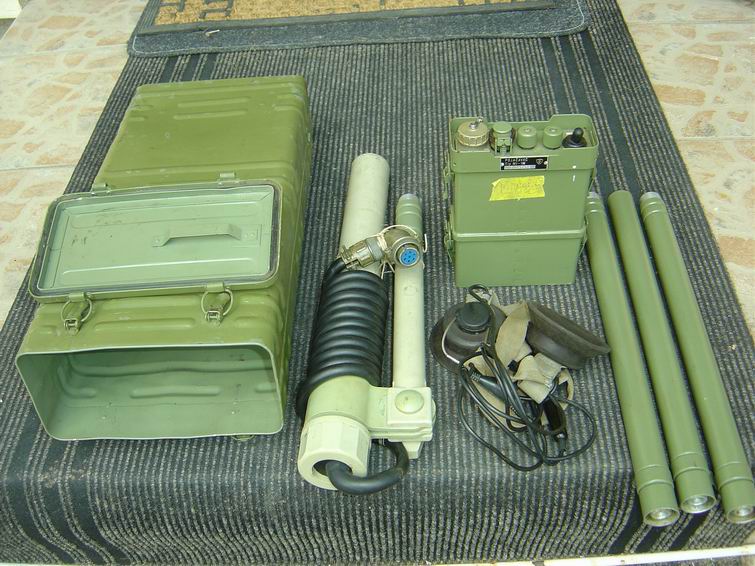

            By the way , I'd seen a quite similar military device here in Russia , but I remember that it didn't use a PI technique , it was a kind of inductive balance .
                You are right deemon, is not PI... it's the induction balance detector (model from the sixties) with two RX coils... http://www.saper.etel.ru/texnica/imp.html

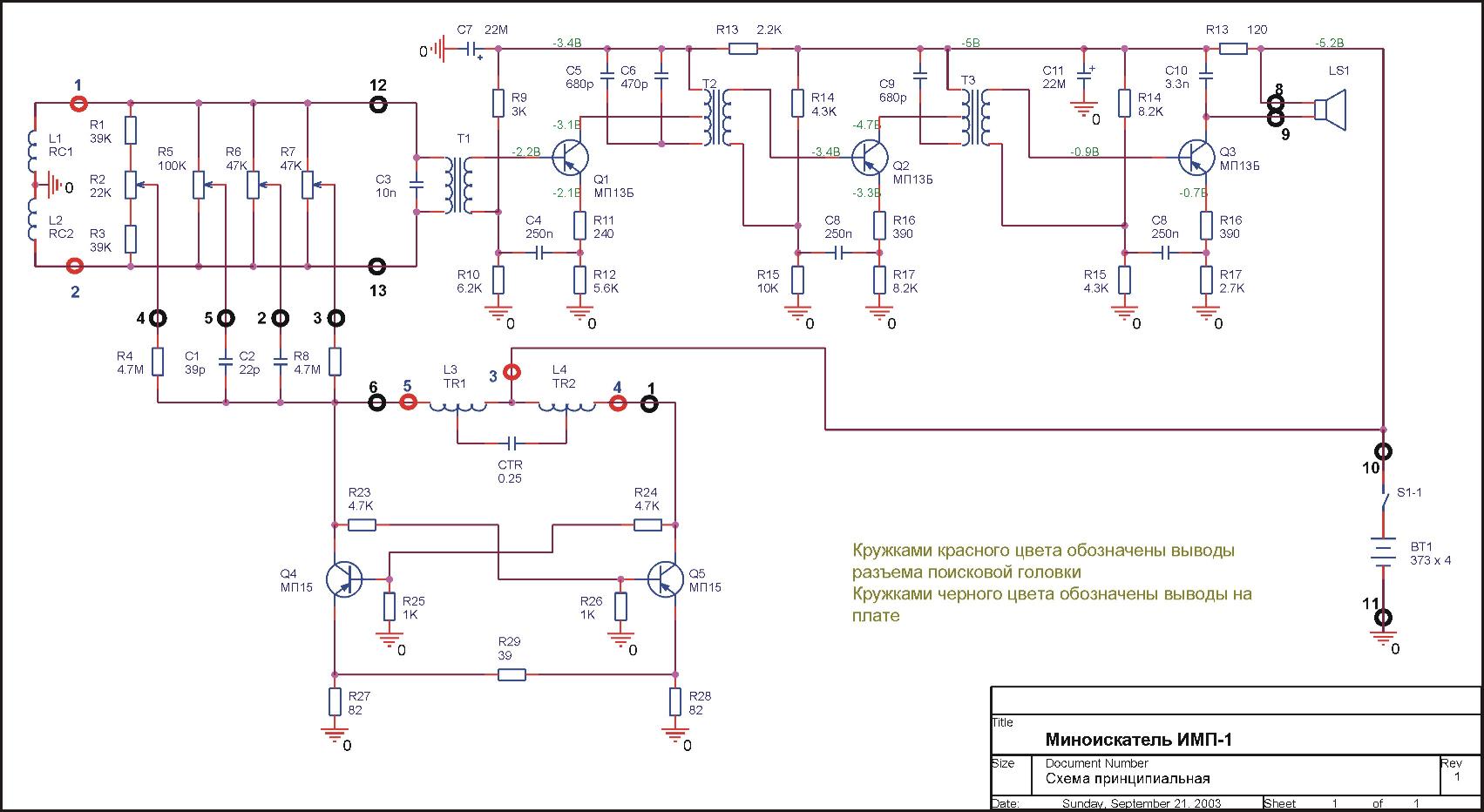

                  Schematics of this contraption|:

                    • #55
                      Ha-ha , I remember this schematics ..... many years ago , in the middle 80-s , I repaired it . I recall now its push-pull generator , balance circuit , transformer coupled stages on ancient transistors .... human memory is a very interesting thing
