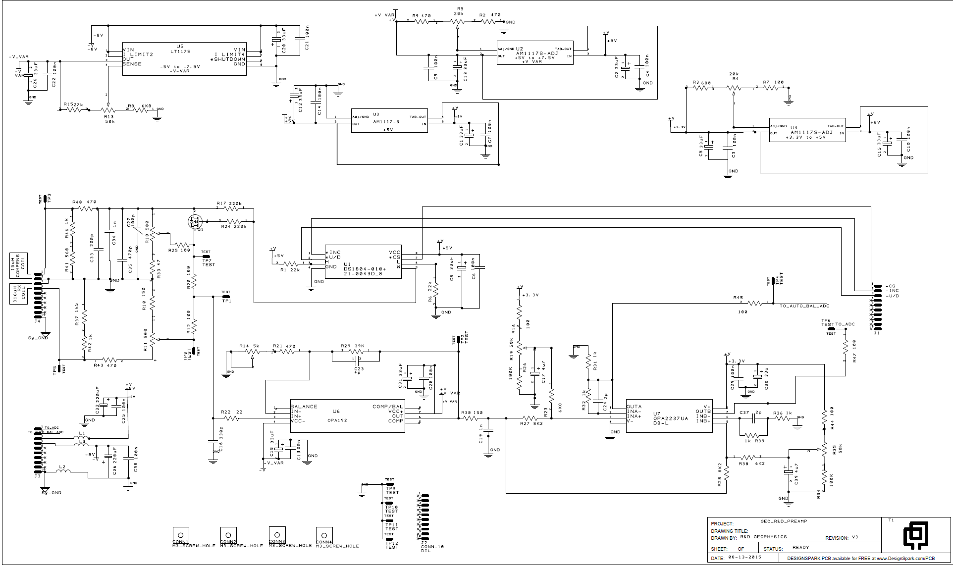

      • #48
        Preamp with Flyback compensation
        Here is the complete preamp circuit to the ADC
        • #49

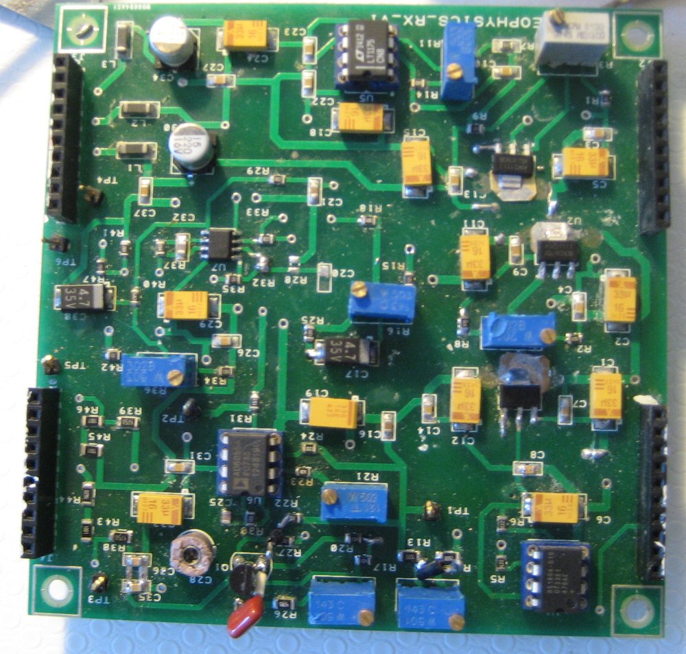

                I also have a few first run PCB's (not populated) of the RX as shown below. Note that there were some mistakes but fixed. Let me know if you want one.
                  Once I get the TX circuit from you and if I get it working correctly, I might buy a RX board.

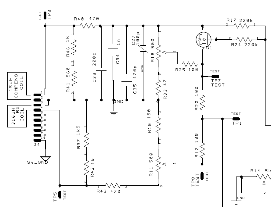

                        • #57
                          Coil matching circuit
                          This is a circuit that matches the input of the signal coil that has 316uH inductance
                          and the compensation coil that has 15uH inductance.
                          Both coils pick up the TX voltage pulse of 300V, in opposite phase.
                          The 2 signals are matched and nulled.
                          Only a very small residual TX signal is left, but the target signal remains and is then amplified.
                          This circuit does the job, but it could be much simplified and improved.
                          Any suggestions?

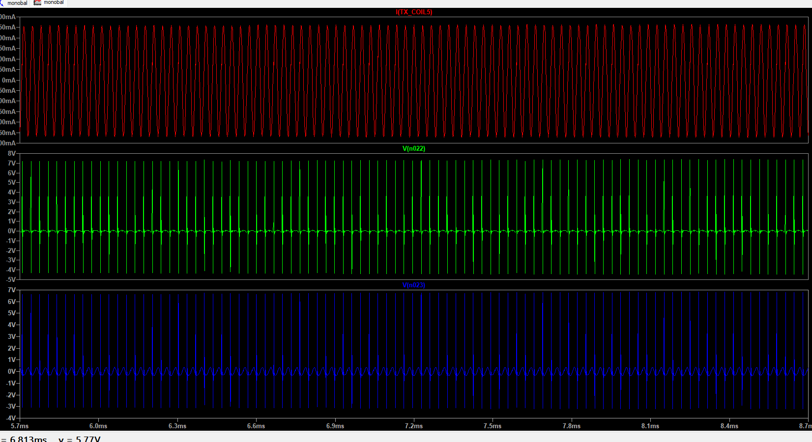

                          • #58
                            Since I have been doing alot of work around TX drivers lately .. I thought I would take Deemons "variant 1" and see how it would do on the modified E type driver.
                            Seems to be OK .... below is a pic of the sim results... ( I intend to try the real thing very soon ).
                            The TX develops a nice transmit current and the cancellation shows a no target and target response. There seems to be phase and target magnitude being detected by the balanced cancellation.
                            I dunno if deemon was thinking of wideband square waves or VLF .... but VLF might be a winner.
                            The spiking is coming from the switch transitions in the E class ... I could filter that .. this was just a quickie sim.
