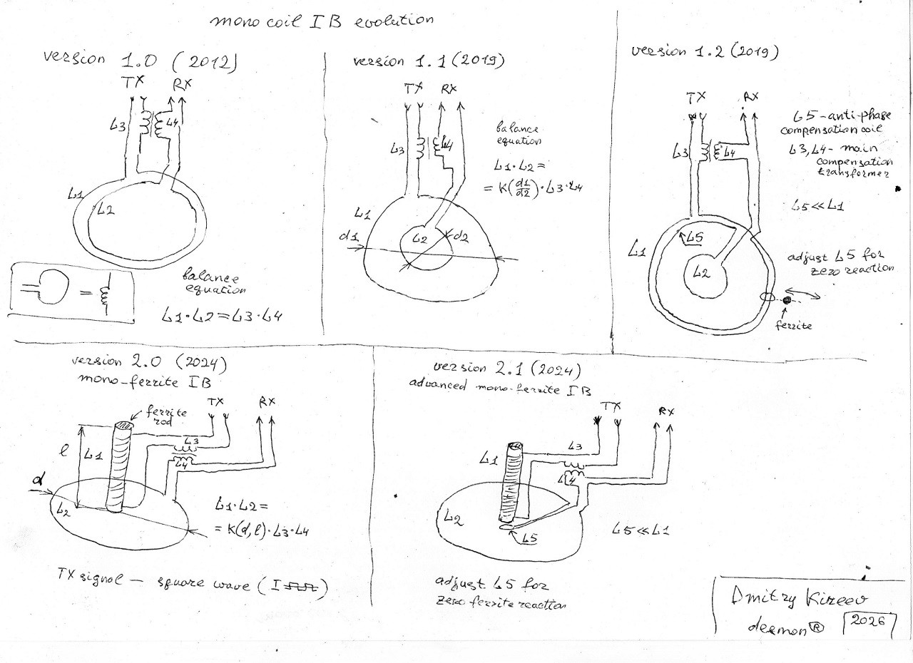

      Originally posted by deemon View Post
      Hi all !
Name:	mono-coil evolution.jpg
      Hi deemon,
      nice new proposals.
      As I have a second output channel on my sound card, I will compensate the high TX coil voltage with a transformed high voltage compensation signal. So I need a good signal transformer.
      Mixing (adding) them together to 0 V (simulating IB condition) will lead to an inherent voltage divider however. So there will be some loss of target response. As I have a High-Q TX resonant circuit, the high impedance of the mixed output may not be loaded further (input impedance of the ADC input) and there will be an high impedance buffer/amplifier (j-fet input).
      The signal transformer is quite critical. It depends on core losses, frequency response, maximum voltage transformation factor, etc.
      I have up to 6 V on the second channel to transform it to 30 - 60 V or more. I hope, the core and other losses won't lead to heavy temperature drifts.
      I have to try it out. It all depends on the quality of the signal transformer.
      Cheers,
      Aziz
