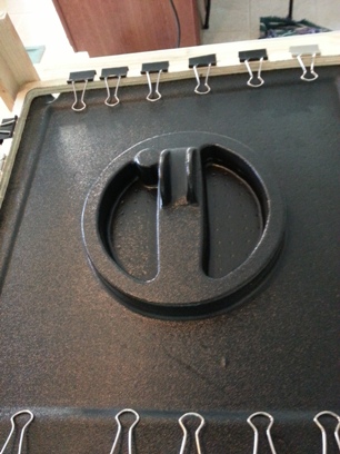

          I need to take the next step in vacuum forming. Two stage! I have been contemplating this for some time now. While I can make endless variations of shells, and sometimes some nearly flawless ones, my yield is not all that great due to poor temperature control and incomplete pull downs. My goal is to make these efficiently enough to be able to help supply these to other Geotech hobbyist (Sven keeps me busy sometimes). My general idea is not original, but I am looking for details on vacuum tanks. Particularly, tank and plumbing size as well as where to find a cheap vacuum pump.
          The general idea is to use a shop vac for the initial evacuation and to hold a 1/16" thick sheet of ABS to the platen and when it's still hot engage a second stage to make a complete draw. As it is, I always have a 1/4" or so near the bottom of my forms that never draws down tight to the platen. Any suggestions appreciated.
          Don

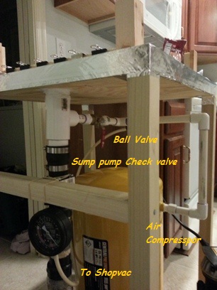

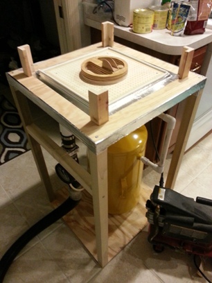

          Project successful! I finished my 2-Stage setup and made 11 coils yesterday for Sven (about 2 hours worth of work). The differences are dramatic over a single stage vacuum table.
          I never read the book but it was pretty easy to figure out, so I will share here what I did.
          I added a vacuum gauge (from Harbour Freight) just to get an idea of vacuum draw involved.
          Items I used:
          Vacuum table (posted elsewhere in this thread).
          1 1/2 and 1/2" Schedule 40 PVC.
          Three 90 degree elbows 1/2"
          Ball valve with 1/2" fittings.
          11 Gallon tank from Harbour Freight ($35.00). It can be connected to PVC with 1/2" NPT fittings.
          Sump Pump check valve.
          Craftsman 1.5 HP 2 Gallon air compressor.
          Length of 1/4" rubber tubing.
          One 1/4" tee with barbed fittings.
          Misc 2" wood for a frame.
          The general idea is to use a shopvac (through a check valve) to pull and hold a hot sheet of ABS. Then a ball valve can be opened to allow a hard draw from
          the 11 Gallon airtank which has been previously evacuated. The check valve will slam shut when the ball valve is opened preventing back flow from the shop vac.
          Interestingly enough, a plain old air compressor can be used to evacuate a tank simply by hooking to the input of the compressor via a 1/4" barb fitting.
          My air compressor can draw a tank down to about 26" Hg in 2 minutes. In contrast, my shop vac can only pull 4" Hg!!!! Still, a shop vac can be used
          for a lot of forming, provided that the ABS sheets have been heated sufficiently, but the Vacuum tank really draws the plastic into every little corner.
          Don..

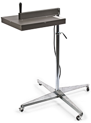

                  The oven problem gave me an idea. I used to do t-shirt screen printing in the 90's, small quantity orders. Because I did not need a full blown drying oven. I used a Flash Dryer. Cured the ink in about 30 seconds. Take a look at the flash dryer. You may even find a used one at a screen print shop. Might be adaptable for vac forming and other applications.
                  http://www.flashdryer.net/heat_element_comparison.htm
