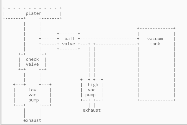

I need to take the next step in vacuum forming. Two stage! I have been contemplating this for some time now. While I can make endless variations of shells, and sometimes some nearly flawless ones, my yield is not all that great due to poor temperature control and incomplete pull downs. My goal is to make these efficiently enough to be able to help supply these to other Geotech hobbyist (Sven keeps me busy sometimes). My general idea is not original, but I am looking for details on vacuum tanks. Particularly, tank and plumbing size as well as where to find a cheap vacuum pump.
The general idea is to use a shop vac for the initial evacuation and to hold a 1/16" thick sheet of ABS to the platen and when it's still hot engage a second stage to make a complete draw. As it is, I always have a 1/4" or so near the bottom of my forms that never draws down tight to the platen. Any suggestions appreciated.

Don,
Years ago I was going to build a vac table for forming radio control boats. Got as far as getting a $1000 vac pump from an air conditioning service man when living in Georgia, cheap $60.00.
his boss bought him a brand new one.......Ended up selling it along with other nifty tools before moving.
You might want to take a look at the vac pumps at Harbor Freight http://www.harborfreight.com/catalog...?q=vacuum+pump
They may even have a retail store near you.
