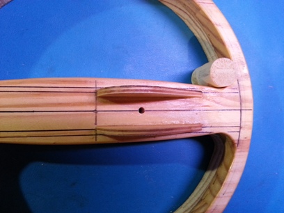

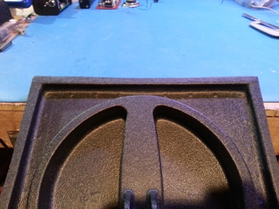

                  Here are a few tricks that I have learned and hopefully this will help keep builders from unnecessarily wasting material.

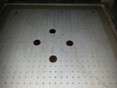

                  1. Drill an air hole in the center of your pattern - It will help the vacuum to draw air out of some of those tough places!
                  2. Place your pattern on a group of coins. It helps the system remove air quickly.
                  3. Removing your pattern - Do not try to pry the pattern out of plasitic. Just tap the edges of the plastic on a table top and the pattern will work itself free and drop out.

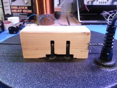

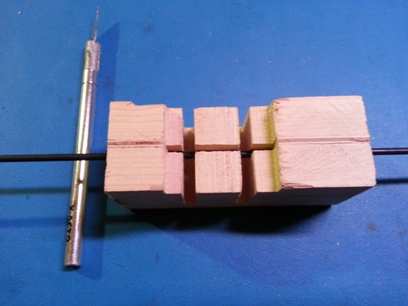

                  4. Build a simple jig for aligning a pilot hole for drilling the ears on your completed coil. Nothing is more annoying than a crooked hole.. and that is what I get without a jig .
                  The jig is just a block of wood with cuts made on a table top saw against a rip fence. Note: It is virtually impossible to drill a long, straight hole through the block of wood. It
                  is far better to cut a groove to assist in drilling a long hole. Then fill the cut with epoxy or glue in thin strips of plywood.
                  Hopefully someone can learn from my mistakes!!

                        Another trick I use is to varnish the pattern several times, giving a light sanding in between coats so the final finish is very smooth. I apply liberal coat of wax just before vacuum forming. It pretty much falls out of the shell.
                        I like the tip on the penny spacers will try that next time.
