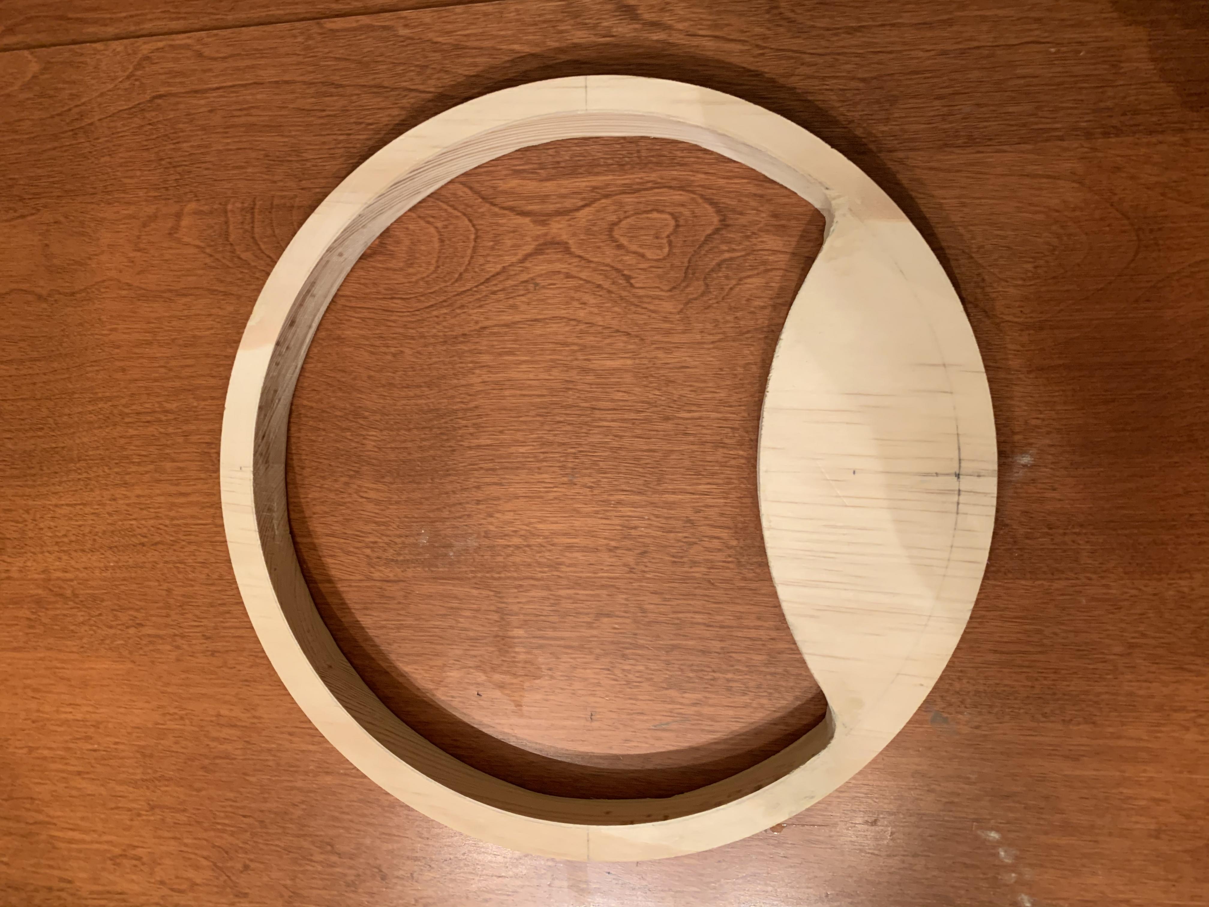

VACCUMM FORMING COIL HOUSING

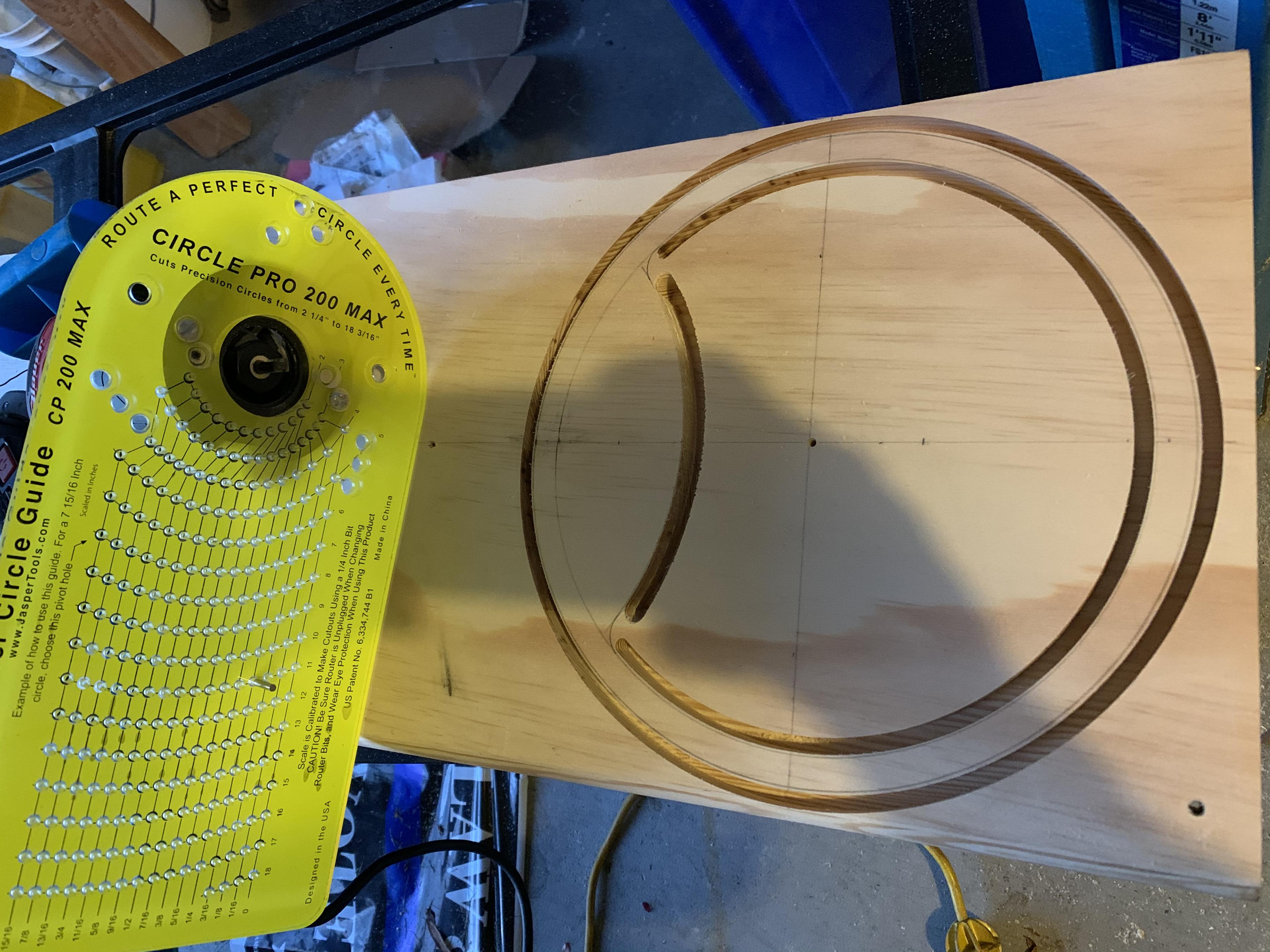

    For anyone who makes your own forms, I found a really accurate way to cut. Available here in the U.S. at Woodcrafters is this circle cutting tool.

      That looks like a handy tool.

            Hi dfbowers, your efforts over time have truly ispired me. Now, after drilling holes, which by the way wasn't as difficult as it looked, I now have my vacuum forming jig ready to go. I'm thinking of making concrete molds, although I haven't figured out the process just yet, but I will.
