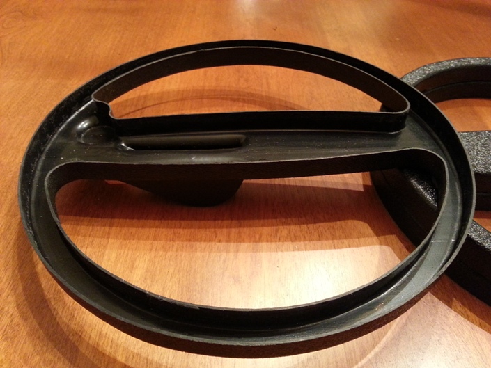

    is the mounting bracket on the coil housing vaccumm formed as one moulding or is the mounting moulded separately then glued on.
    First, I haven't vacuum formed a housing yet. I do use ABS to build sluices and classifiers for gold prospecting. This requires heat forming, cutting and solvent welding.
    Almost all the pictures and videos I've seen show molded and then filled with epoxy.
    As soon as I make a detector that suits my particular needs, I'll make a housing to fit. However, I will just heat and form the mounting ears to match the shaft and solvent weld it in place. Here in Alaska, ABS sheets aren't cheap. Cut-offs can be had much cheaper. Thicker pieces of salvage ABS can be heated and flattened. Another easy option is solvent welding thinner stock in layers to get the thickness you need.
    ABS pipe glue works, but is expensive. I use MEK and add scraps of ABS to thicken it up. Works real well as ABS putty when I make a screw-up in measuring and cutting.
    For heat forming, I've use a heat gun and my kitchen stove for small sections. For a bit larger, I use my toaster-oven and for even larger pieces that I'm just bending, I use an electric space heater.
    For bending I have used my 30" sheet metal brake, but wood boards and hinges work just fine.
    Hope this helps a bit.
    Oh, somewhere on this site, I saw a posting on using a press rather than vacuum for forming coil housings.
    er
      You can form the ears into the coil but it's tricky as everything is so time and temperature sensitive. If you are only going to make one coil it might make more sense to glue the ears onto your coil. Also if you don't have a great vacuum source you have to coax the plastic into the center section with a tool. I posted a video a few months back on the forum on how I do it. Look under the section of tools and techniques for a thread on building a vacuum table.

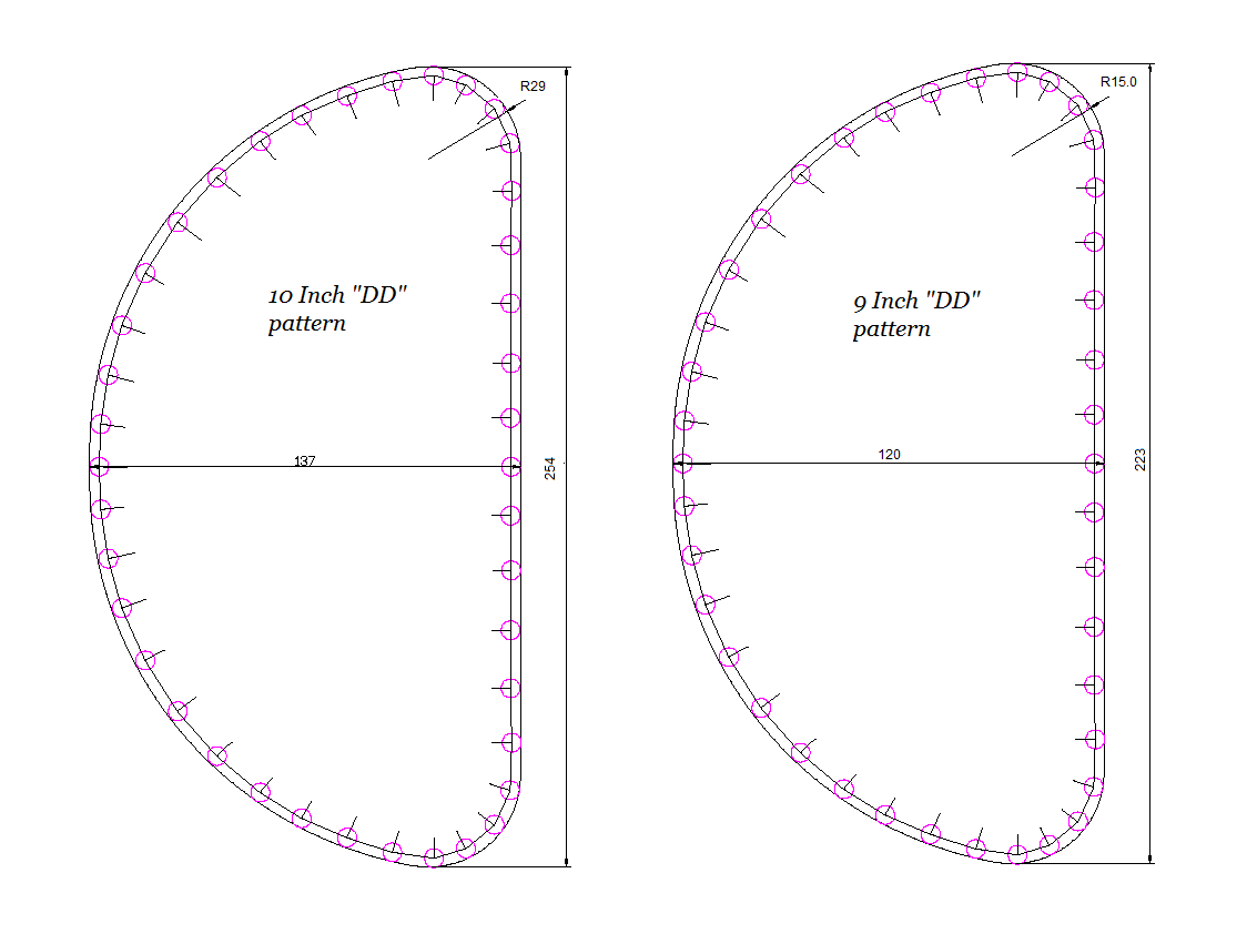

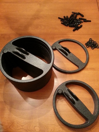

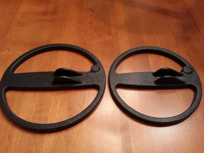

          Hot off the vacuum table.. I'm offering coil shells for any builders who may need one for finishing their DIY projects:
          I have a dozen or so 10" shells that I can ship immediately plus a few 9" shells. The 10" coils shells are made for Ivconics TGSL coil pattern, just drop your coils in!
          I have a few other shapes available as well but may need a week lead time to form. I'm targeting the lower 48 states as shells seem to be easy to obtain overseas.
