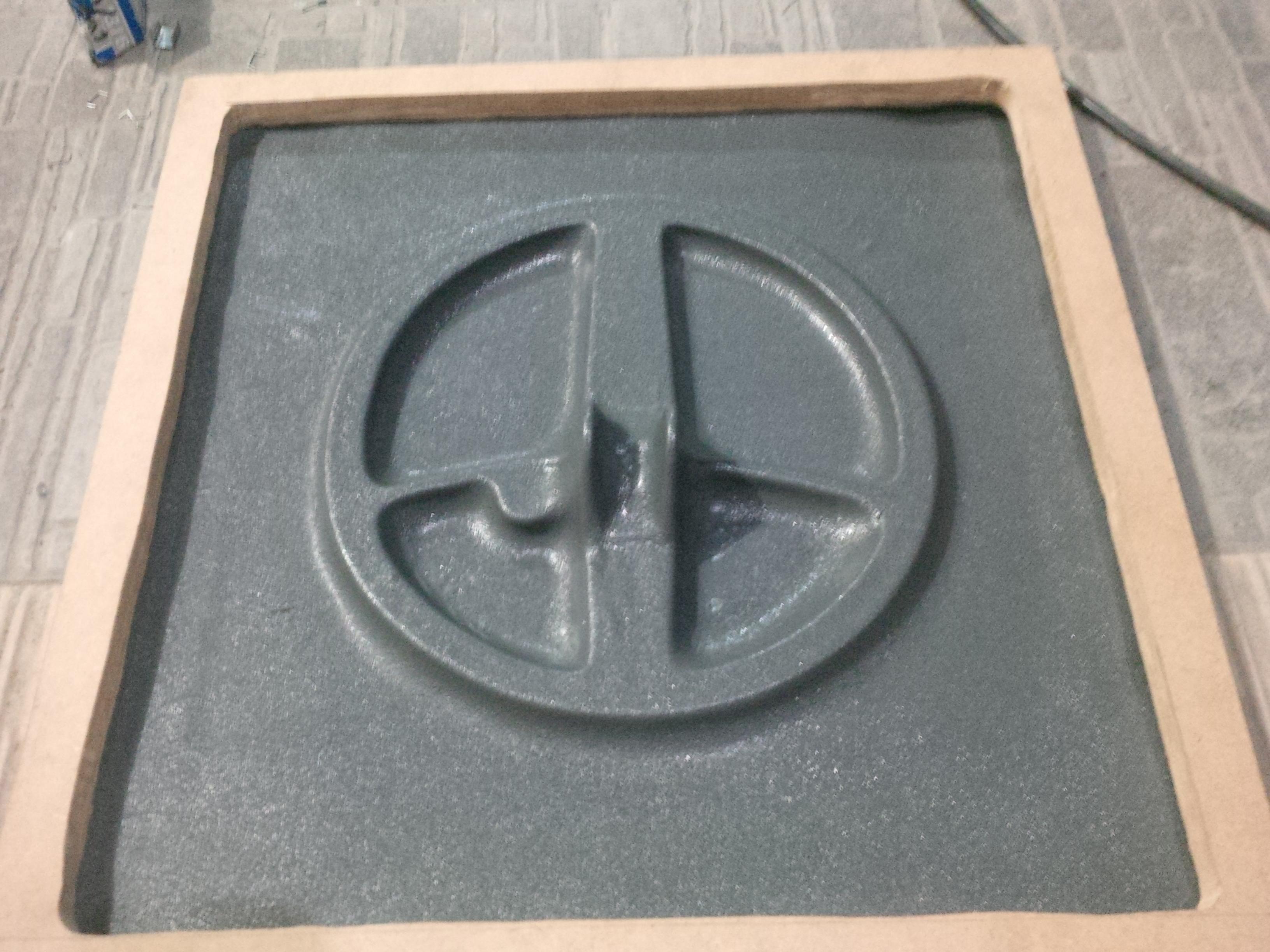

    Hello Don, how thick ABS sheet?
    i made ABS sheet 1,3mm , not perfect at bottom

      I have been using 1/16" thick ABS from US plastics. It's fine for filled shells.. a little light for larger clam shells.
      Don

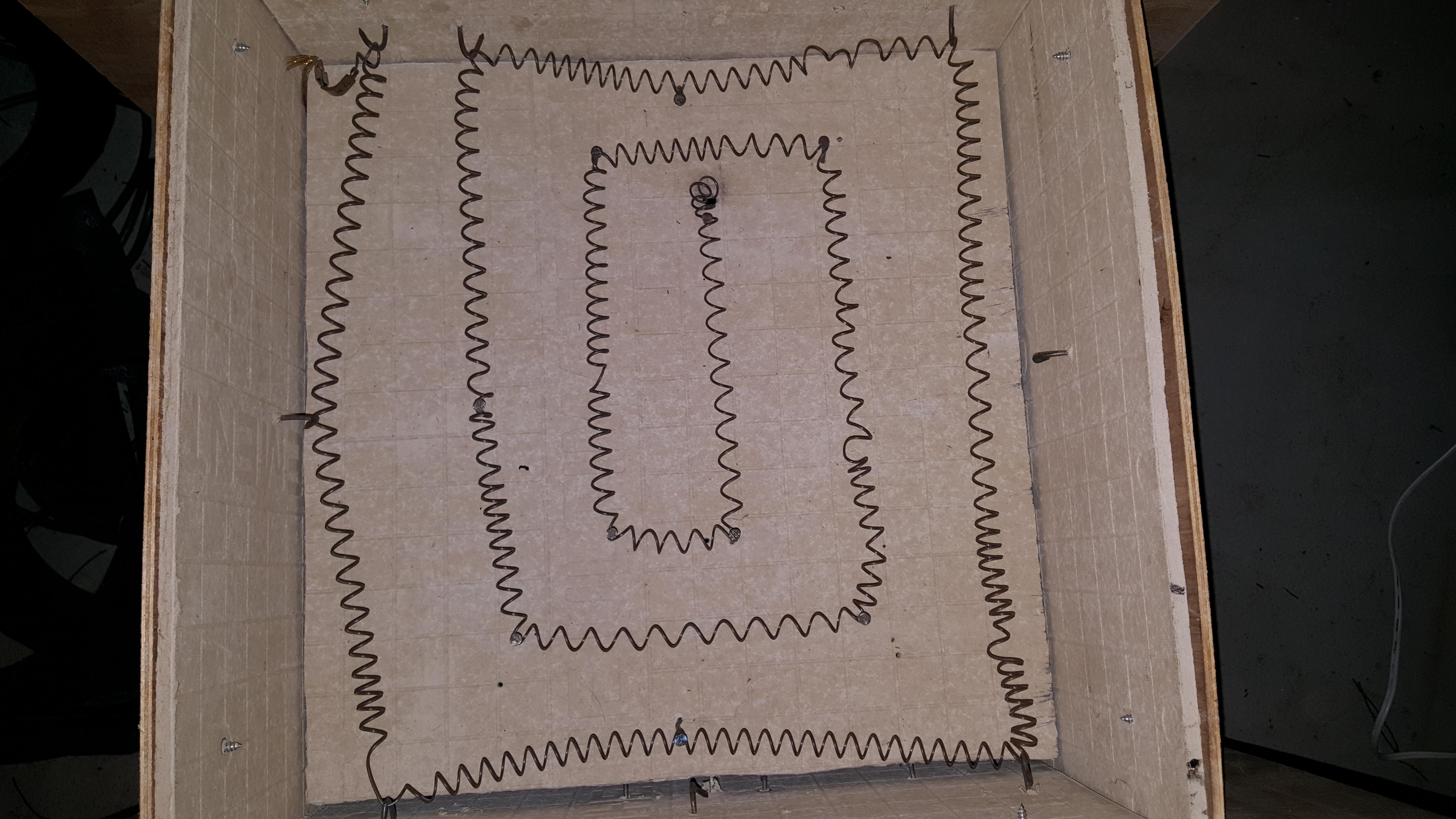

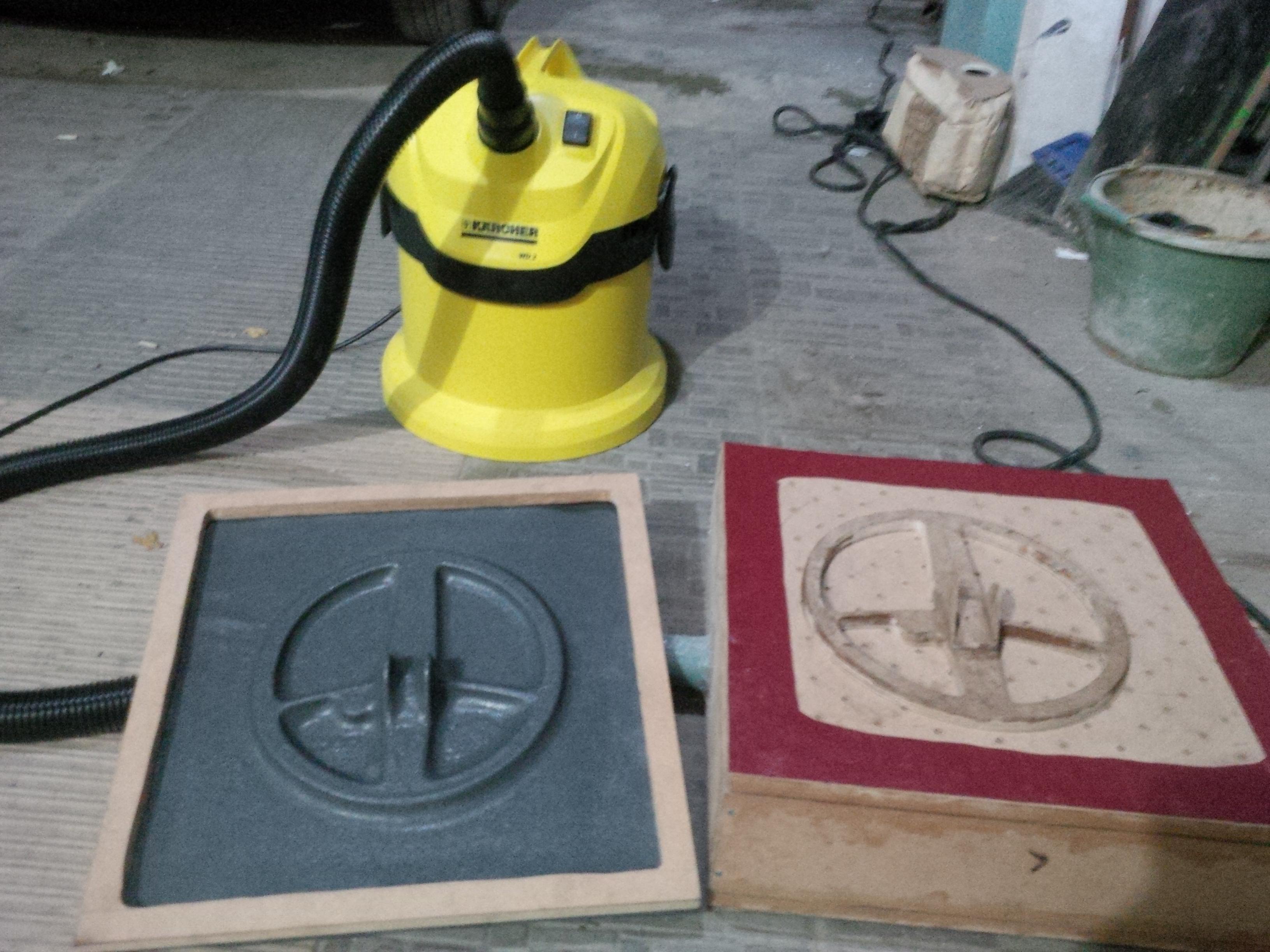

        Not bad.. you are getting there. I went with a thicker form and eventually a two stage, vacuum cleaner for initial pull down and vacuum pump (air compressor intake) / vacuum tank and it made all the difference. I recently built an oven from an old 1500W heater and got the stinky plastic out of the wifes kitchen too.
        Don.
          Thank for reply don, i see at your youtube, a yellow tank, it is vacuum tank? Do you use one way valve (Ball valve)
            Yes, it's just a spare air tank. See attached.
            Don.

                    I picked up a portable electric heater at a flea market for $5.00 and just repurposed the heating elements. I'm sure that I could come up with a link to a source for the elements. I also cut some corners on material. I lined a box with concrete backer board, which is not the right thing to do at all but I have not had any sort of problem yet. The walls of the oven get to around 250 degrees F but should be good for around 600. Ideally, a refractory material should be used. Anyway, my oven is 16" x 16" x 6" deep. It also has no thermostat so I need to manually monitor the temp which as not been a problem so far. I should be looking for a set of plans!!
                    Don..

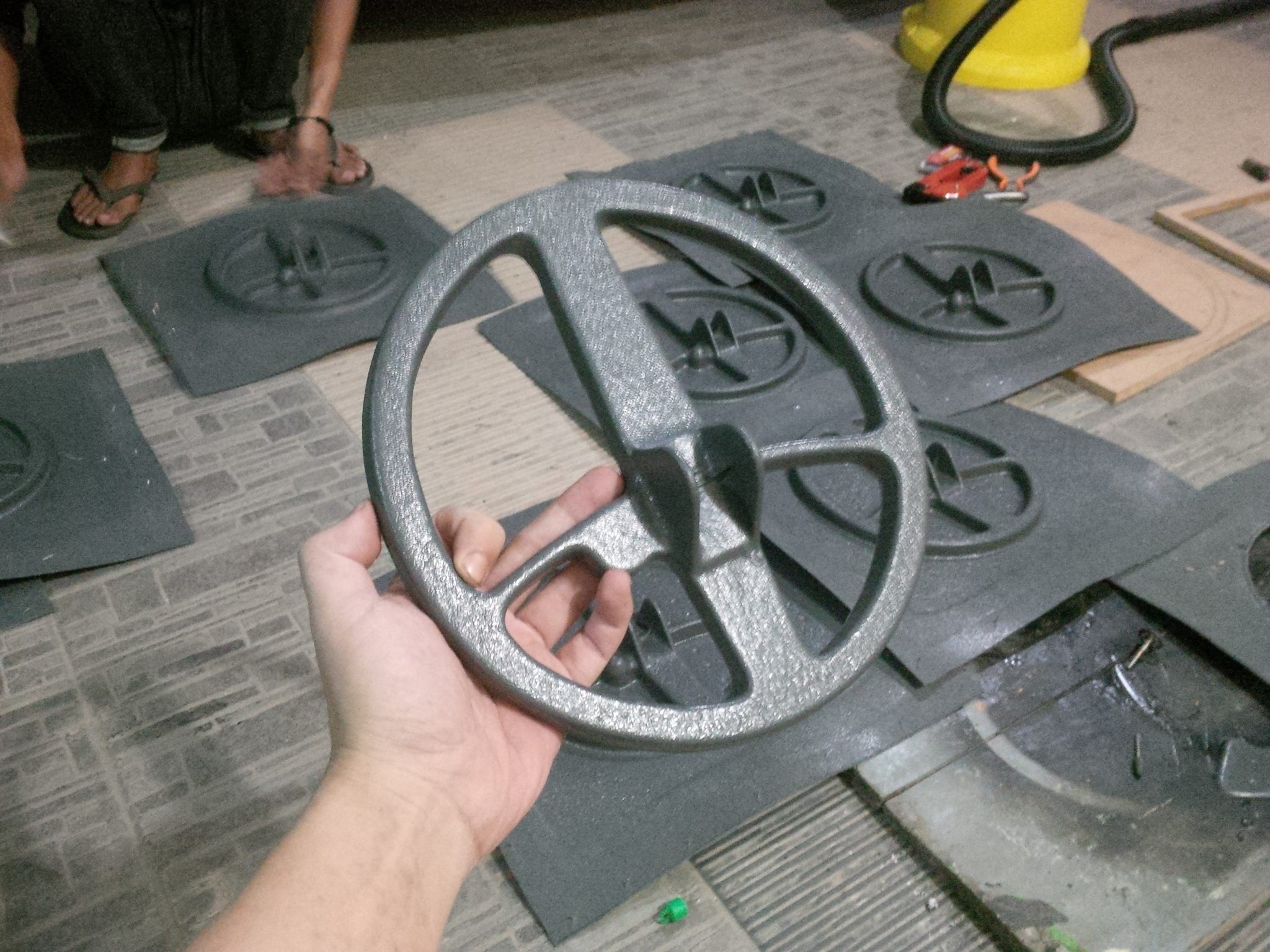

                          Hello Don,
                          i follow instruction your video, 2 minute at oven, this result
                          thank Don for your video.
                          Wahyu
                            Wahyu. Very nice! You are on a roll.

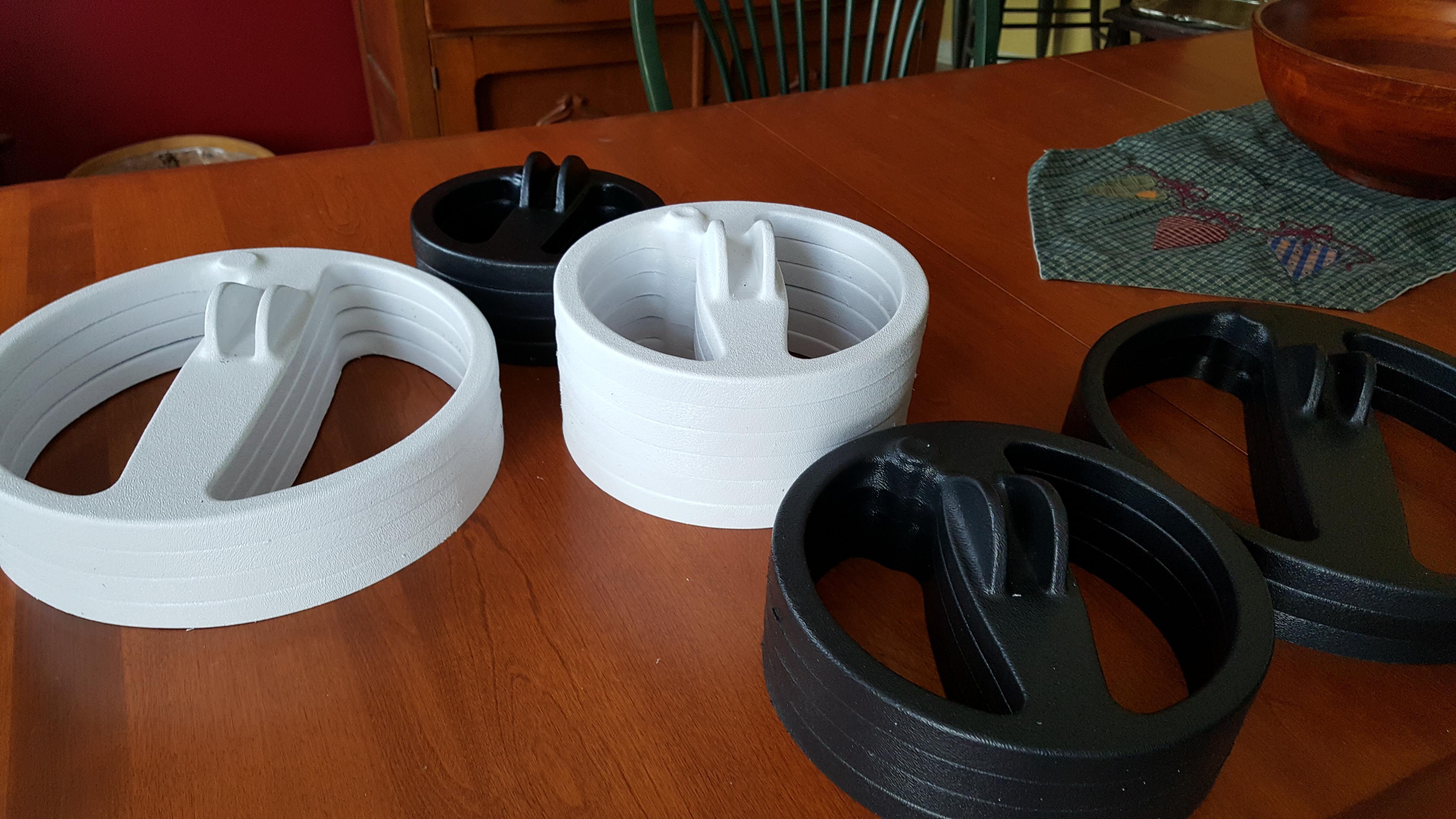

                            What type of potting compound do you plan on using?
                            Don..
                              PU Spray first, and resin fiber at top PU
                              Wahyu
