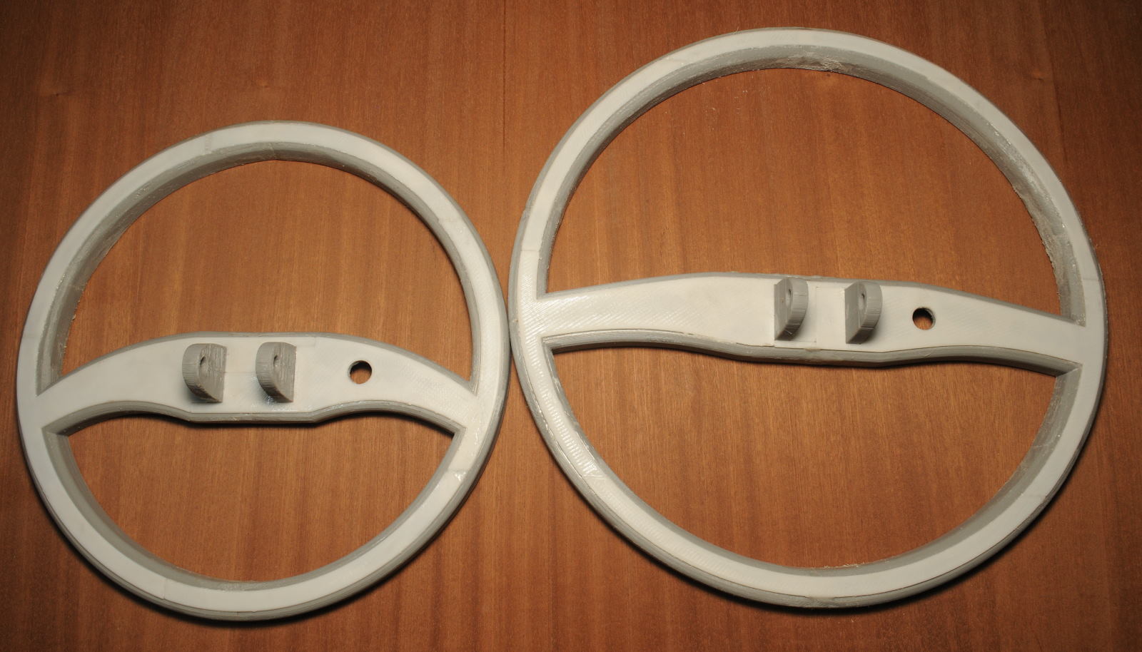

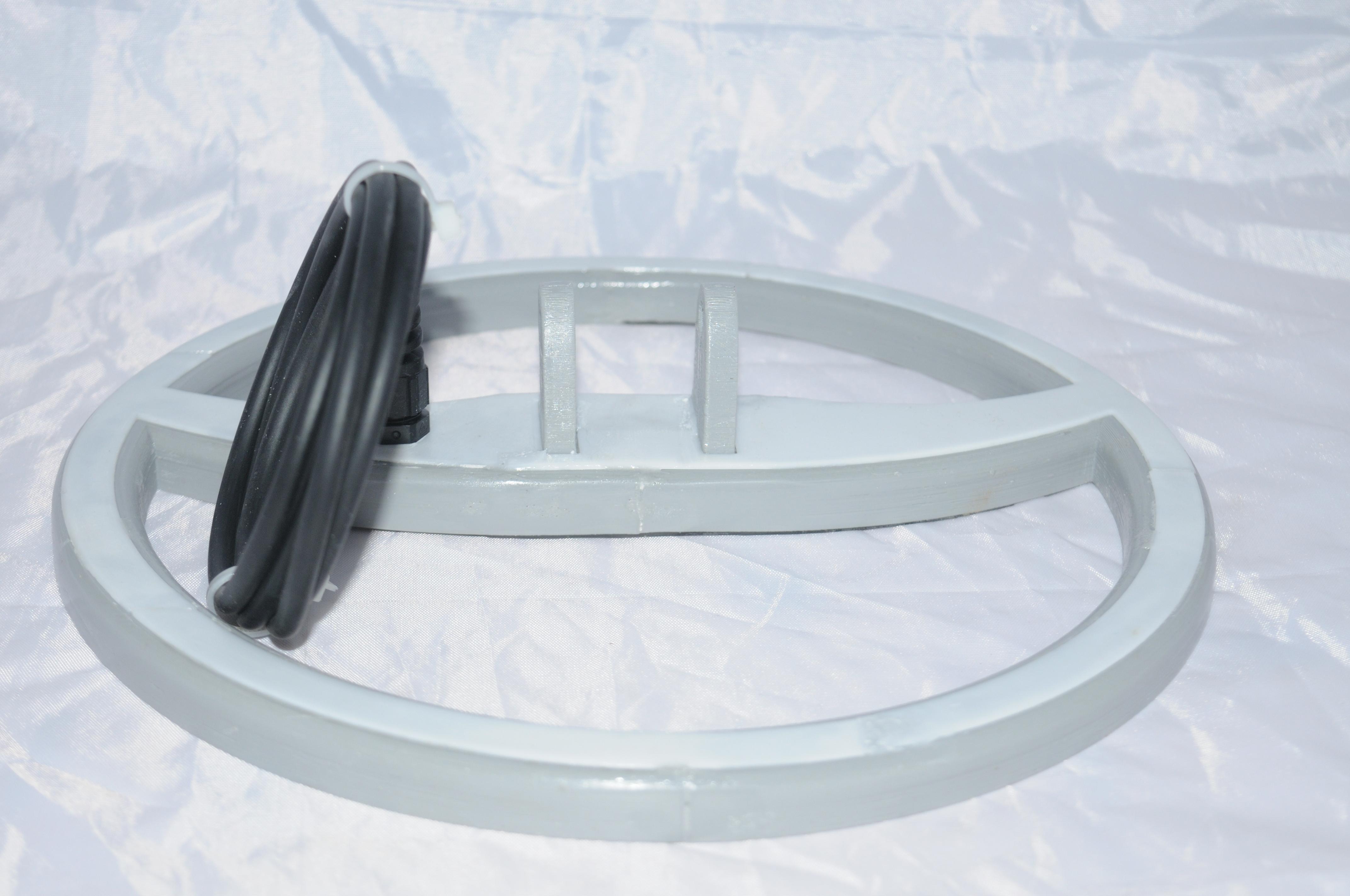

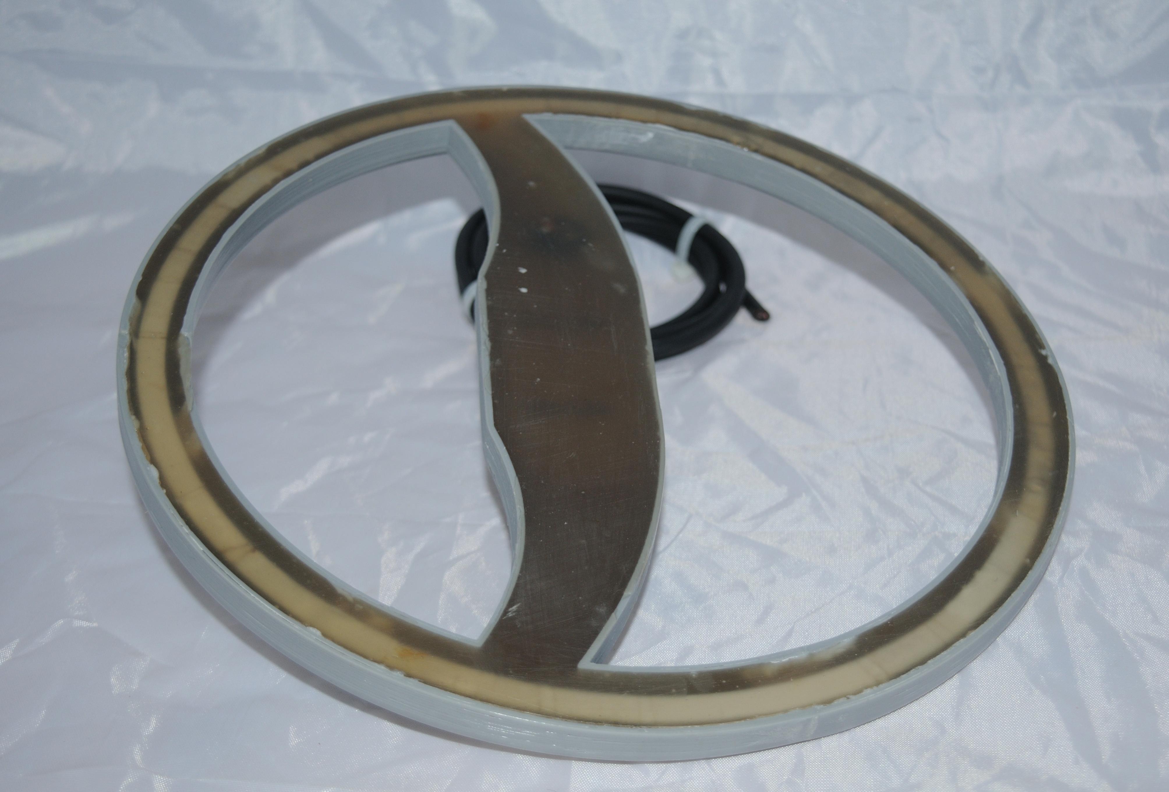

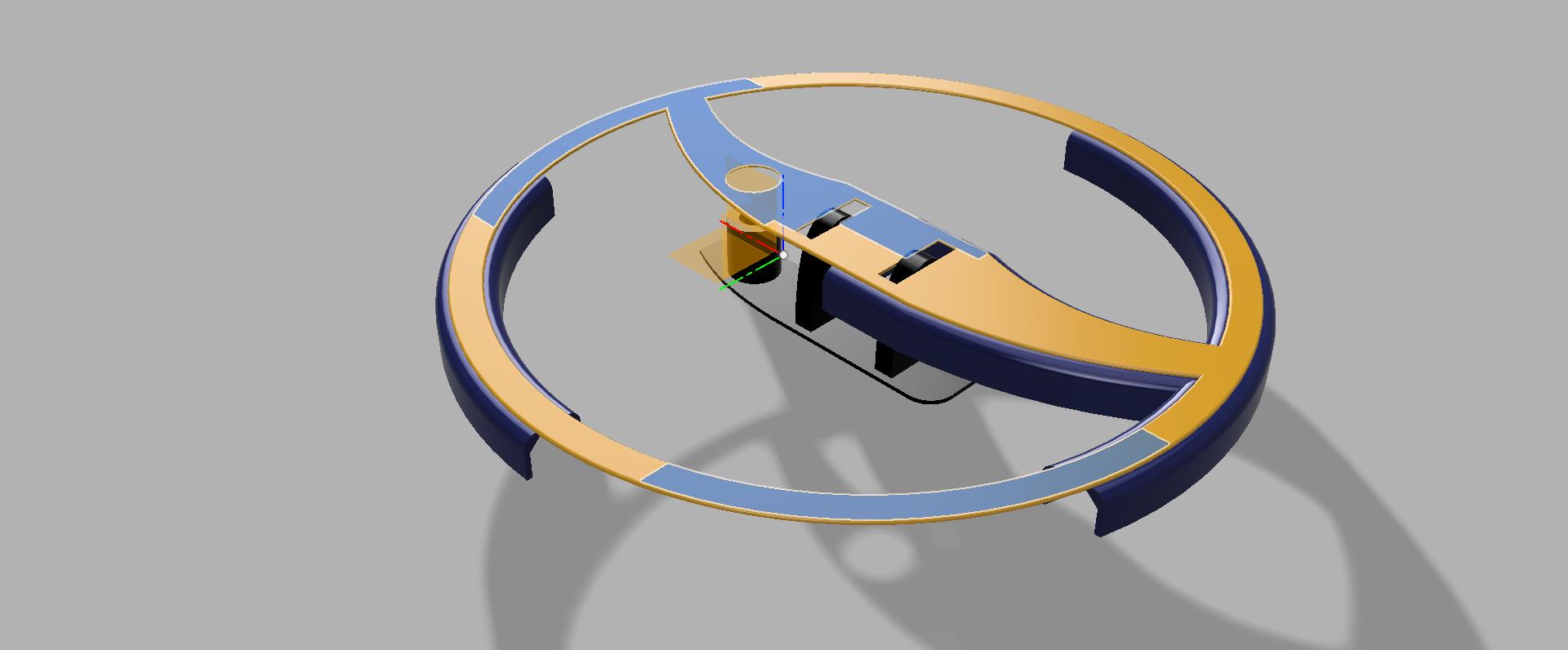

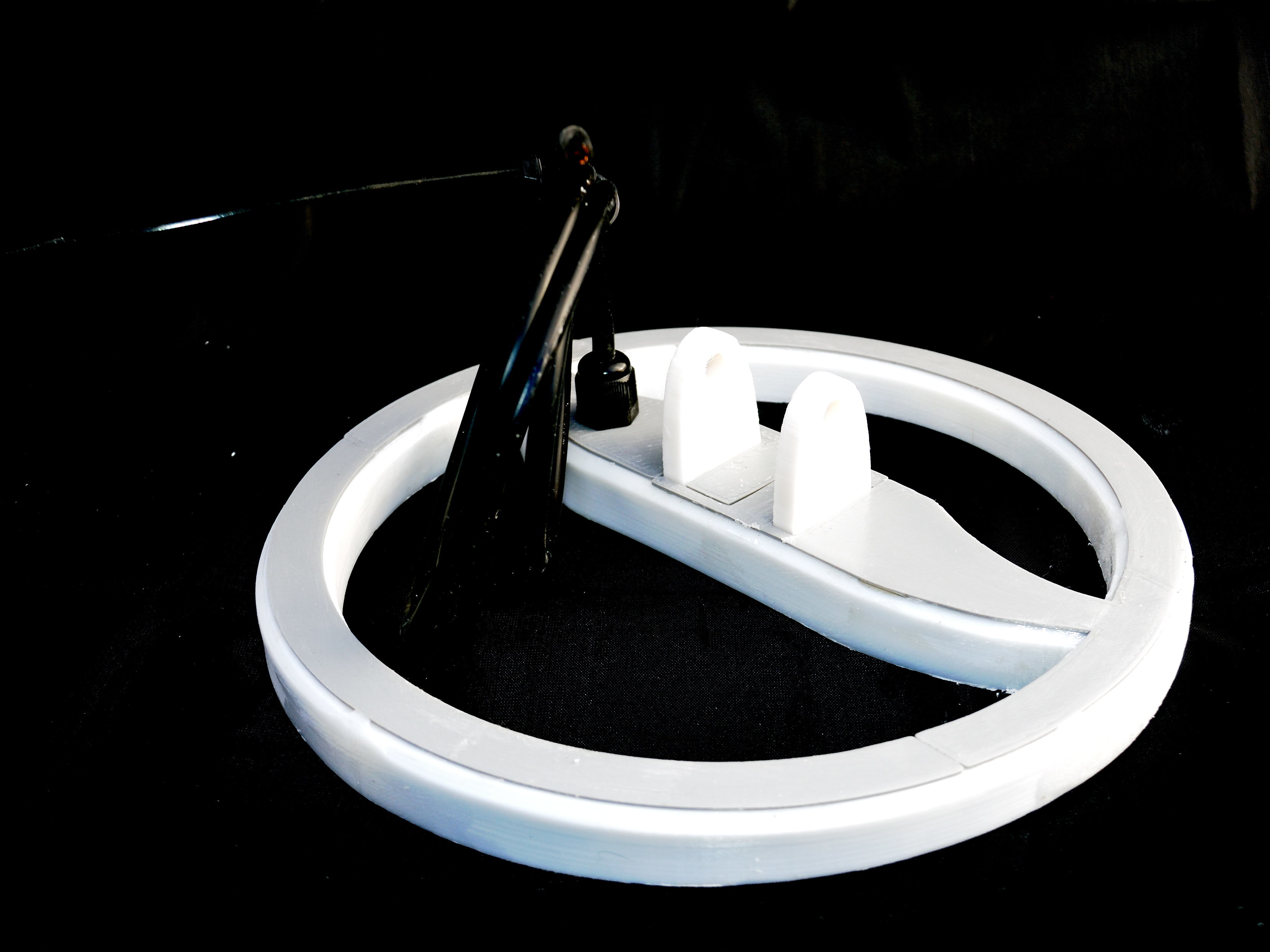

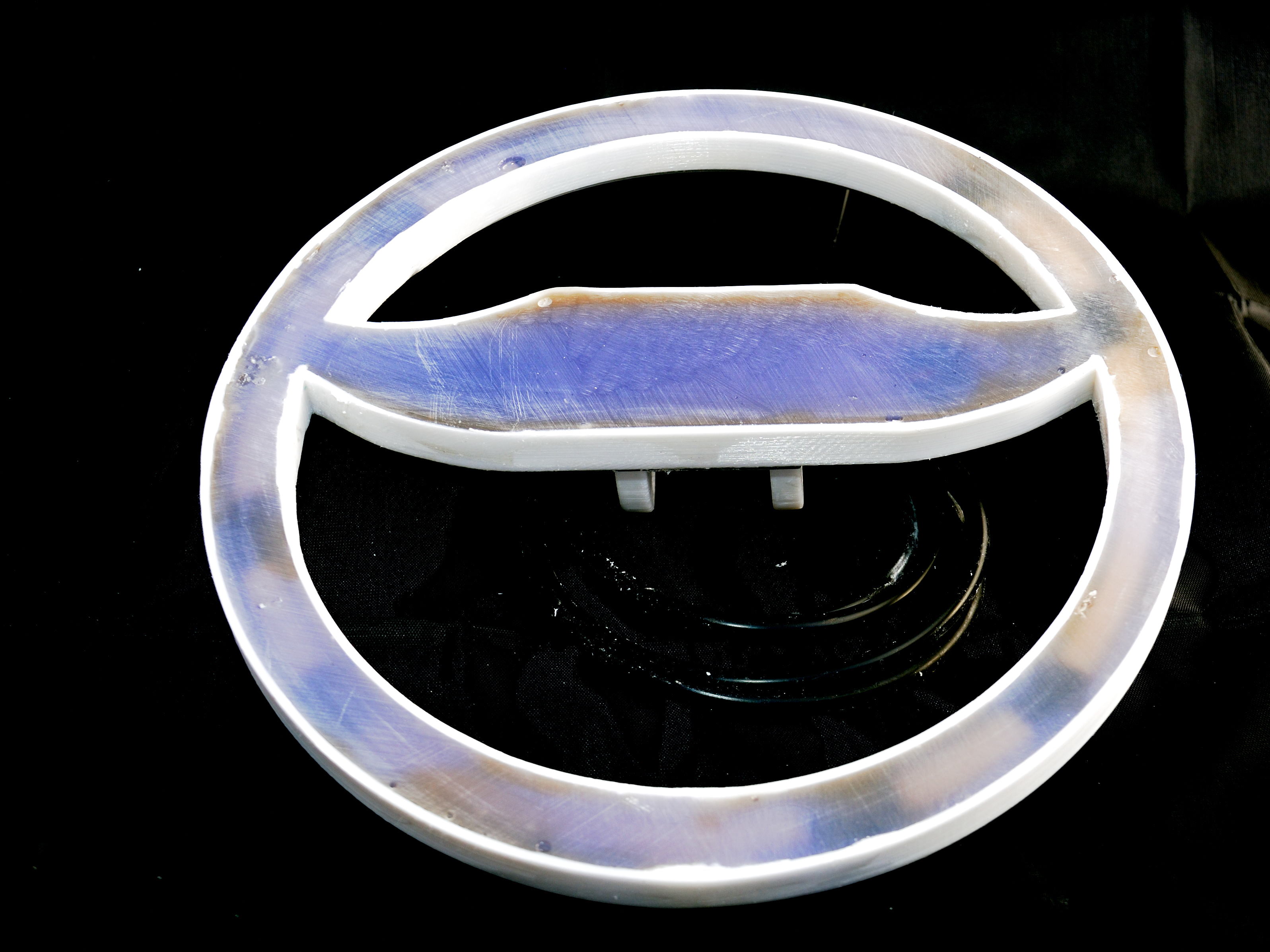

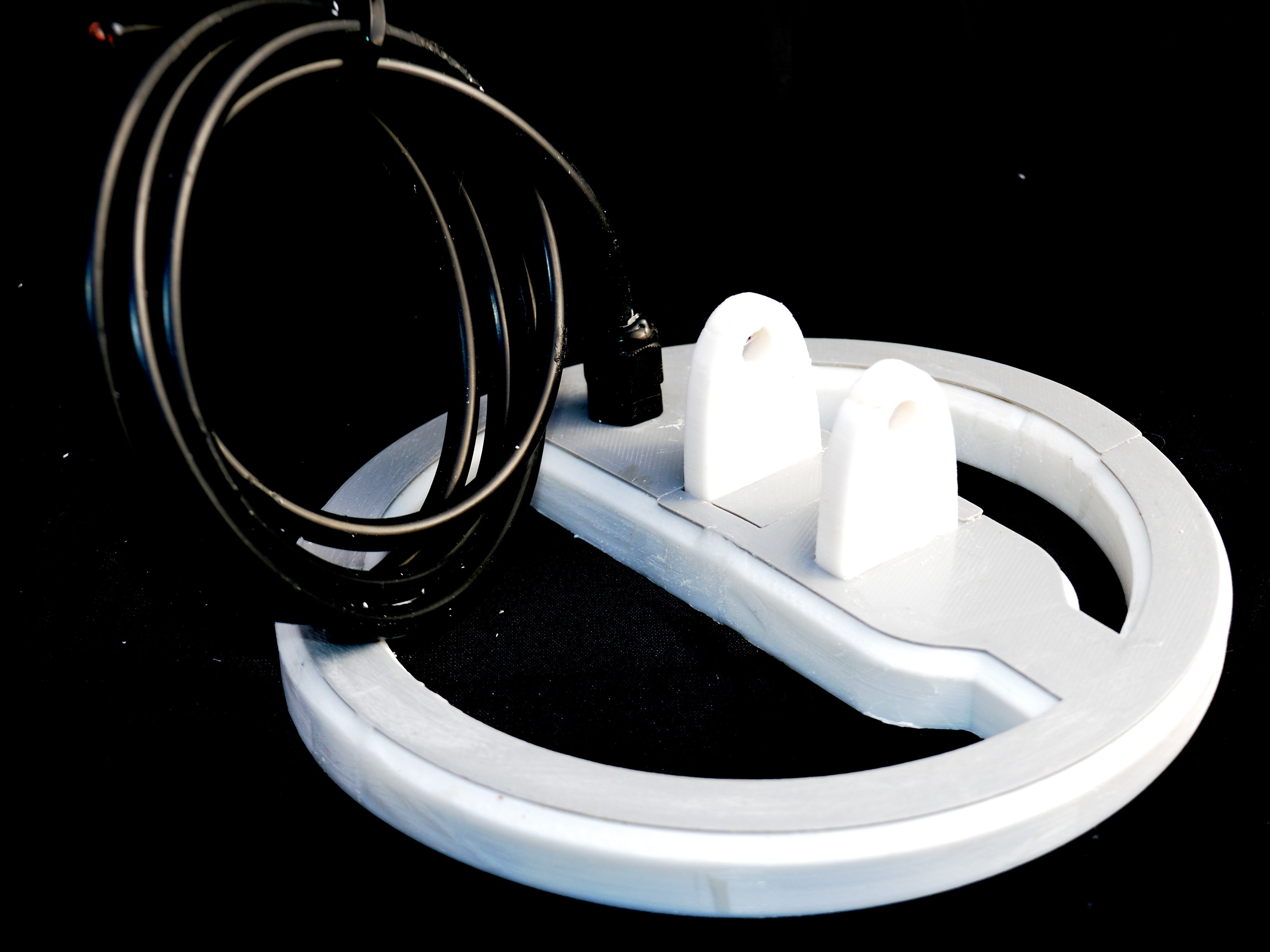

    Give me a few days to get all the files together, and ill upload STL files for a 6 8 10 and 12 inch coil that most can print on a 200x200 build plate, You ll need to print in abs so you can put all the parts together with acetone and sand it down and wipe with acetone to make it look good, they art only for mono loops though. here a few sample photos of the coils nearly or in some cases finished.

ID:	359043 6 inch coil almost finished in that photo

ID:	359045 8 inch almost finished in those photos

ID:	359047 10 inch

ID:	359048 a ten inch and a 12 inch that i had started to put together.

ID:	359049 how they get assembled more or less
