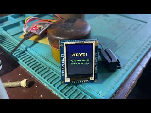

        • #94
          Here is one of the recent examples of implementing 2 filters simultaneously on "slow" data (Moving Average and One Euro Filter).
          The ESP32S didn't even break a sweat.
          RTC, both cores are in the game.
          Although... that story about ESP32S and multiple cores, RTC... is not quite as idyllic as advertised in the descriptions.
          But that's another story, for another topic.
          Back to the video; note the exceptional stability as well as responsiveness.
          The wider context that is not seen in the video is that the FLC type sensor is surrounded by unseen interference and a bunch of noise.
          FLC works in the 5v range, before introducing the voltage to the ESP32 ADC I put a simple resistor level shifter.
          This is an example with an internal ESP ADC. In the coming period I will try the same with added WM ADC.

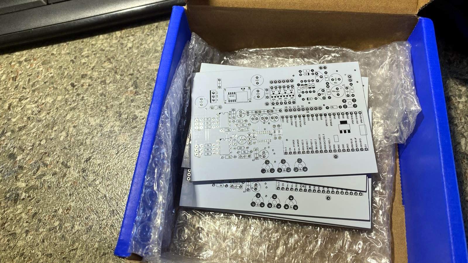

          • #95
            Pcbs just arrived:
