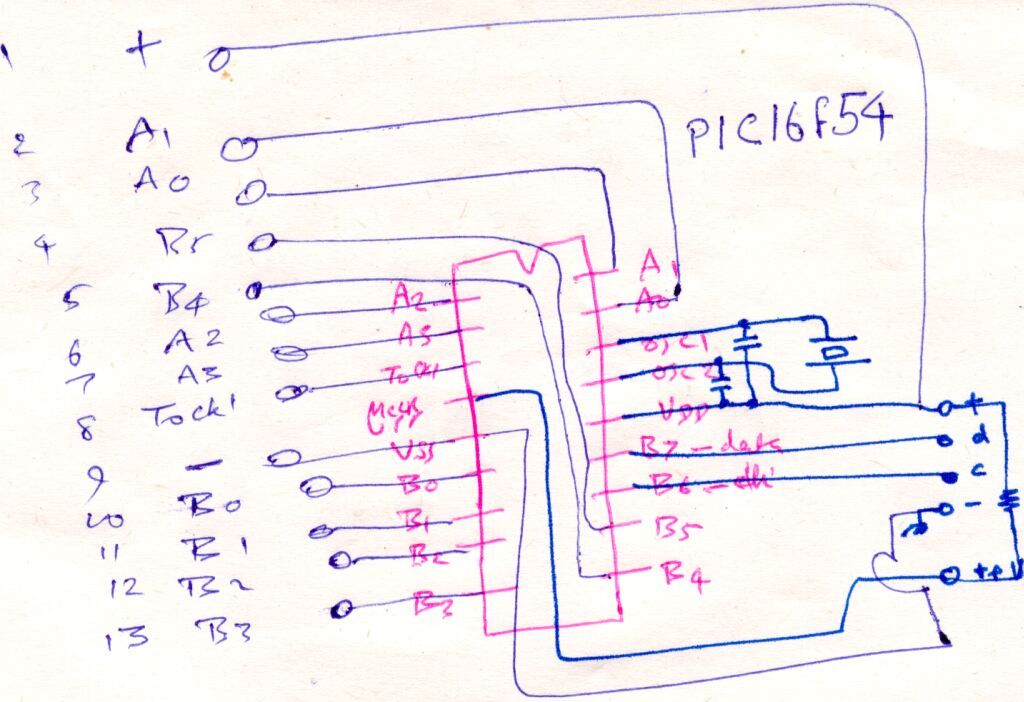

                The Saltwater Etch Process: This is a one-off process to produce one printed circuit board by removing unwanted copper by electrolysis in a saltwater solution.I shall illustrate the process by etching and building a board for 18-pin PIC (for the PC16F54, but any 18 pin PIC wil…
                Here is a pic of my board.
                  Details
                  I forgot to mention board preparation is key. For the Above board I first sanded the surface lightly with 150 grit paper, then cleaned it with alcohol (really nasty vodka), then I transfered the toner to it.
