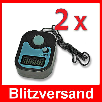

                  Great coilwinder, I will be copying it a bit to make my coils.
                  I also saw the other video with the mechanical counter, not bad, but I am going to use a LCD digital counter that I bought for aprox $5 from ebay.....or make an old calculator count from a magnet and a reed switch by watching Youtube....
                  Check the picture.
                  Andy

                    Hope the mechanical counter provided some amusement!
                    IMO, you want a counter that decrements if you need to unwind some turns (which happens). I'd like to see a neat way to do that (besides pencils, cardboard, and glue).
                    That digital counter looks like it should provide success.
                    -SB

                          Using Digital Counters on coilwinder
                          My LCD counter, will only count up when the coil is either wound or unwound. That may appear as being a negative aspect, but that is a misnomer....
                          Firstly, once its wound, its usually far better to watch the impedance of the coil using an impedance (mH) meter for a proper & fine adjustment, rather than counting turns. The impedance usually being the most important value, not the number of turns, in my limited experience.
                          But if you do need a specific number of turns, you should have been watching more carefully when winding them on in the first place!
                          But even that's not a problem, just decide on the final number of turns to remove, note carefully the value on the counter (just in case!), reset the counter to zero, turn the coil-winder backwards for the number of turns needed to be removed - problem solved.
                          But for those who find that too difficult , there are LCD counters that have both a count up and a count down button......not expensive, cost a little bit more, but still REALLY cheap. Also the calculator "counters" can easily be set to count up or down when the "=" is pressed.)
                          Although the "pencil" counter you made is a lot of fun, there is no guarantee that the number of turns indicated is in the end, exactly correct, as it could easily jump a count (no detents in place), making the count possibly unreliable. A jump of 10 is easily possible = disaster!!!
                          Though I did find it very, very interesting....and I thank you most kindly for making it and drawing it to our attention here with such a well made video..... (I am green with envy with regard to your video quality!!)
                          Once I have my coil-winder finished, (and assuming it works correctly!) I will post a video or pictures!!
                          Andy
