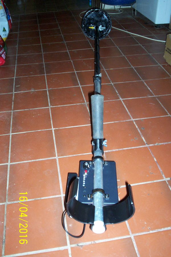

detector stem
    that is really excellent work. well done!
      thanks
      grip is adjustable, only untighten the screw change position and fix it again
      screw can also be changed by a fast lock clamp
      but is not necessary if you find the right postion once
        Now tell us how to do that ourselves
          That looks great bernte_one.
          Do you think the plastic pipe would become more rigid if the round profile was flattened into an elliptical shape?
            Yes, please do. A nice pictorial guide would be good.
              hello gold finger
              there is no plastic it is made of carbon
              only the gip is plastic
                Where did you get the handle from please?

ID:	339553grip..Super light (the hole set up with coil wieghs around 650 grams

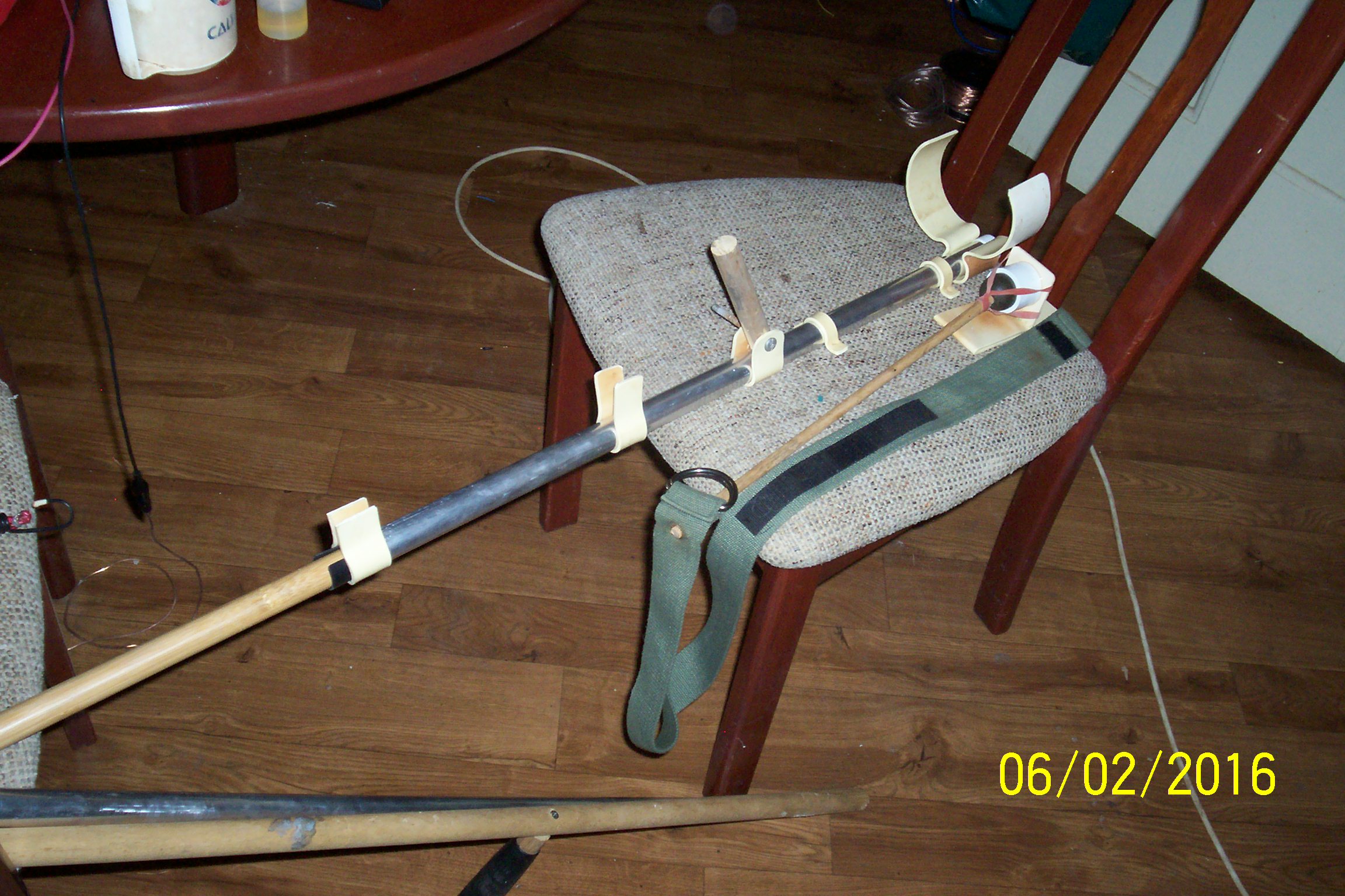

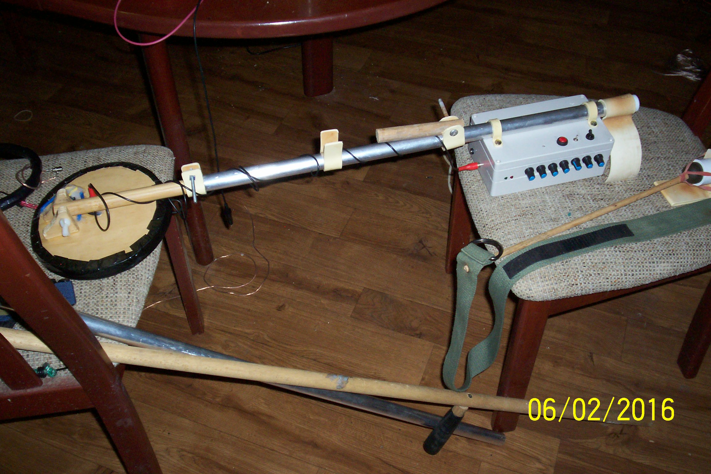

                              Here's my compactable design. 25mm aluminium tube@ $10/m (700mm), and a $5 bamboo composite broom handle. The brackets and armrest are cut from 2.5mm (?) walled, 100mm sewer pipe, which is heated and shaped with a rework gun. The handle is foldable and the armrest also folds down. A strip of thin rubber is glued in the lower half of the extension bracket to enable a good grip on the smaller lower shaft. Gutter bolts and wingnuts are used for extension bracket and handle. A self-tapping screw clamps the armrest-set right it still allows armrest to be twisted down for storage without adjustment,(not shown here-added later). I am using 3x18650 batteries, with an inbuilt charge controller(mounted alongside battery box), and a 1w solar panel mounted on a bicycle phone bracket. This bracket I will also make from pvc in the future.
