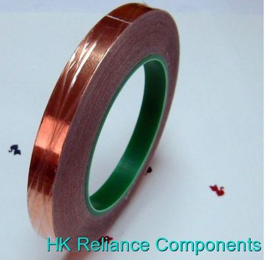

            I bought some of this copper shielding tape with conductive adhesive:
              I suspect the "conductive adhesive" is collective terminology for thin adhesive. To be truly conductive it would have to contain conductive particles and I don't think they do. I've messed with such tape for EMI reduction purposes. For example, take an ohm meter and connect one probe to the copper and another drag lightly across the adhesive side. I think it makes contact only when it is pushed aside and the probe hits the other copper side. No matter really though - for this a tape without adhesive would be fine...
                Actually, just touching the adhesive with the probe and touching the copper side makes connectivity. You do not have to push the probe in. If you tear two pcs of the tape and press them together then touch probes to each pc. copper or adhesive sides, connectivity is made.
                        http://cgi.ebay.ca/ws/eBayISAPI.dll?...m=260990793350
                        Gee, if this thing contains real copper - it is an instant coil by itself. It may be worth investigating
