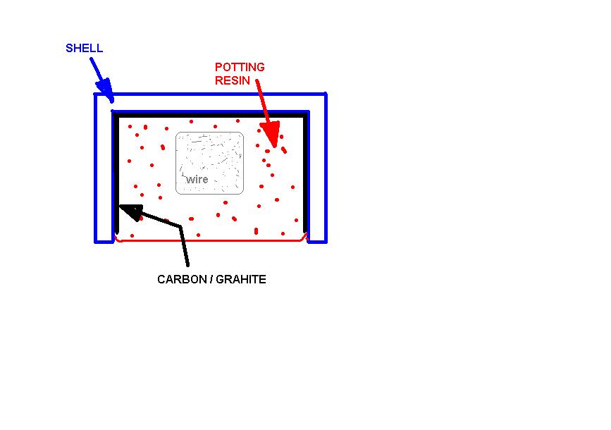

    Ive seen commercial mono's with a paper sheet top and bottom sprayed in nickel.
    With the graphited shell, the coil isnt wrapped in any conductive layers !
    The coil turns can 'SEE' the ground surface.. Like this.
    Is this what you see..
      I have graphited a shell on the inside.
      I see about 20kohm / sq on the surface. used a few fine wires held in with silver loaded paint (for car heated windows)
      If the shield is for static E field dissipation - it should be ok

        Part of the problem is most of the space blankets use a vapor deposited layer that is only a few hundred atoms thick. Not much of a surface and the reason the resistance is not low. The clean copper wire wrap should work OK as it will give a large surface contact.
