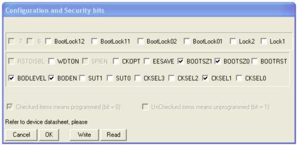

          According to what is stated on German website, fuses are 3D, F9 (hex) or in ponyprog configuration like this:
          • #50
            Thanks tepco, thats good news, using the online fuse calculator, I worked out the fuses should be L3D HD9, I have not tried that fuse configuration yet ,
            problem is when I put those fuse values into burn o mat it seems to select the wrong crystal frequency range, but will try 3D,D9 anyway.
            I have been looking around the german site with google translator where did you find the ponyprog picture ?
            thanks
            6666
            • #51
              I put ponyprog picture here, result is the same, freq. setting :
              Ext-Crystal / resonator medium Freq.Start time 16K CK +64 ms
              Add this to AVRDUDE:
              -U lfuse:w:0x3d:m -U hfuse:w:0xf9:m
              (that is 3D, F9 for low and high fuse)
