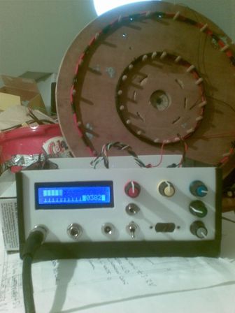

    I burn Atmega8 chips for the CHANCE project
    I use a USBASP cheap programmer
    and extreme burner software

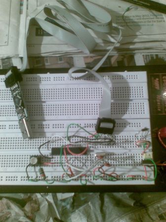

          I got a usbbasp on order, so together with the extreme burner should be problem solved.
          Thanks very much, will let you know results

            • #66
              Thanks Silverdog, better late than never
              Right, after all that hassel for £2.38 incl p/p you can read and write ATmegs8 and 48 know problem at all, and cant see any reason for problems within the ATmega family of other ics.
              To read a atmega8 chip takes 4 seconds flat, to flash the hex file takes 10 seconds flat.
              In both modes everything is varyfied incl keys.
              Follow silverdogs links, everythings there regarding program etc.
              The hardware driver im putting here because it doesnt come with the product and im not sure where I got it from, select X86 its does windows 7 and xp, proven by me.
              The chips that I played with had been used and abused, how they still function is your guess as good as mine, they must be more robust than first thought.
              Ive arased and reprogramed many times, even programed the chance project into them, then back to minipulse three version 1.10.
              I still cant put my finger on why these other programmers were such a pain in the butt, but they were, and spent many hours trying different combinations etc and following other peoples advise as well as my own ideas.
              Im going to donate a small sum of money to the lad who developed the xtream av programmer because its as it says powerful.
              If you want to make a standalone PCB for the ATmega just use the one I put here earlier with a 8mhz crystal, its easy and it works I can assure you, proven by me.
              You dont need any 5v regulated supply or reset button as its all fed via the usb, and the reset is done automatically when applicable by the extream program.
              I do recomend installing LED to the +5v leg of the ATmega as proof of supply, but not a must.
              Theres not much else to say apart from when opening extream all you need to do is select your IC, and make sure your on iscp mode,both are top of the page tabs, thats it dont mess with anything else because you dont need to, extream and your programmer does all the work for you.
              Dont know if there is any instuctions but I certainly didnt read any, just went stright into it like a bull at a gate and bingo job done.
              Anything you want to know feel free to ask.
              Like to say a big thankyou and many thanks to everyone who contributed to this thread because without your help it wouldnt have kept going, and we all kept pushing to get resolve and suceeded.

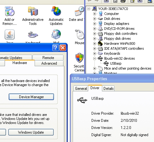

              • #67
                satdaveuk
                Congratulations, thanks for the driver pack, I installed the driver that windows xp sp3 choose for the usbsp board.
                Do you use XP ?
                when you look at
                Control panel
                System
                Hardware
                Device manager
                Libusb-win32 devices
                Usbasp
                Driver
                Do you get driver version 1.2.2.0
                thanks

                • #68
                  satdaveuk
                  Do you use XP ?
                  when you look at
                  Control panel
                  System
                  Hardware
                  Device manager
                  Usbasp
                  Driver
                  thanks
                  6666
                  The driver version I used in the pk was 1.240 the latest, which worked on my windows XP also 7
                  If you get any problems just go back into devise manager and click tab update driver software, then go into the pk and click on 1.240.
                  I cant comment on the older driver because never tryed it.

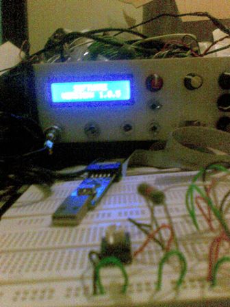

                    • #70
                      Hi 6666
                      The very same one that Silver dog posted on here.
                      That hex file thats on the Pulsedtektor site which I posted here has flaws in it, Firstly it doesnt set the low fuse to external crystal, but thats not a problem as its easy to do.
                      Secondly which conserns me is it fires up saying minipulse3 then version 1.05, then goes to saying starting metal detector, then thats it just stuck on saying starting metal detector, so need to work on that one.
                      Tryed other hex files which I obtained over a period of time and they work but not as the mnipulse 3 was intended.
                      On all hex files the range control and the pulse width pots dont seem to make any difference which all directly relate back to the ATmega8 chip.
                      The hex files programed by a chap called Sisco seem to work but no graphic images on LCD, maybe that was intended, its diffecult at times due to alots in german, so often trying to read between the lines.
                      The problem is all the threads on this project dryed up a couple of years ago infact at least that, we are talking last software update 2006, so seem to be working alone, theres things about this design that dont add up, just wish there were other constructers involved to discuss it with.
                      I cant possibly give up on this project due to time and money already spent, and the factor that I dont like to abandon a project just cause it doesnt work, In my opinion everything is workable.
                      The plus side to all these problems are its been one hell of a learning curve for me far as atmega chips and how they tick, considering I new bugger all about them a month ago, and also this is my very first ever pulse induction project, which thought was going to be easy peazy , so jumped in at the deep end so to speak by going *** backwards.

                          Today I had some success I think
                          as the USBasp programmer was giving trouble I went back to the Bascom simple programmer and Burn O mat.
                          I burned the flash, it worked according to the session printout.
                          When I went to burn the fuses, the values that tepco said were on the website
                          would not burn into the AT8, it just failed, the AT8 refused to accept them
                          they were L3D , HF9
                          So tried the values I got from the online fuse calculator and the AT8 accepted them
                          there were L3D , HD9.
                          And I used all the power pins, Gnd 8/22, Vcc 7/20/21
                          I have not tested the chip yet, will try it later, it may not work,
                          but here are the Avrdude session files, just for interest,

                          • #73
                            I jumped the gun saying there was a problem with the hex file as infact there was none.
                            The reason why I wasnt getting past the starting detector message on the lcd display is because if you look at the main pcb circuit it needs a pulse from Q2 to kick start it up.
                            The pulse was missing because by mistake had fitted a directional diode in placement D4 .
                            Worth keeping in mind with both D3 and D4 both suppressor diodes ending in OCA, which are bi-directional if ending in OA there directional.
                            everythings working as should be now with test coil.
                            Two points to remember after loading hex all will work fine with a standalone board.
                            You can wire LCD module as per second sch posted previously.
                            By doing that on first switch on you will get: Mini puls 3, followed by: version 1.05 Followed by TESTING.... Followed by Starting Detector.
                            After that you wont get anything else because its waiting for a pulse on PBO of the ATMega 8 from Q2 to start it up.
                            If your going to build this project you will need to set the lower fuse to external crystal up to 16mhz, which is so easy peezy using Extream.
                            Go to fuses option looking at lower fuse setting will be OXD9 and OXEI by default which means its set to a 1MHZ internal crystal.
                            Now all you have to do is change the OXE1 to OXEF, which means external crystal up to 16MHZ then just below it is a write box, tick it and write, job is done everything else stays at default as from factory.
                            You will find now that the messages on LCD display flick from one message to the next alot quicker and more stable which is to be exspected due to the external 8mhz crystal has now come into play.
                            Personaly wouldnt dream of using overdude to flash chips, its to long and drawn out and many mistakes can easily be made, when all you really want is flashing a chip and changing just one fuse.
                            The whole process takes me less than one minute from opening the program to finalizing.
                            Hope this helps

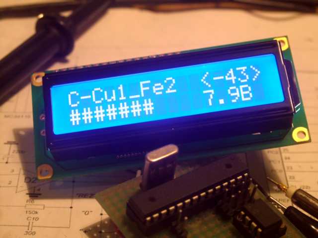

                            • #74
                              Save your Atmegas and programmers for something far more interesting.
                              What you think about device below? Yet another display sized VDI for detectors? Well, no. Complete display sized VLF detector with VDI, histogram, static or motion mode, auto gnd. compensation, variable frequency (4-16kHz in 10Hz steps), selectable audio mode, filter response, exclusion zone discrimination, 4 user selectable profiles ,coil nulling mode and more. Built using only 3 commonly available chips and handful of components, using internal Atmega ADC and software processing, from:
                              http://radiodom.ucoz.ru/index/selektivnyj_metallodetektor_quot_krot_m_quot/0-14
                              Only thing I can claim so far is, software works and this thing can actually detect metal, no performance tests yet. I modified electronics slightly, so far only software is intact, will made PCB for it (non-SMD) when prototype phase is over and test it with various coils and conditions (pinpointer usage included). Interesting project. Maybe not the best machine, but simplest one to build so far. Work in progress, will be continued in another topic.
                              (More advanced version of this is “Quasar” already mentioned on this forum, but more complex.)
