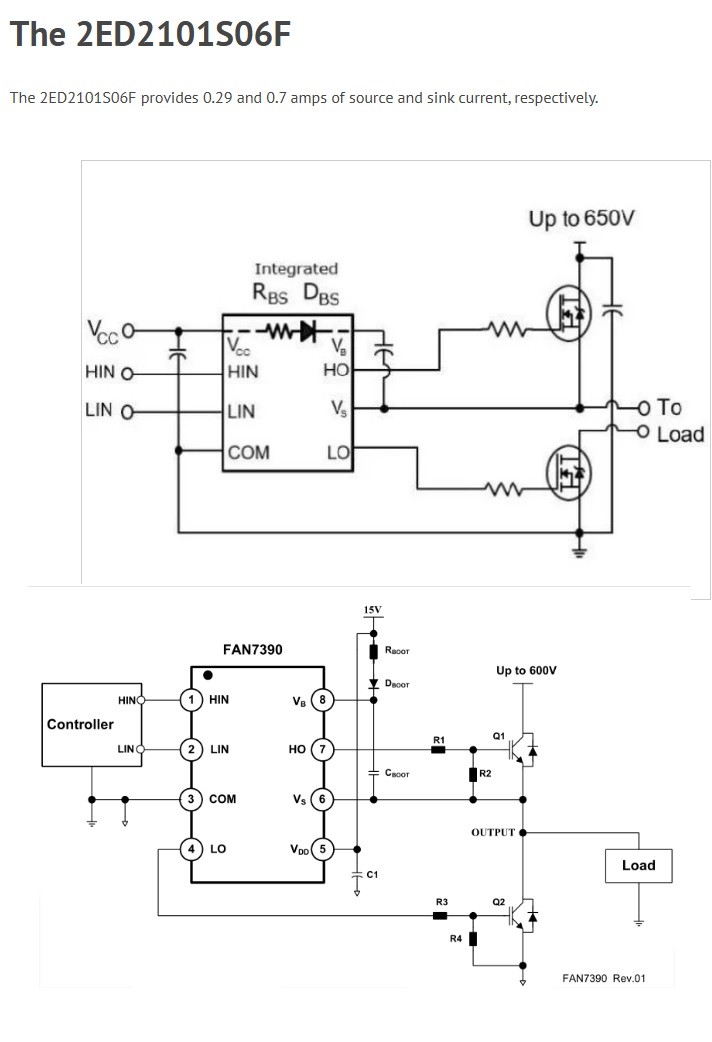

              I started this thread only because of a question about finding the best solution to replace the 4053 with a better solution.
                For example, instead of a 4053, you can use some kind of integrated circuit that is a high-side MOSFET driver. Here are some sample circuits with different integrated circuits. Click image for larger version

                  Yes, there were similar suggestions on the AMX thread.
                  But in my opinion, that would be a failure and a deviation from the concept and idea around which the book itself was written.
                  Carl seems to have followed the reactions of most members on the forum very carefully over the years and understood what the majority needed.
                  And in that spirit he wrote the book. Which, in my opinion, makes it even more valuable.
                  He used in most cases "old" components, which are everywhere and easy to get for anyone in any part of the world.
                  Specifically with this example of bipolar PI; he used 9640 and 740, mostly all chips are very easily available and everything makes the whole project even more interesting.
                  Of course, all this could have been done in a more "modern" way with new ultra-small SMD components and top-of-the-line specifications.
                  But that would turn off the vast majority of people, me in the first place!
                  I often refer to AMX, which I think is a fantastic project. But for exactly the same reasons I left the subject and I don't believe I will ever make one or do anything about it.
                  Because in some parts of the world (specifically, here, too) it is practically impossible ... or prohibitively expensive, to get most of the components.
                  Not to mention the working conditions and the impossibility of working with such small SMD components.
                  The good old "through-hole" way with DIL sockets; gives unprecedented freedom in further work and experimentation.
                  Of course, the performances between one approach and the other are clearly different and mostly go in favor of the "modern" SMD approach.
                  But here we are not talking about professional industry and production for wide markets. We have gathered here for hobbies and learning.
                  And for that purpose, the "classic" approach is second to none.
                  I believe that hardly 5% of the forum members have the approximate conditions to work easily with the top technology.
                  All the better for them, because what works well in the "classic" way - will work even better and easier in the "modern" way.
                  For this purpose, I think it is better to come up with a bipolar driver with discrete components instead of using some specialized chip.
                  And the understanding of the principles of work will be more complete.
                  In the specific case, I think it would be best to come up with such a driver with mosfets or BJT transistors.
