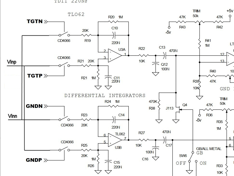

      This is where pot values get converted into timing values:
      Code:
      Bool ADC_Run(void)
      if(ADC_GetPot1() || ADC_GetPot2()) // If either pot has changed value
      Settings.TgtDelay = ( 50 + Pot1Value) << 1; // Min = 50 (12.5us), max = 113 (28.25us)
      Settings.TxWidth = ( 50 + Pot2Value) << 3; // Min = 50us, max = 305us
      Settings.TxPeriod = (200 + (Pot2Value << 2)) << 3; // Min = 200us, max = 1220us
      return True;
      return False;
      The problem is, a minimum TxPeriod of 50us (20kHz) requires reducing everything else to fit. You would first need to drop the TxWidth down to, say, 10-15us and go from there.

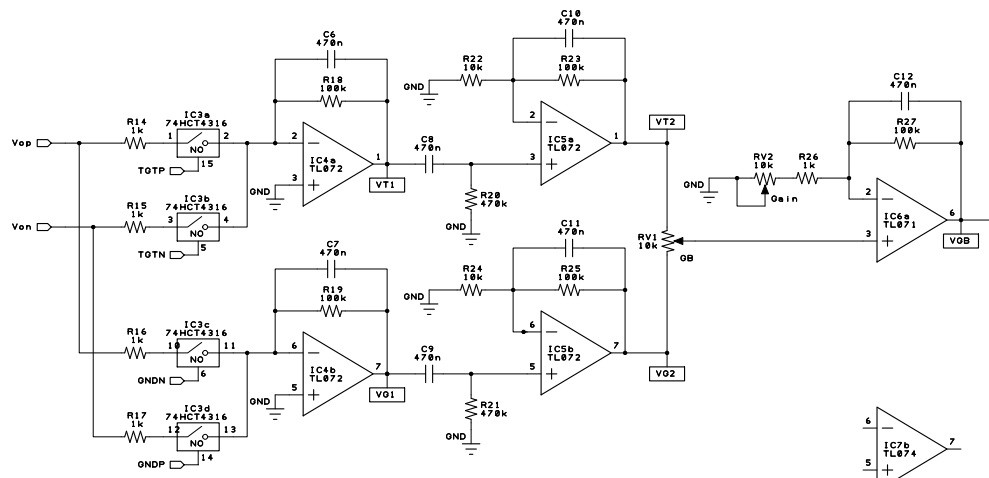

          Dear carl,
          I am re-designing your schematic, do you think i can replace a tl074 for Ic5 and Ic4?
            Hello.
            Yes, GND and -5V.
            Dear sir,
            About your Audio,
            Can i replace tl064 with tl074?
            thanks
              Yes and yes.
