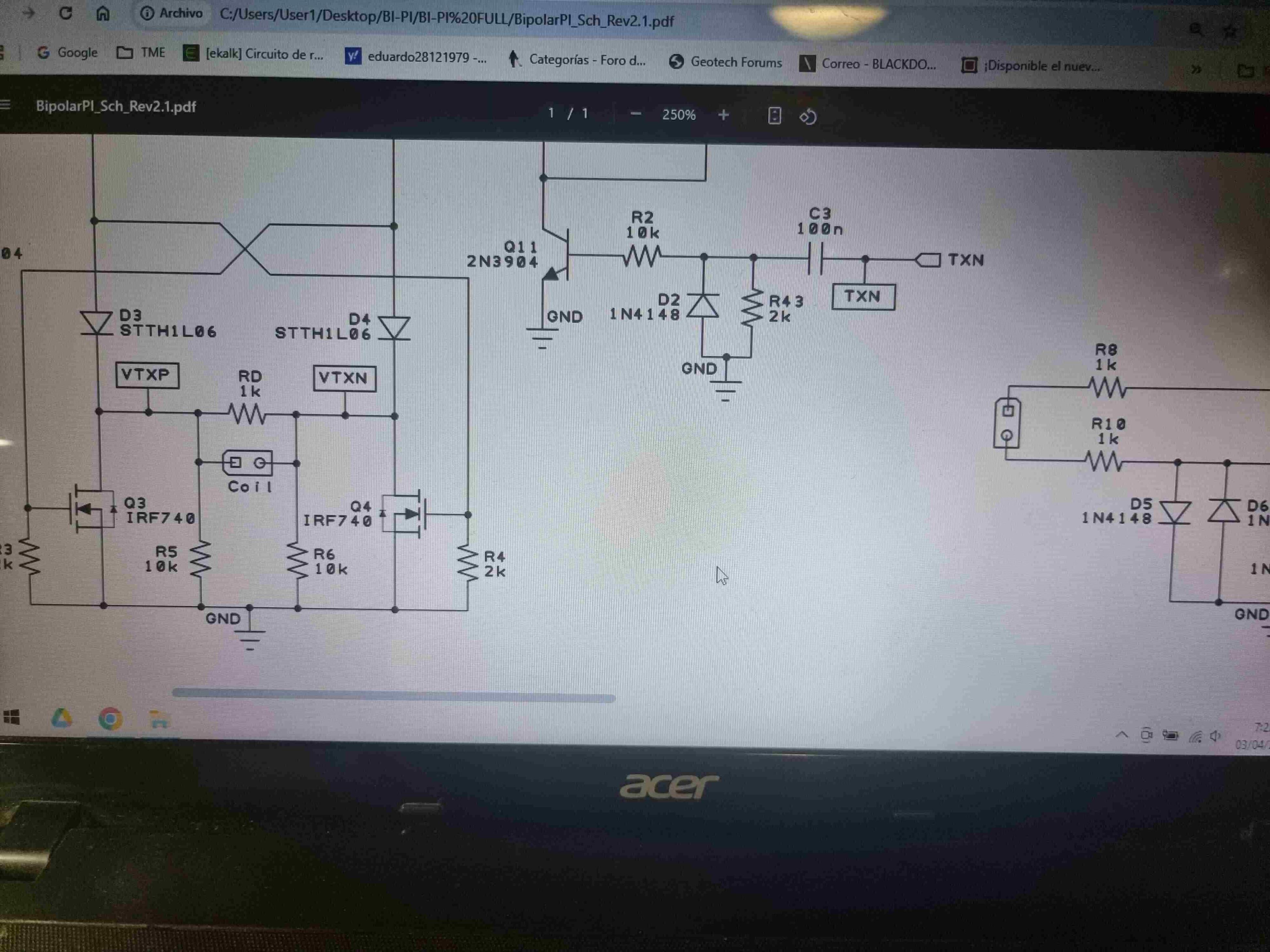

    Hi Eduardo, I corrected the code in two versions, you can test if this affects the depth, one version is 80us and the other is 100us. the frequency potentiometer is no problem, the signal does not drop, you can increase the frequency potentiometer all the way.
    Hi Algan.
    Thank you for your effort and dedication. I've tried both versions. The depth increases, but the results are worse. At 100uS, the MOSFETs get very hot, as the coil saturates, and the IRF9640 P-channel MOSFETs have a breakdown voltage of about 200V and can fry. The 80uS version works a little better, but I'm honestly sticking with the original version, as I've managed to improve a few more things on the detector, and I think 50uS is enough for now. My charge pump doesn't drop with frequency because I modified it, and now it's stable regardless of the frequency applied. The changes are shown in the schematic. I replaced the two diodes with two 10K resistors and used Darlington transistors.​

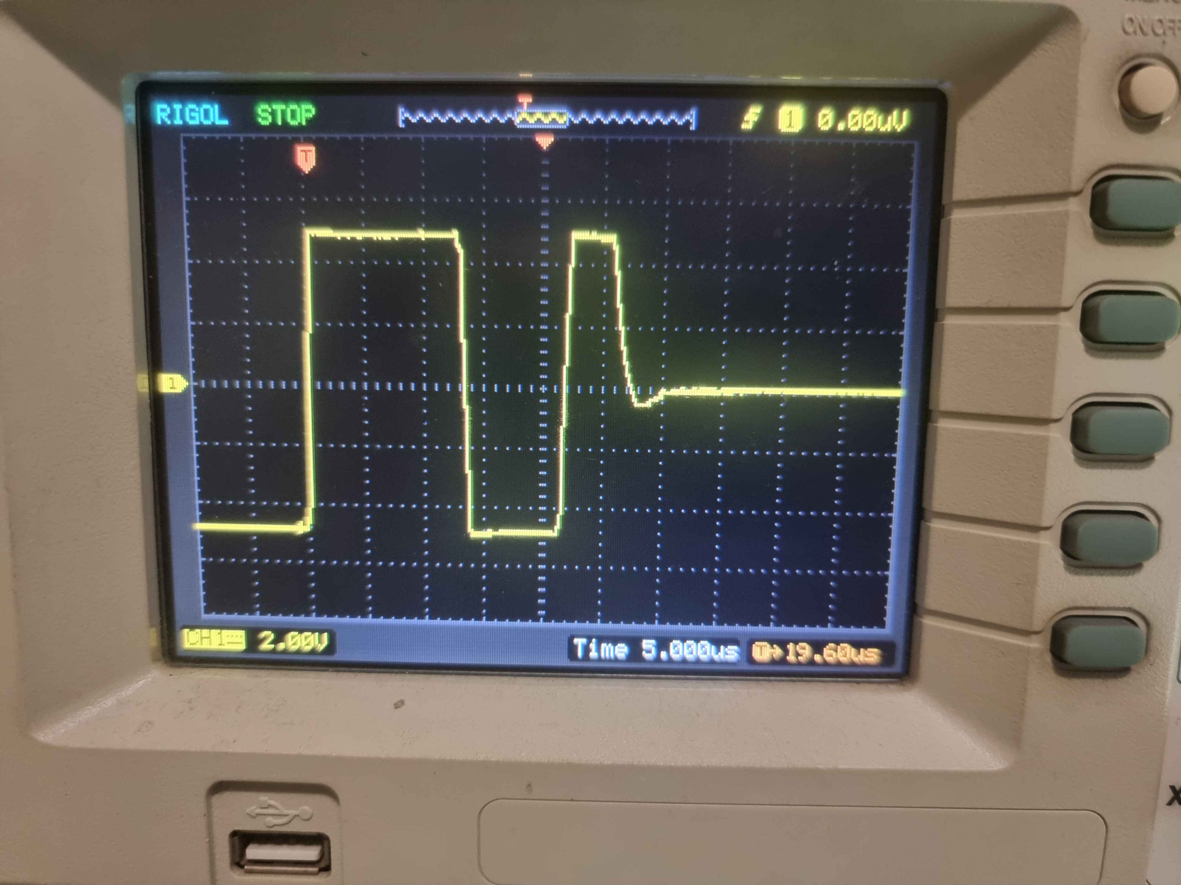

        • Hi Ivconic. I'm still getting the impression that your detector's damping resistor isn't the right value for the coil you're using. When I first made my detector, I used a 680 Ohm damping resistor, and my detector didn't discriminate under any circumstances. I chose the resistor at random, without even connecting the oscilloscope. To my surprise, the same thing happened to me as to you. The detector didn't discriminate, and it wouldn't detect small targets under any circumstances. Then I connected a multi-turn potentiometer—which you can see in one of my videos is very large and blue—and started turning it until I got the right resistance value. It was 330 Ohms. Sometimes it's better not to have the damping be critical because targets get lost during sampling. If you'd like, I'll take some photos tomorrow of how I have the signal at PIN 7 at the preamplifier output.

              • The main question at this moment is; how is this procedure done on a Bipolar PI detector?
                • I doubt it's the damping resistor. Even when badly damped the early-late sampling mechanics don't change. Go back to post 302. Are you getting correct polarity responses on each channel before the GB pot?
                    Hello Ivconic.
                    I've attached a photo of my oscilloscope screen. You'll notice that my coil is well underdamped, as it didn't have a resistance less than 330 Ohms. In reality, I needed about 270 Ohms. I prefer a slightly underdamped coil to sample all the op-amp saturation points. You need to connect the channel 1 probe of your oscilloscope to the VOP output. It's not necessary to measure with both oscilloscope channels. Pay attention to the polarity of the VTXP to R8 and VTXN to R10 connections, as shown in the original schematic.
                    I hope your detector problem is resolved soon.​
