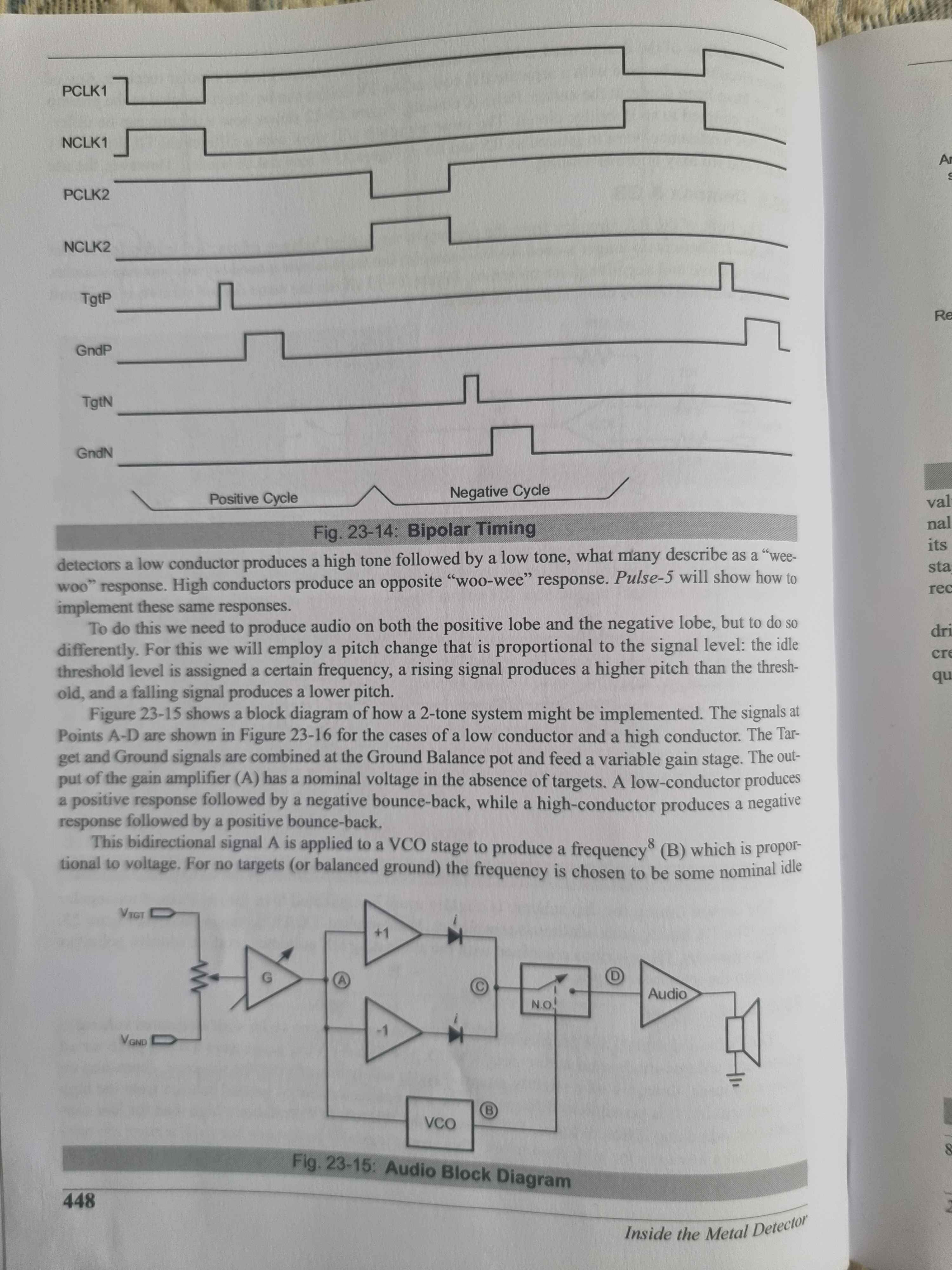

        And no one showed a diagram of the pulses from the final transistors - why...?

                • Originally posted by pechkata View Post
                  Hello everyone
                  Hi Pechkata. No one showed the pulses because they were shown in the ITMD3 book. Everything is very well explained there. On page 448 is the time base for this detector: PCLK1, NCLK1, PLK2, NCLK2. Then there are the four demodulation pulses: TGTP, GNDP, TGTN, GNDN. I think that says it all. Those pulses match the schematic and PCB layout perfectly.
                  • Hello Eduardo
                    Thanks for the clarification.
                    But I wanted to see these pulses - on your boards.
