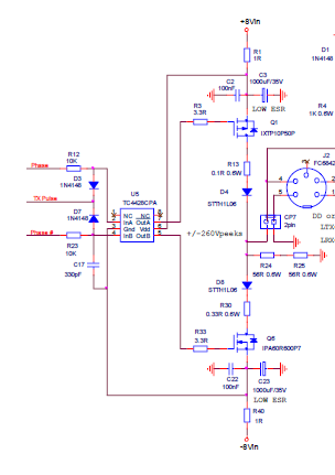

    • I made Tx tests, amplitude 1/2 compared to 1 MOSFET circuit, frequency 2x higher.
      So sensitivity will drop.​

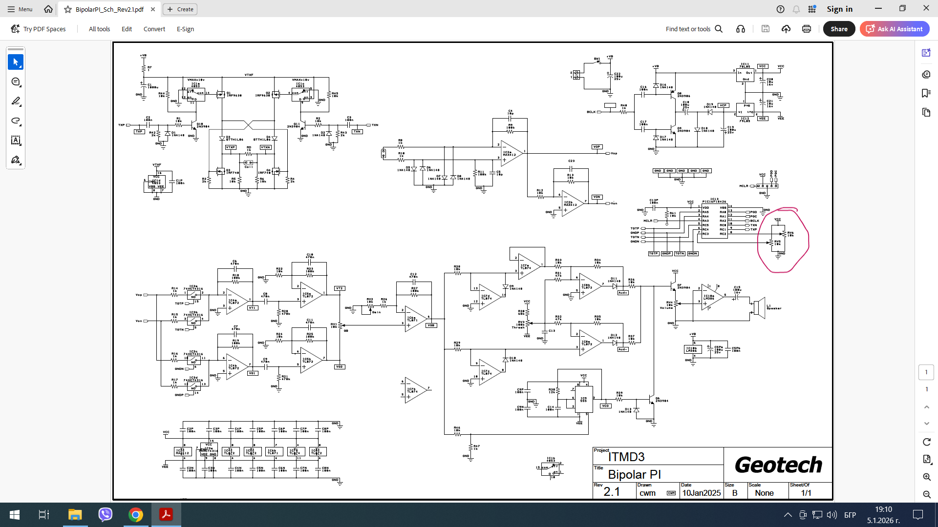

            Hi Pito
            Without the chip, nothing is visible.

              • Originally posted by pechkata View Post
                Hi Pito
                Click image for larger version Name:	Екранна снимка (22).png Views:	0 Size:	261.7 KB ID:	444357
                I was testing this part

                    Hi Pito - this has nothing to do with the project in this topic.
                      Hi pechkata,
                      I never assembled this project from ITMD3 book. I think, the aim of Carl with ITMDx is not to gives ready receipts for repeating. The schemes in the these books are more as educational platforms for the readers.
                      For those who only repeats the schemes from the book, it will be more faster and cheaper to buy one ready MD for some manufacturer with good reputation.
                      Hello Detectorist#1
                      It has nothing to do with what you wrote.
                      The schematics are completely identical to what we need.
                      It just takes a little logic to put the system together.
                      Carl-NC gives you an idea - not a detector.
                      And don't dwell on the sour grapes.

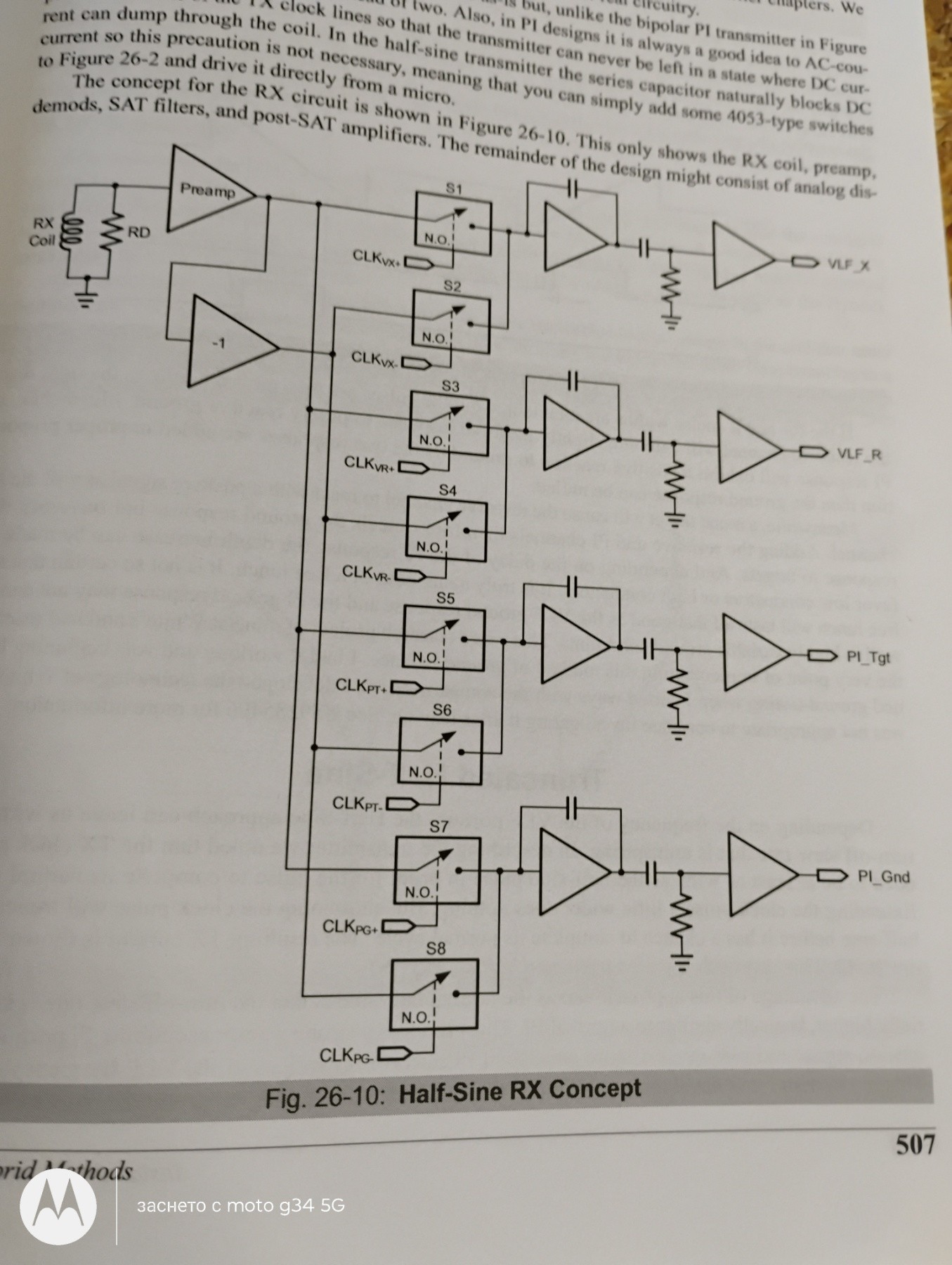

                          • Can someone provide a detailed explanation of the circuit effects, efficiency differences, and the pros and cons of using single MOSFET, half-bridge, and full-bridge topologies for driving coils in pulse induction systems?
                            • This is discussed in ITMD3 and in various threads on these forums. In a nutshell:
                              Single MOSFET: fastest, simplest, single-ended pulses, requires EFE samples
                              Half-bridge: slower, less simple, bipolar pulsing, no EFE samples, less balanced
                              Full bridge: slowest, least simple, bipolar pulsing, no EFE samples, fully balanced

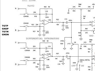

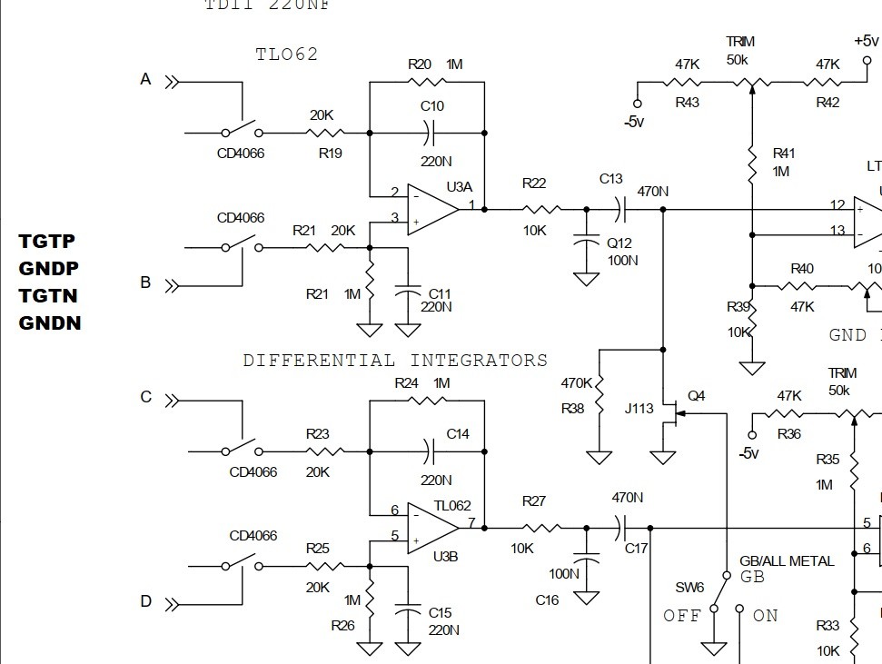

                              • Hi Carl​ I want to try the TDI ground balance, but on your bipolar circuit. Can you tell me how I should connect them correctly? Thanks. Click image for larger version
