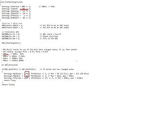

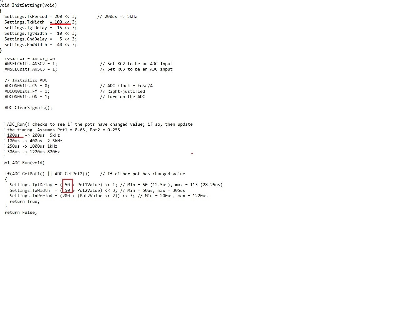

      • Thank you very much, Carl and Altra, for your answers. I'll try changing the sample widths of the GNDN and GNDP channels and matching them to the samples of the TGTP and TGTN channels. I'll also change the sample times and set them to the same as the TDI. In short, I'll use the same time base as the TDI, and I'll also use a 3 kHz frequency and a 100 µS pulse width. I hope this works.
ID:	436094 Hi Carl. Are these changes enough to change the width to 100us? I just don't know which ones I have circled in red and whether they should be 100us. Thanks.
          • See this post:
              The GB in this design is done differently than the TDI but the results are the same, except for where the target hole ends up. Any time you have trouble detecting a target turn off the GB and try it.

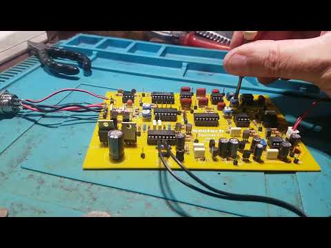

                • Ok, today I found time to do some things.
                  First, I wound a 0.32mH, 27cm mono coil.
                  Second, I put a real cable between the coil and the pcb.
                  I asked a question about this before, I didn't get an answer. So I found the answer myself.
                  Third... the freq is now fixed at 2kHz.
                  I won't write further, because I'm tired and very lazy... don't get me wrong, these two videos don't even need special comments, for those who are "in the matter" any additional comments are unnecessary.
                  For those who are not "in the matter", even 10 pages of comments will not be enough.
                  Final conclusion: this is a very good starting platform for further development.
                  But more importantly, for learning. Carl did a very good job.

                        https://www.youtube.com/watch?v=3jIz7-Rm__I
                        Hello Eduardo
                        It turned out very well - well done.
                        What are these yellow cables for?
                        They are not here.
