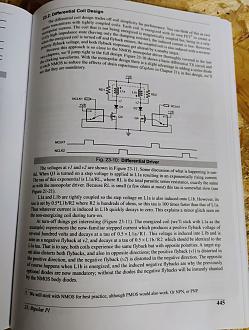

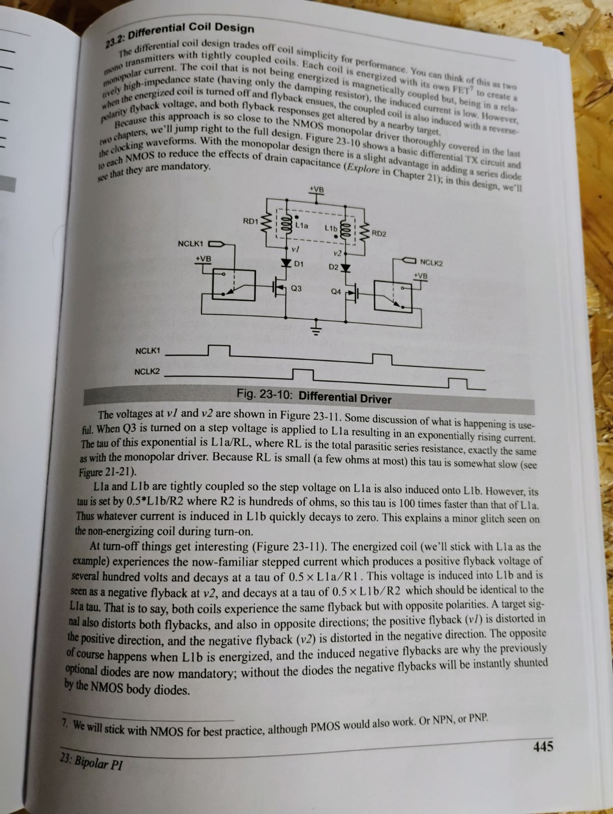

    • Hello Karl can we apply this scheme to this project...?
      What would you suggest - how many coils...?
      The AF 108 coil - can we use it...?

      • Yes, but you would need to use the PMOS devices to drive the coils. The AF108 coil should work.
