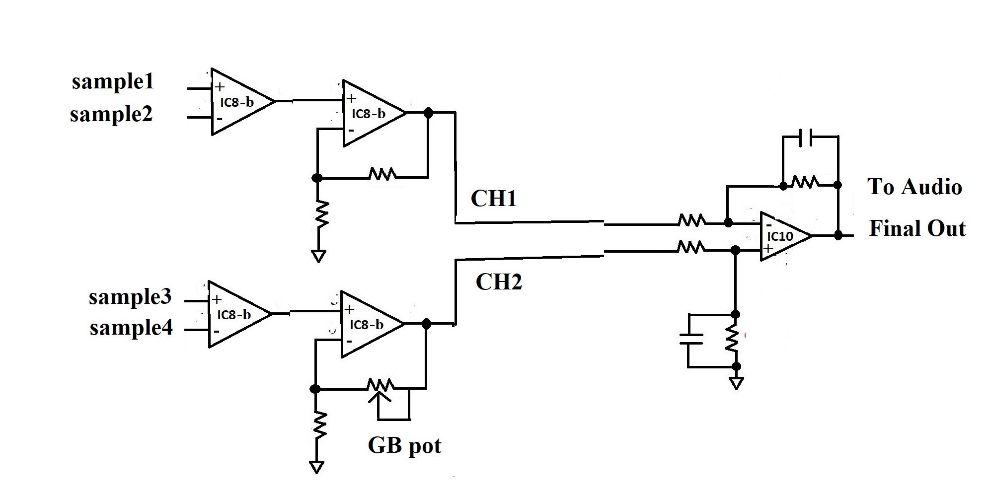

            Hello Dear Carl
            I have a question about low/high tone for discrimination. Please see attached, we can also use such GB, subtraction operation because i am using such method for my PI and it is working very nice. But you prefer to use a different method for your Bipolar-PI.
            My main question is that, do you think the high/low Disc can also work on the GB method?
            • Yes, that method will also work.

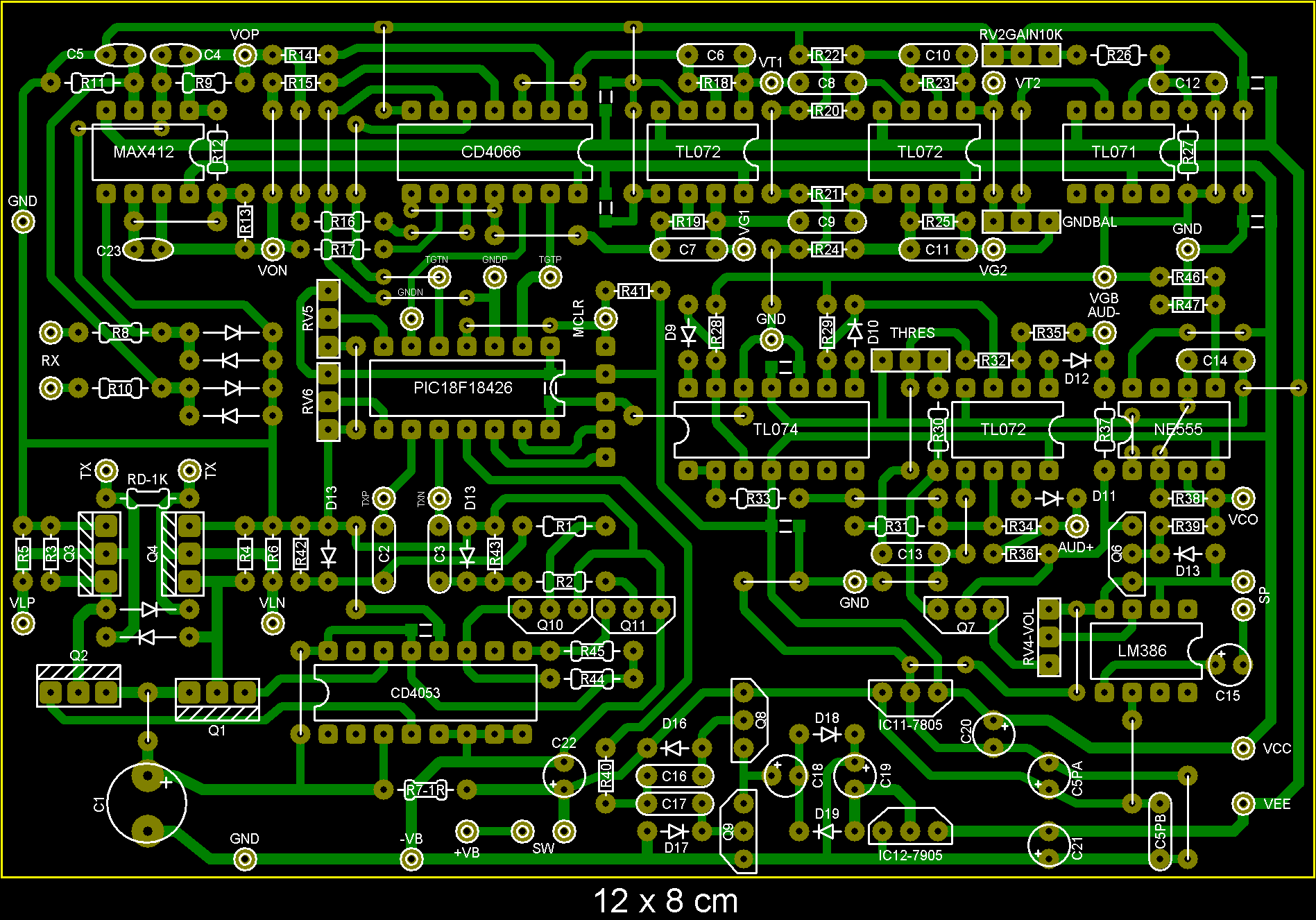

                        • hi all Member of forum
                          please this PCB is correct for CD4066 or no ?
                          • Hello Mr. Karl, please help me build this project. There is no 74HCT4316 IC in our country.​
                            thank you for this project
                            • Hello Sayan1345,
                              You need to compare the datasheets for the two components (CD4066 and 74HCT4316) to ensure they are pin-compatible. If not, please check that you have connected them correctly on your board, as shown in the datasheet. You can find both datasheets online. Just search for them on Google.​​
                              • thank you very much
                                I downloaded datasheet for both IC
