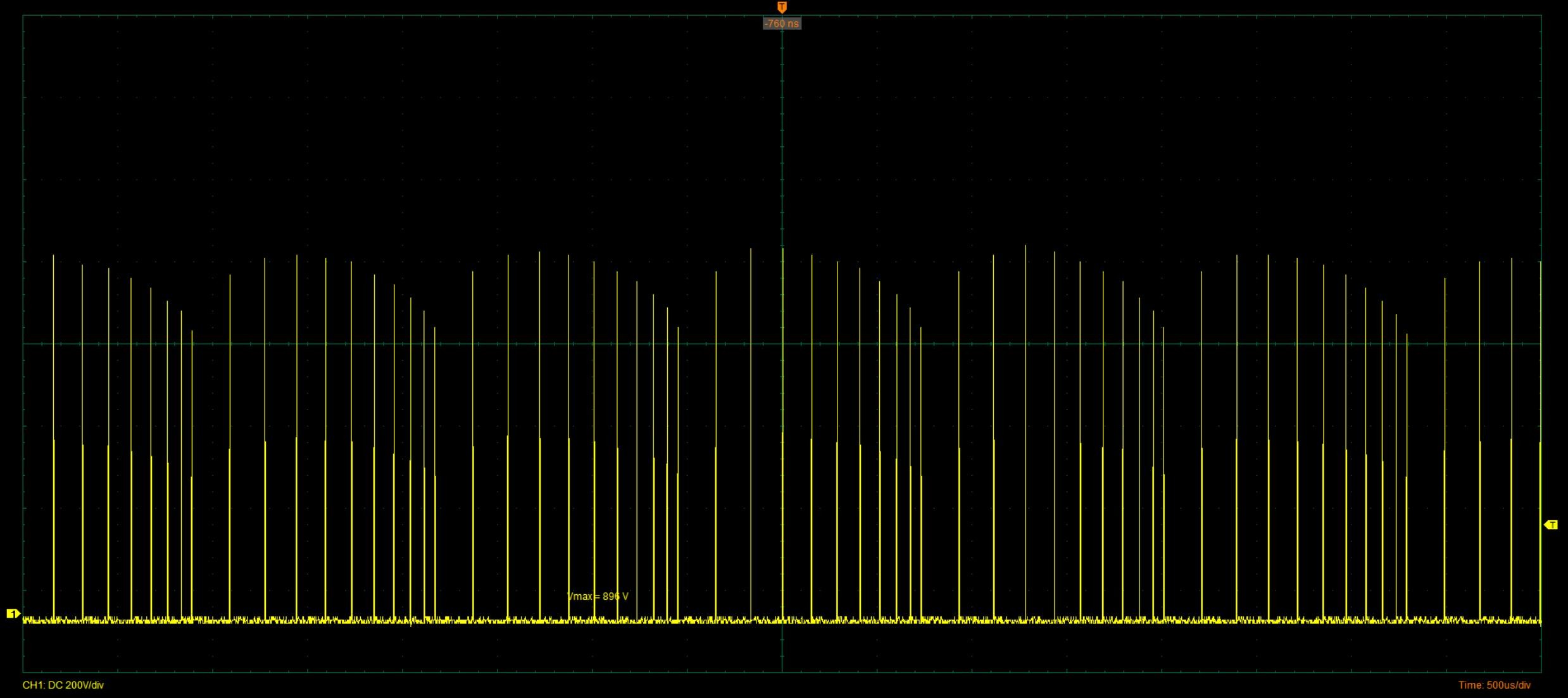

        Are you suggesting a linear chirp or a few discrete pulse steps? If linear, would you dump everything into a single demod channel? I would assume 3 or 4 discrete steps, each with its own demod channel(s). And would probably weight the short pulse higher, something like this:
        200 100 40 40 40 40 100 200 100 40 40 40 40...
        Either run analog demods or preferably use a 24-bit SAR ADC and direct sample.
          The first try (last year) gave the results seen in the picture above. (Real circuit)
          The Flyback shows that the peak current is not the same with different cycle length. The cause was the slope in the TX current.
          Now we have achieved the correction of the slope, so that every TX pulse is of equal peak current no matter the length of the cycle.
          Trying to keep the PRR (Pulse Repetition Rate) as high as possible, I think that maybe 2 switchable modes accentuating the desired average response for larger or smaller nuggets might be a good idea.
          A coil size of 8", would be used more for smaller nuggets. More shorter cycles.
          The 12" coil for larger nuggets. More longer cycles.
          With the same peak current for each TX pulse, the demodulation is essentially the same.
          The difference is in the decay time for the targets with a TC that is too long to decay completely before the next TX pulse.

                      The Square Current Wave TX is ideally suited for variable PRR. A BIG STEP FORWARD WOULD BE A CHIRP PRR, where every target is "illuminated" or "excited" with pulse cycles of various times, to induce maximum eddy currents for targets of every size.
                      Does a CHIRP already exist on the market?
                      In my archives I found a scope picture of a CHIRP experiment I did in 2017. For some reason or other I did not continue the experiment.
                      I definitely think that it would be worth spending some time experimenting with a CHIRP PI.
