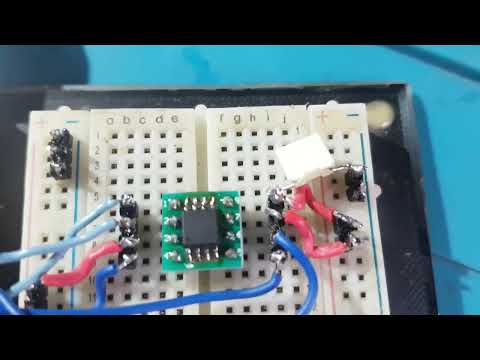

                • Not directly related to the last couple of posts... but coincidentally, I'm currently troubleshooting a problem connecting a SPI flash eeprom to an Arduino.
                  It is the Winbond 25Qxx series. There are "everywhere".
                  Old motherboards from various PCs and laptops, set top boxes, various embedded devices... are really in mass use and very easy to get hold of.
                  I have a dozen pieces that I have already removed from the old devices, and I guess I have another hundred pieces on the boards, which have not been removed yet.
                  I currently have 1, 4 and 16 Mb capacities.
                  The "problem" of connecting to Arduino UNO boards is the voltage levels.
                  The Arduino UNO is powered by 5v, so the logic on the pins is also at that level. W25Qxx is powered by 3v3 and the logic is at that level.
                  There are very few "solutions" on the internet... and as far as I've seen; most are not valid. Does not work.
                  People try to adjust the levels with resistive dividers and that is a very bad solution.
                  An alternative solution is an Arduino that works on 3v3, for example Mini and Mini Pro (and a few more).
                  But I don't want that solution, I deliberately want an Arduino UNO, for many reasons that are irrelevant here.
                  So I resorted to the only possible solution; and it is a modification of Arduino UNO to work on 3v3. It's a work in progress, I can't confirm it's the correct solution yet.
                  But the point is the following; I have worked with various SD readers and SD cards. SPI flash eeprom has many advantages. I think there is no need to list them.
                  Apart from speed and 4mA consumption in active mode; a very important reason for is the size of the chip and the place it will occupy on the pcb, as well as the ease of connection.
                  In particular, that chip will serve as "ROM" for me. The previously written database will be read-only by mcu.
                  Such are the needs of the device I work on.
                  As for the current PI detector project, I assume that the chosen development system will have sufficient resources and memory; so no additional SPI flash will be needed.
                  But if one opts for a more modest development system with less memory; I think using additional SPI flash memory is a very good idea.
                  Just... another idea to think about.
