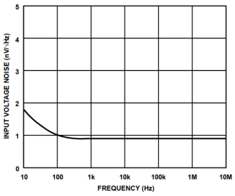

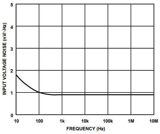

                From this I see the white (thermal) noise is 0.9nV/rtHz, and at around 100Hz begins to rise. 100Hz is the "1/f knee", below that flicker noise dominates. Here is the plot from the OPA350:

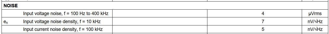

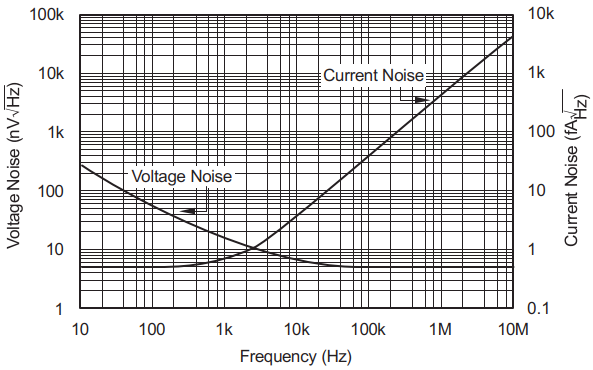

                From this you can see the 1/f knee is 10kHz (bad) and the excess flicker noise is pretty high; at 10Hz it's almost 300nV/rtHz compared to less than 2nV/rtHz on the AD797.
                When you look at the spec table it says:
                The only integrated noise listed is from 100Hz to 400kHz, which is not very useful. In short, I consider this a very noisy opamp and not suitable for a high-performance preamp.
