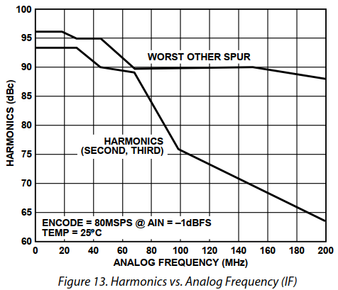

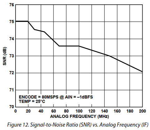

            On the ADC, it is important to understand what performance metrics matter and which do not. First, we are sampling a wideband signal that exceeds the Nyquist BW of the ADC, even if we use 1MSps. Way back I casually stated that a 0.25us nugget (sub-grain for sure) needed at least 636kHz of BW. Technically an exponential decay has infinite BW and 1/(2π∙τ) captures half of the energy. We would actually prefer more BW but I'm concerned that excess noise will swamp out weak signals. So if we set up a Nyquist filter like you would normally do (fs/2), we lose small nuggets. So our ADC will be folding in some of the second Nyquist zone noise which is why I'm especially concerned about SNR.
            Also, SNR is a function of frequency because of the clock jitter in the SHA. In fact, except for quantization noise the SHA is the most noise-dominant element in the ADC. The raw size of the hold cap determines the thermal noise (the so-called kT/C noise) and the clock jitter determines the frequency degradation. You would normally design the clock for minimal degradation over the first Nyquist band unless you are intentionally designing an IF-sampling ADC. The last ADC I designed for Analog Devices was the AD6645, here is the SNR-vs-f plot:
            Click image for larger version  Name:	image.png Views:	0 Size:	38.6 KB ID:	410221​
            This ADC was designed for IF sampling so even though the clock is 80MHz the SNR is plotted out to 200MHz. The roll-off is almost entirely due to jitter.
            Harmonics don't matter so much for the AMX. Harmonics give rise to signal distortion but we are not so much concerned with pure fidelity because there are probably no pure signal responses in the first place. Nuggets tend to have multiple domain responses where a single exponential dominates, so it's already a distorted signal. Viscous ground is a power-law response with some variation in the power term so it's also a non-pure response. Even a -60dB spur in the ADC is only 0.1%, I think we can live with that. Also, harmonics internally generated by the ADC (which are what you are seeing in the data sheet) are not limited to the first Nyquist zone. They are infinite in BW and fold back into the first Nyquist zone. Again, the AD6645 shows harmonics out to 200MHz even when sampling at 80MHz:
