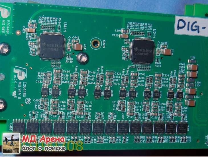

    The GPZ6000 from minelab ( which is not cheap ) has 14 M HC4053 anlogue muxes and 2 at least texas instruments ADS131 4 channel 24 bit @ 128 msps.
    The other option is multiple sampling integrators forming multiple separate channels each with its own filtering and amplfiction then feeding separate ADCs and all the scaling and subtraction etc is done in the CPU.
    This will be more chips but say 8 channels minimum is certainly doable and could have a very wide input voltage range ( eg 40 volts ).

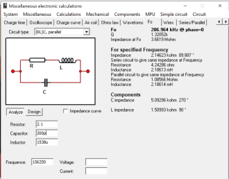

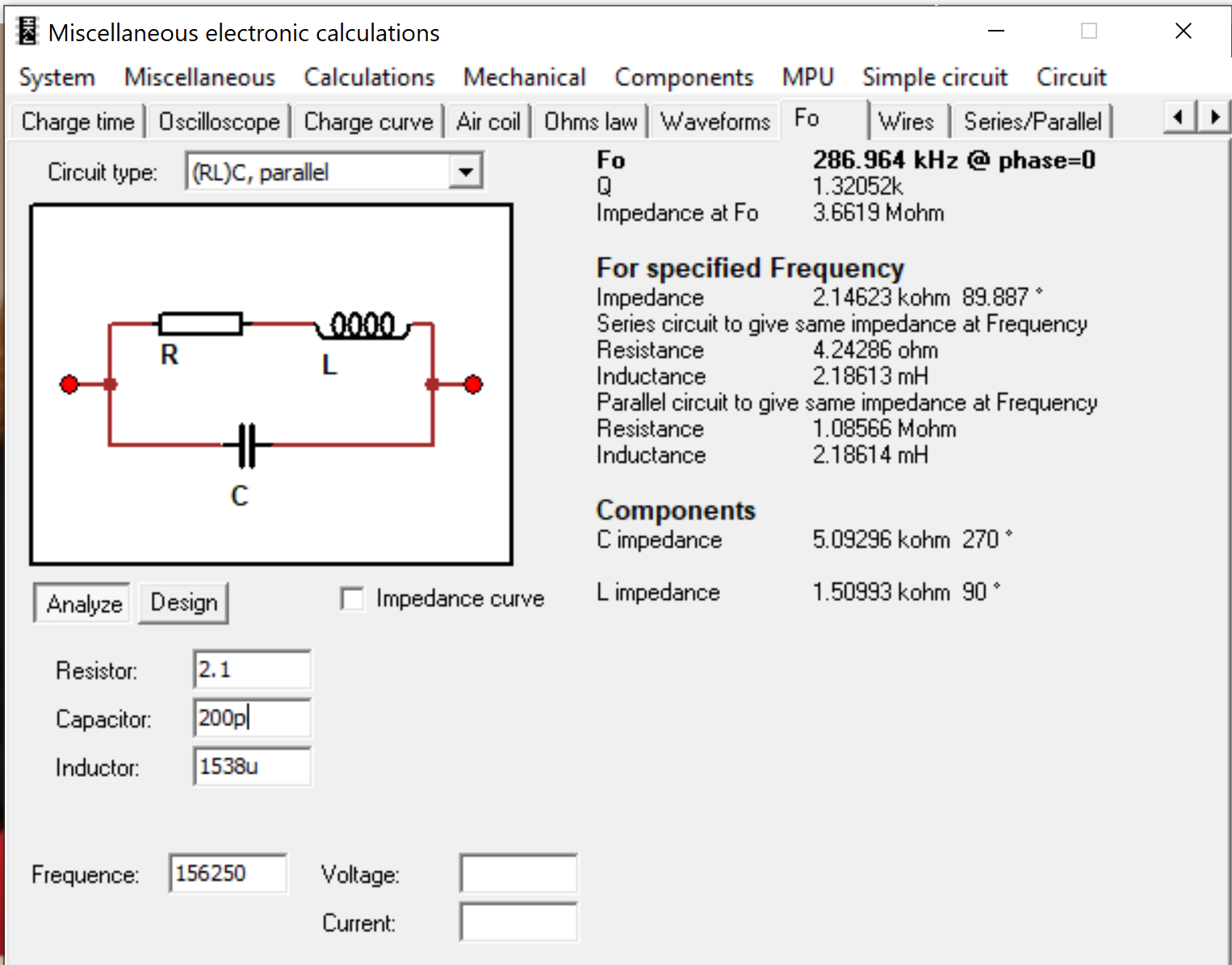

                        SRF, the self resonant frequency of a coil is often used to describe the frequency a coil will resonate. See picture attached for AMX TX coil.
                        In a real hardware situation everything connected to the coil, like coil cable, coil shielding, cable shielding, Mosfets etc. including everything that is capacitively and inductively coupled to the coil, has some influence on the resonant frequency of the coil. Click image for larger version
