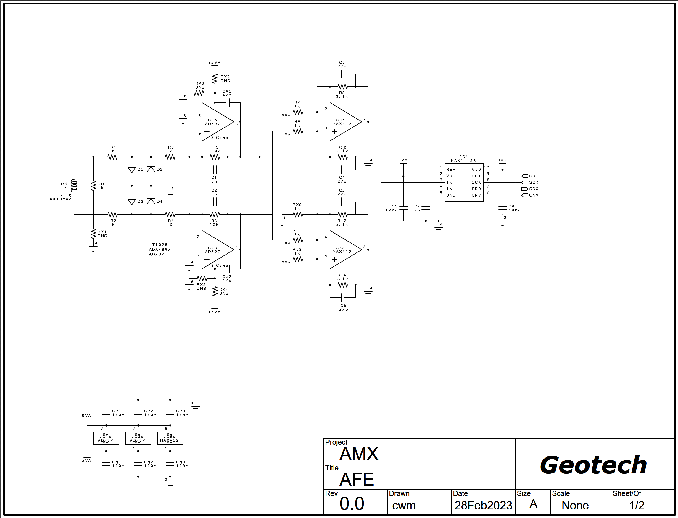

            I'm moving further discussion of the RX AFE from the "Concept" thread to this ("RX") thread. Here is the AFE I've been working on:
            ​ Click image for larger version  Name:	image.png Views:	32 Size:	188.7 KB ID:	410260
            It is based on Tony's original concept, see post #2 of this thread. I have modified it so it can be run in either voltage mode or current mode. The schematic values assume current mode. I have also added a second subtractor stage to maintain a fully differential signal all the way to the ADC. The ADC says MAX11158 just because that's where I left off during the ADC debate. I will probably change it.
            Right now I have the AD797 for the first stage because it's low noise (0.9nV/rtHz) and also has low flicker noise. Note that pin 8 is a "compensation" pin. Other candidate opamps sometimes use pin 8 for Enable or Shutdown so I've included resistor options for tying the pin high or low. The second stage shows the MAX412 but that's just a placeholder; the actual opamp is TBD.
            Note RX1 at the RX coil and RX6 on IC3b. These allow converting the AFE first stage to single-ended mode. The possible reason for this is to improve noise. The fully differential architecture has sqrt(2) times the noise of a single-ended version. I will do another noise analysis in this thread that updates the numbers to this circuit.

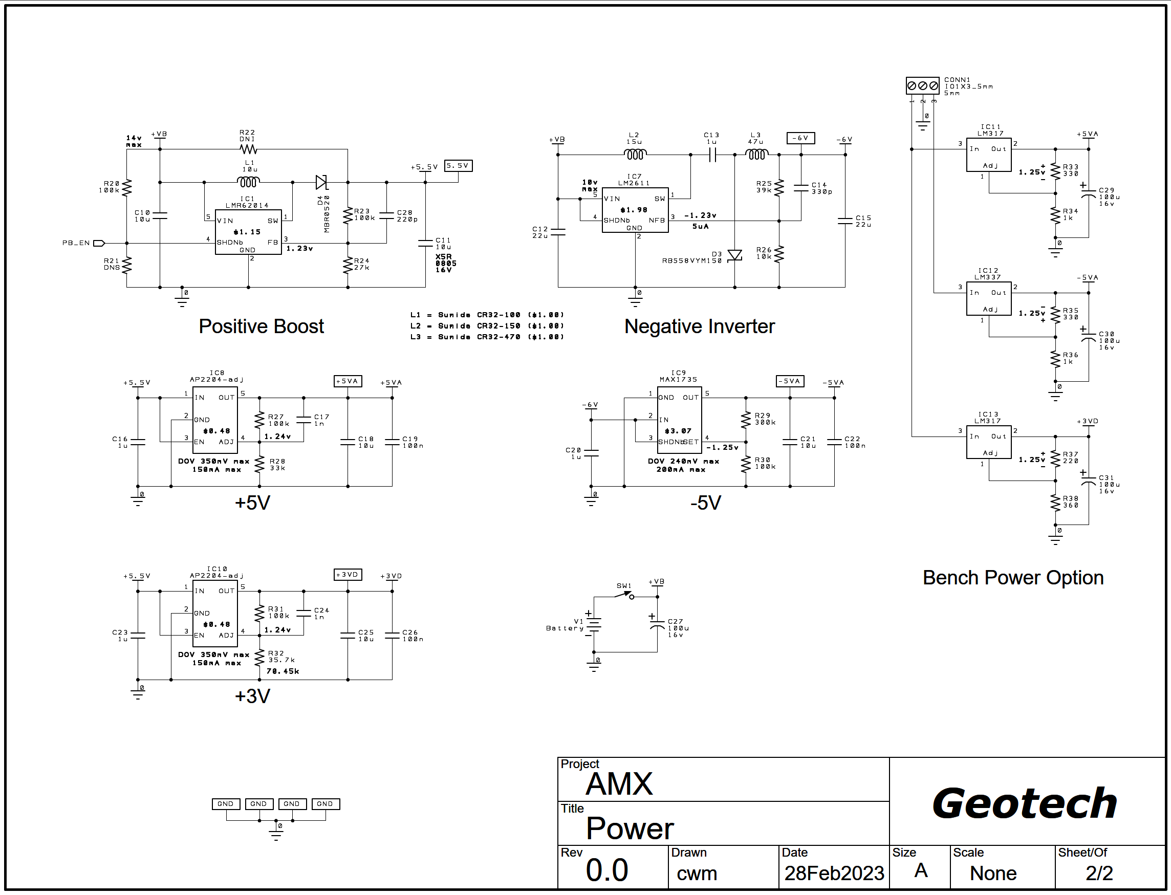

            Here is the power supply for the AFE:
            ​​​ Click image for larger version  Name:	image.png Views:	33 Size:	271.9 KB ID:	410261
            This is designed around a "true ground" principle instead of the usual rail-splitter fake ground. That is, the battery ground is the actual ground for the whole circuit. I have not decided what batteries this will run on, I'm leaning toward 7.2V Li-Ion but maybe it's 4-C cells. The Positive Boost stage is for use with a 6V battery and is probably not needed for the 7.2V option, therefore it has a bypass option. Both analog rails are powered by linear regs that can be adjusted in case we want something other than +/- 5V. The MAX1735, however, is limited to -5V so I need to look at other options. Finally, there is a "Bench Power Option" that uses grungy old LM317/337 regs for a quick-n-dirty way to get started without building all the other power circuitry.

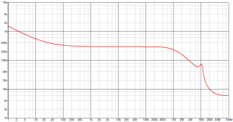

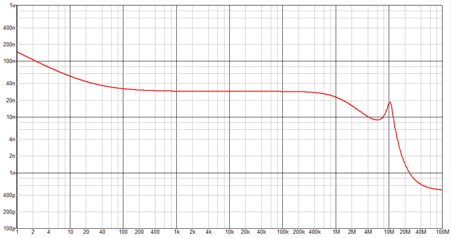

              Here is an updated noise analysis, see this post and this post for the original. I'll assume current mode since I know it offers the lowest noise. The coil resistance is now 10Ω and the feedback remains 100Ω.
              The feedback resistor (100Ω) noise is
              The opamp (AD797) input-referred noise is 0.9nV/rtHz (note: in the previous analyses I used the wrong gain; it's 2*RFB/RL+1, not RFB/RL+1):
              The opamp current noise is 2pA/rtHz and is even more in the mud than before so I will throw it out.
              The total differential noise of the first stage is therefore
              Here is a sim plot of the first stage noise:
              Before applying the second stage gain, we can take this number and divide by the first stage gain to get the total input-referred noise. The first stage gain is 2*100/10 = 20 (because it's differential) so the input-referred noise is 1.4nV/rtHz. In an opamp gain stage, the input-referred noise fundamentally can't be any lower than the opamp's input-referred noise which is 0.9nV/rtHz. The result of 1.4nV/rtHz suggests that the differential topology has a noise that is sqrt(2) higher than a single-ended topology, which makes perfect sense because there are 2 opamps in the differential circuit. In short, we can reduce the noise by using a single-ended preamp.
              Anyway, 28nV/rtHz is applied to differential-difference amps with an overall gain of 10. Previously I ignored the noise contribution of the second stage because I know it's in the mud due to the gain of the first stage. For example, the 1k input resistor adds 4nV/rtHz to 28nV/rtHz which is 28.3nV/rtHz. If we like, we can bump this up to 30nV/rtHz and avoid any more math. So the second stage output noise is 300nV/rtHz. NBW is still 1MHz so the total integrated noise is now 300uV rms or 1.8mvpp. This is 555 codes per volt so a 10V full-scale input (now assumed) would need 5555 codes, or 13 bits. Or for a 16 bit converter @ 10V we have about 11.8 LSBs of noise. You'll notice this is worse than the original analysis (4.1 LSBs with a 1nV/rtHz opamp) but the overall gain here is 200 instead of 50, so we're actually doing better. Here is a sim plot of the total preamp noise:

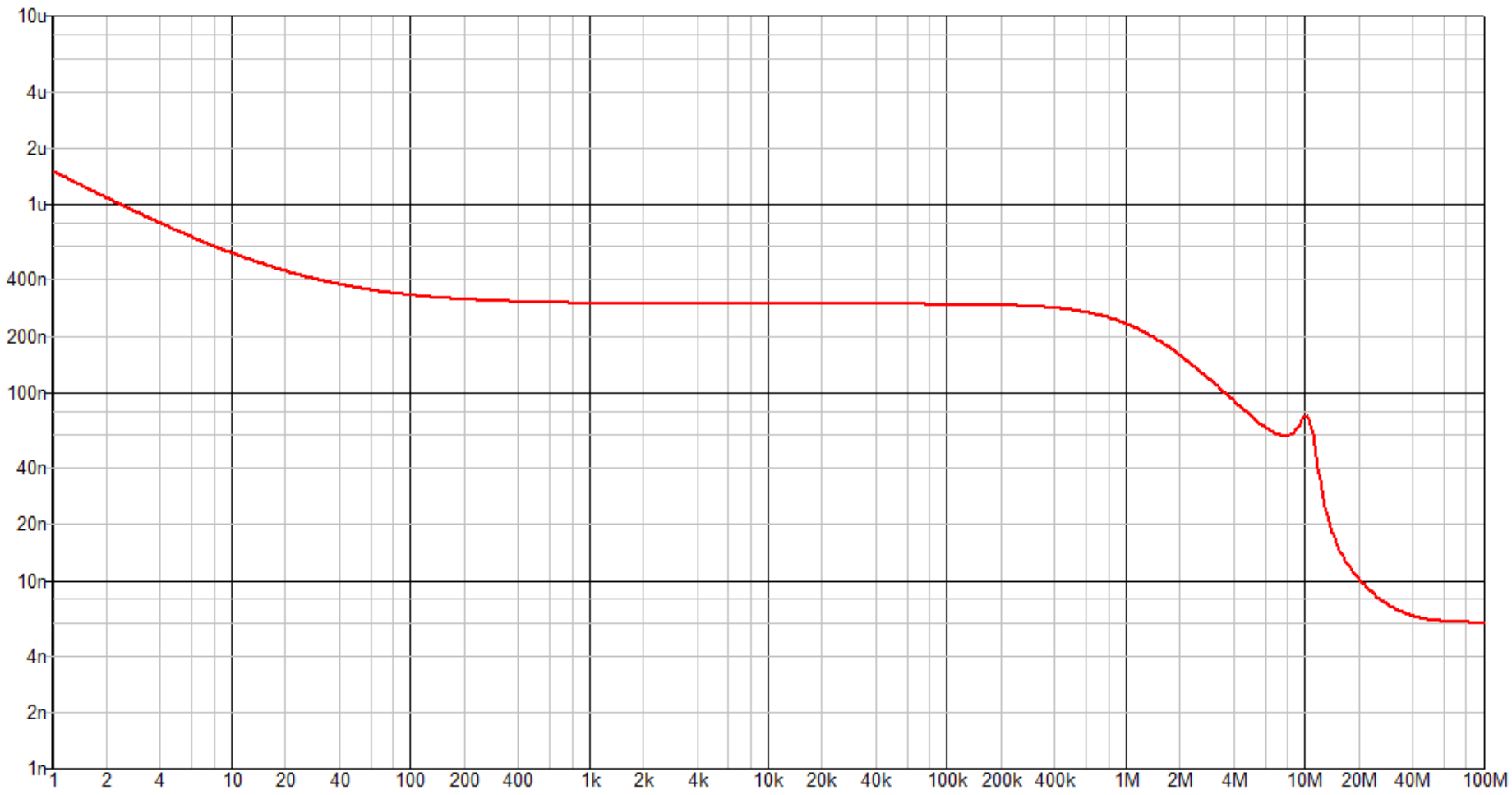

              Let's take a quick look at a single-ended preamp. To maintain the same overall gain I'll bump up the feedback resistor to 200Ω.
              Dividing by the gain of 20 gives us an input-referred noise of 1.03nV/rtHz, just above that of the opamp alone, which is expected. After the second stage the noise is about 220nV/rtHz or 1.32mvpp. This comes to 8.6 LSBs of noise @ 16b.
              All this suggests that no matter what you do, you are fundamentally limited by the input-referred noise of the first stage opamp multiplied by the gain of the preamp. And that is true for an opamp-only solution. Then you might be tempted to reduce the gain to reduce the noise but this actually reduces the SNR. You want to run the maximum gain that doesn't overload the preamp and you want a fair amount of that gain to be in the first stage so that subsequent stages don't contribute any noise.
              If you dive into a discrete transistor preamp then it's possible to reduce the noise further. I've played with common-base front-ends and gotten the input-referred noise down to 0.5nV/rtHz, which would roughly cut our single-ended noise by half, or 4 LSBs @ 16b. In a future version I might consider this but I don't want to complicate the design at this point.

                    The rest of RX schematic I like. Doable.
                    I don't like power supply schematic. But the bench option is alright.

                          Carl I am bit confused about power supply pins at IC1-3 ???
                          You engaged decompensation pin 8. alright.
                          You haven't draw PS pins, so I assume those go to +/-5v, right?
                          Any decouplings close to PS pins at chips?
                          RX3&RX4 DNS??
                          R1-4 ??
                          • #43
                            Say Carl; C7, is it really 10uF non polarized cap? Or it is just a typo?
                            • #44
                              RX3&RX4 DNS??
                              R1-4 ??
                              I see decouplings now, sorry! Was lazy to scroll down!
                              I need only clarification on those "DNS" values as well as the reason of R1-4 existence?
                              Ok, R3&4 I would use as 1k. To equalize&limit the current only.
                              Value will mostly depend on coil(s). 1K is wild guess.
                              But on the other topic we discussed thermal noise, so those resistors will introduce certain noise on signal paths, therefore... ?
