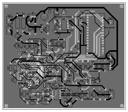

                          That's funny I totally nailed the exact Pin count on the pro Q board I think I finally have ready.( fingers crossed)
                          Just a recheck of my jumpers. and I think its Ok it passes all the design checks except compare to schematic . I have to fix one of my jumpers on it but the board is corrected.
                          What gerber option on Di Trace did you use to export a file to a PCB manufacturer ?

                          Thanks again for all your help with the schematic and all.
                          • Originally posted by godigit1 View Post
                            [ATTACH]54793[/ATTACH]
                            File > Export > Gerber
                            and:
                            File > Export > N/C Drill
                            Then use a Gerber viewer such as Gerbv to check everything looks ok, especially the placement of the silkscreen.
