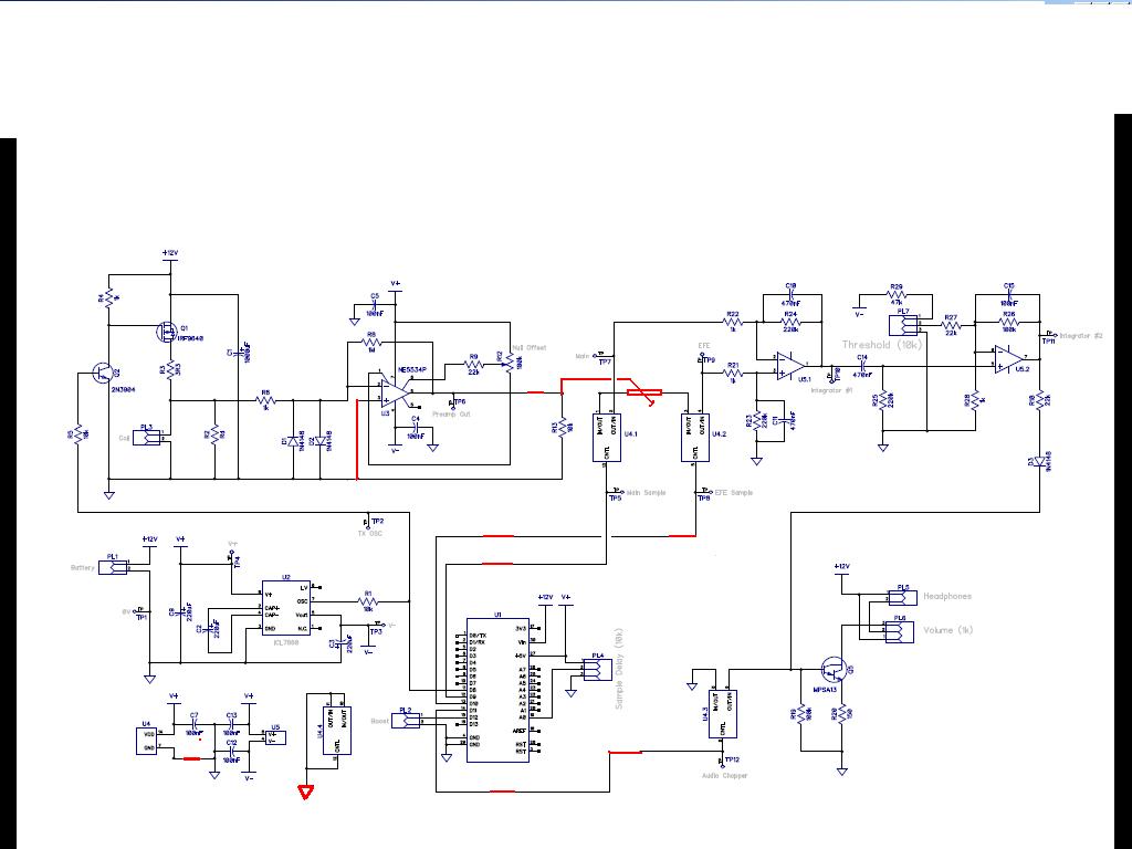

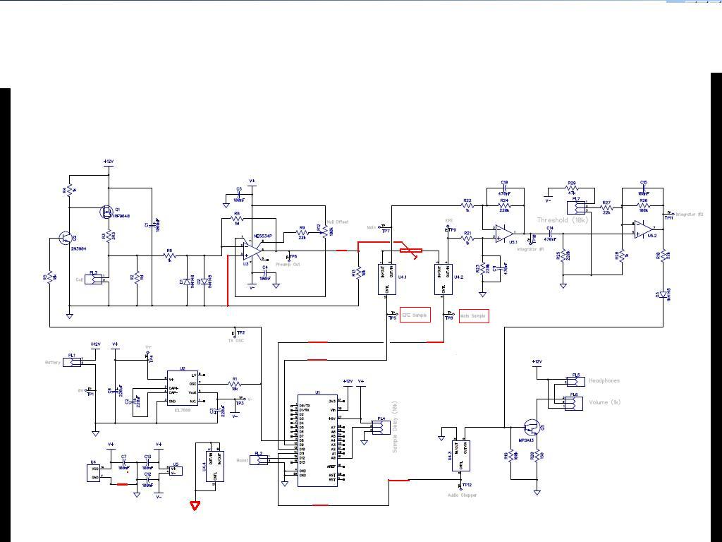

        • This is a nice project , especially for learning and education, but let me make some changes to the
          circuit.

          • Originally posted by Xtrem View Post
            circuit.
            [ATTACH]54816[/ATTACH]
            Have you made and tested these changes on the original circuit?
              Yes
              plus changes on the sound.
              • The drivers for the 4066 are not necessary, if you handle only the positive part of the signal (0 to +5V)
                  can you draw it ?, do the 4066's turn on completely ?
                    Why does the sound go away when the object gets close to the coil
                      If we supply the 4066 with a single 5 volt supply
                      then it opens and closes normally,
                      but the analog signal that is managed and passes through
                      it, this must also be from 0 to 5v. thats why i reversed the
                      input signal.
                      • Originally posted by Matt_Rowe View Post
                        the sound dont go away, but we can not hear it because the high limit frequency of the VCO is
                        too high.
