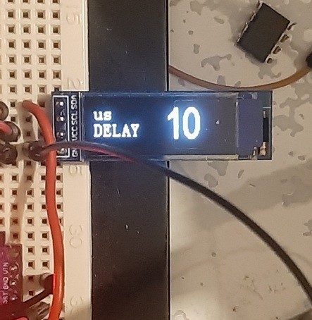

          Actually I've attached a 128x32 OLED and can see the delay in real time. My eyes are not so good anymore so I'm looking for big fonts. Will post the code when I'm satisfied with it.
          Be interested in the display code, please post the code when you are ready. At the moment I am just marking the pot, were it is sensitive to gold, but would be good to get exact numbers ..
          • #50
            I will. But that's anything anyone here could do, since the loop() is fully available. Find a display of choice, get the library and insert the code in the sketch. It doesn't matter how heavy the library is cause the MCU here does basically nothing and the memory use is minimal.
            you could even add a videogame too )

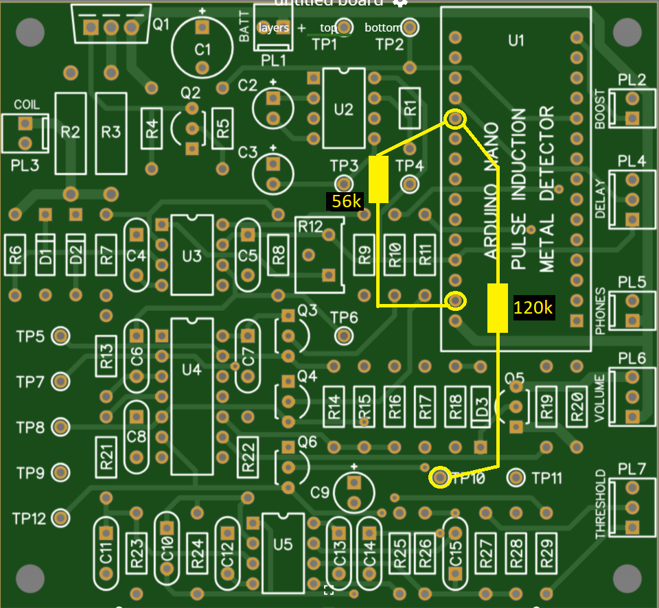

                This is a second mod to allow not only increases in volume in the presence of a target, but also increases in pitch (frequency + ampitude modulation). The human ear is much more sensitive to changes in pitch than in amplitude, so this feature can result in an improved detection experience.
                [ATTACH]n420152[/ATTACH]
                To use the attached sketch you'll have to do the PWM mod first (swapping pins 8 and 10) as explained on page 3, post #15
                This second mod connects the output of the amplifier (TP10) to analog input A1 of the Nano via a resistor divider. 56k from TP10 to A1, and 120k from A1 to GND. This limits the max. voltage at the analog pin to 5V.
                Click image for larger version  Name:	Mod_frequency.png Views:	0 Size:	503.6 KB ID:	420149

                  Here's the display code.
                  Place this snippet at the beginning of the sketch
                  PHP Code:
                  #define USE_OLED
                  #ifdef USE_OLED
                    #include <Tiny4kOLED.h>
                    #include <font16x32digits.h>
                  const DCfont *largeFont FONT16X32DIGITS;
                    const
                  DCfont *smallFont FONT8X16;
                  uint8_t width 128;
                  uint8_t height 32;
                  #endif​
                  This snippet at the beginning of setup()
                  PHP Code:
                  #ifdef USE_OLED
                  oled.begin(widthheightsizeof(tiny4koled_init_128x32br), tiny4koled_init_128x32br);
                  oled.setFont(smallFont);
                    if (
                  smallFont->width == 0) {
                  oled.setSpacing(1);
                    } else {
                  oled.setSpacing(smallFont->spacing 1);
                  oled.on();
                  oled.clear();
                  oled.setCursor(02);
                  oled.print("DELAY");
                  oled.setCursor(00);
                  oled.print("us");
                  oled.setFont(largeFont);
                    if (
                  oled.setSpacing(1);
                    } else {
                  oled.setSpacing(largeFont->spacing 1);
                  #endif​
                  and this snippet in the loop()
                  PHP Code:
                  #ifdef USE_OLED
                  oled.setCursor(700);
                  oled.print(mainDelay);
                  oled.print(" ");
                  #endif​
                  This is what you'll get
                  Click image for larger version  Name:	20240210_215145.jpg Views:	0 Size:	57.1 KB ID:	420154
                  If you won't use the OLED comment out the "#define USE_OLED" line and rebuild. Otherwise Nano will wait forever for a display to be ready that doesn't exist.
                  Install the following libraries in Arduino (using search box)
                  Tiny4kOLED
                  TinyOLED-Fonts
                  The display is 0.91 inch OLED 128x32 based on controller SSD1306. Like this one: https://www.aliexpress.com/item/1005006431809403.html?
                        Hmm, doesn't the analog voltage at TP10 cover +-5v ? The A1 input of the uP will only except positive 0..5v, are you relying on the uP input protection diode clipping the negative?
                        • #57
                          Yes I think I screwed it all up but I can't delete anything. I was trying to do too many mods at the same time.
                          Max output voltage at TP10 is +5V - 1.3V. We just need a diode with the anode to TP10 and cathode to A1 plus a 100k or so resistor from A1 to GND.
                          The input A1 has to work with is +5V - 1.3V - 0.6V; so the range for the ADC is 3,1V / 5V * 1024 = 635. This would be the maximum value of the "target" variable.
                          The mapping code is then
                          PHP Code:
                          word freq map(target0635FREQ_MINFREQ_MAX);
                          The 120k resistor should be replaced by said diode. Then all is good.
                          Click image for larger version  Name:	Mod-frequency.png Views:	0 Size:	508.5 KB ID:	420167
                          If instead of TP10 we link TP6 to A1 then we can do direct sampling and DSP, that's another game.
