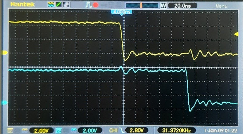

Modified sketch for improved timing precision.
  • #61
    For the frequency it doesn't matter. If we mask then the frequency will move in a few large steps like a cheap videogame sound. Let's try it first like this.
    That's why shifting right twice, as also suggested, to give 8bit resolution is preferred over simple masking.

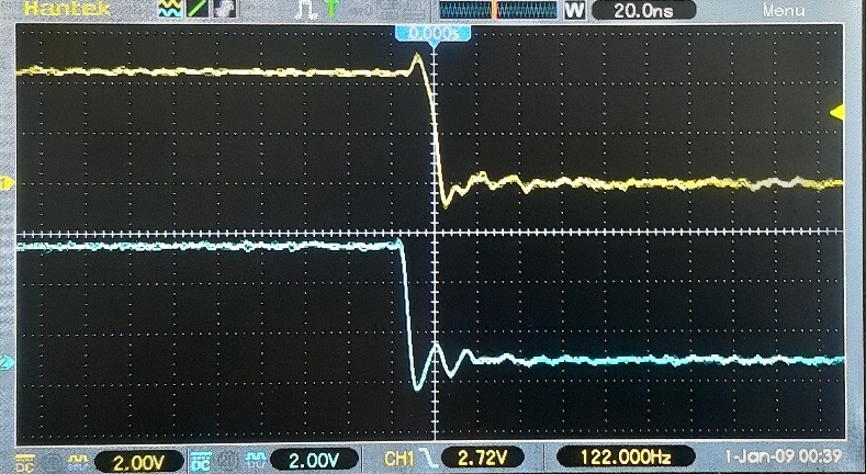

                  Example code to sync 16 bit timers Timer1 and Timer3 in LGT8F328P.
                  PHP Code:
                    * URL: https://dbuezas.github.io/arduino-web-timers/#mcu=LGT8F328P&timer=3&timerMode=PCPWM&clockPrescalerOrSource=256&FCPU_UI=16Mhz&OCnA_OutputPort=F1&CompareOutputModeA=clear-up%2C+set-down&OCR3A=85
                    * Mode     : PCPWM
                    * Period   : 31.875 us
                    * Frequency: 31.37255 kHz
                    * Outputs  :
                    *  - F1: 33.33%, clear-up, set-down
                  void setup(){
                  DDRB =   << DDB1;                 // Timer1 output pin 9 (D9)
                  DDRF =   << DDF1;                 // Timer3 output pin 1 (TX)
                  GTCCR << TSM << PSRSYNC;     // Freeze Timer1 and TImer3
                  TCNT1 0;                           // Clear timer counts
                  TCNT3 0;
                  TCCR1A << COM1A1 << WGM10;   // Timer1 configuration
                  OCR1A 85;
                  TCCR3A << COM3A1 << WGM30;   // Timer3 configuration identical to Timer1
                  OCR3A 85;
                  TCCR1B << CS10;                  // Start timers with prescaler 1
                  TCCR3B << CS30;
                  GTCCR 0;                          // Release timers
                  void loop() {
                  // put your main code here, to run repeatedly:
                  Without syncing
                  With sync (GTCCR statements commented out)
                  The difference is negligible taking into account that the efeSample delay is not critical. As long as the delay is constant. So we could do without the syncing.
                  • #69
                    Above: Without syncing should be "With syncing", the screen shots are swapped.
                    • #70

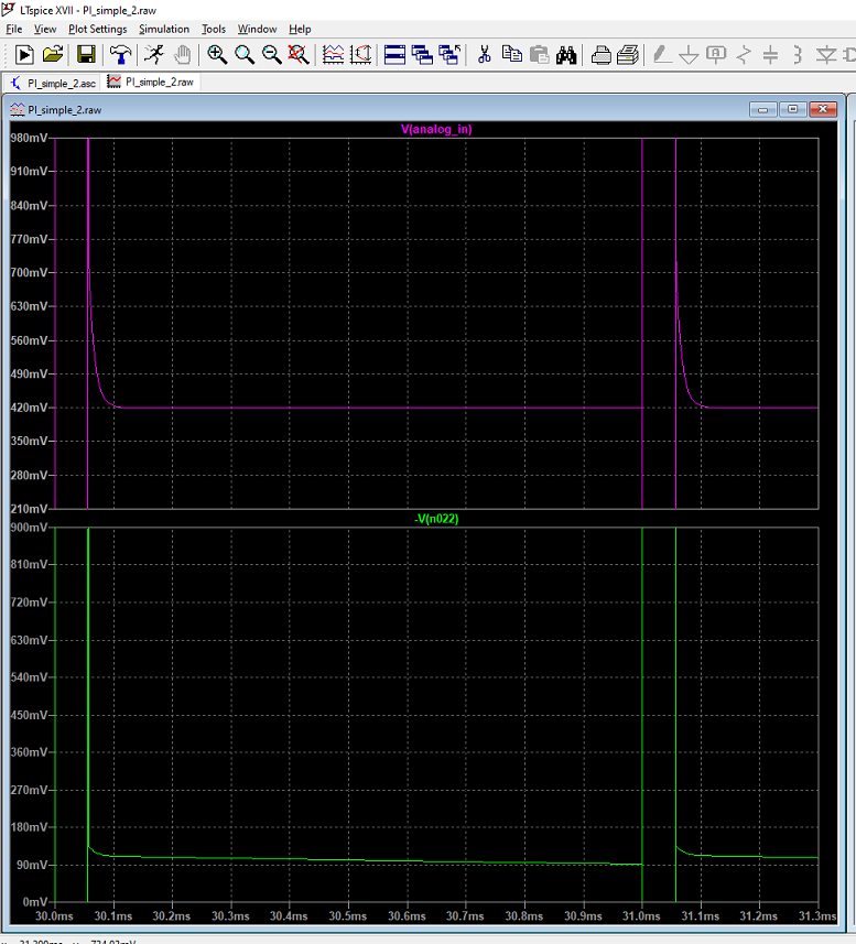

                        Now correct me if I'm wrong but C6 and R13 between TP6 and the input of the analog switches are totally wrong.
                        C6/R13 turn the EF signal (which is constant within one period) into a decaying exponential. After efeSampleDelay the signal being subtracted at the differential integrator is not the EF signal level that's riding on the main sample, but a decayed version at a lower level, breaking the EF compensation scheme.
                        In MOD3 (see /doc folder in the sketch distribution) I suggest removing C6 and shorting its pads, and removing R13. Then adjust the offset at TP6.
                        • #72

                          I don't think that will work. C6/R13 is a differentiator, and is a required high pass filter(Freq >34 Hz),
                          It also performs the task of getting rid of the DC component for the EFE stage.
                          In the field the EFE compensation must work, as I am not seeing any ground effect.

                            It's nor a ground effect, it's the voltage induced by the earth's magnetic field as you swing the coi.
                            EF is a DC offset within a period. If you pass it through an RC differentiator you get a decaying exponential. Just do the simulation.
                            Top: no differentiator. Bottom with differentiator.
Name:	Schermopname (371).png
                            To get rid of the EF component you wat till the target signal has vanished (that's what the long efeSample delay is for), sample it and subtract it from the (signal +EF) early component.
                            The differentiator is in the way. I would say the whole analog part is crappy, starting with the huge gain of the first op amp that kills any bandwidth.
