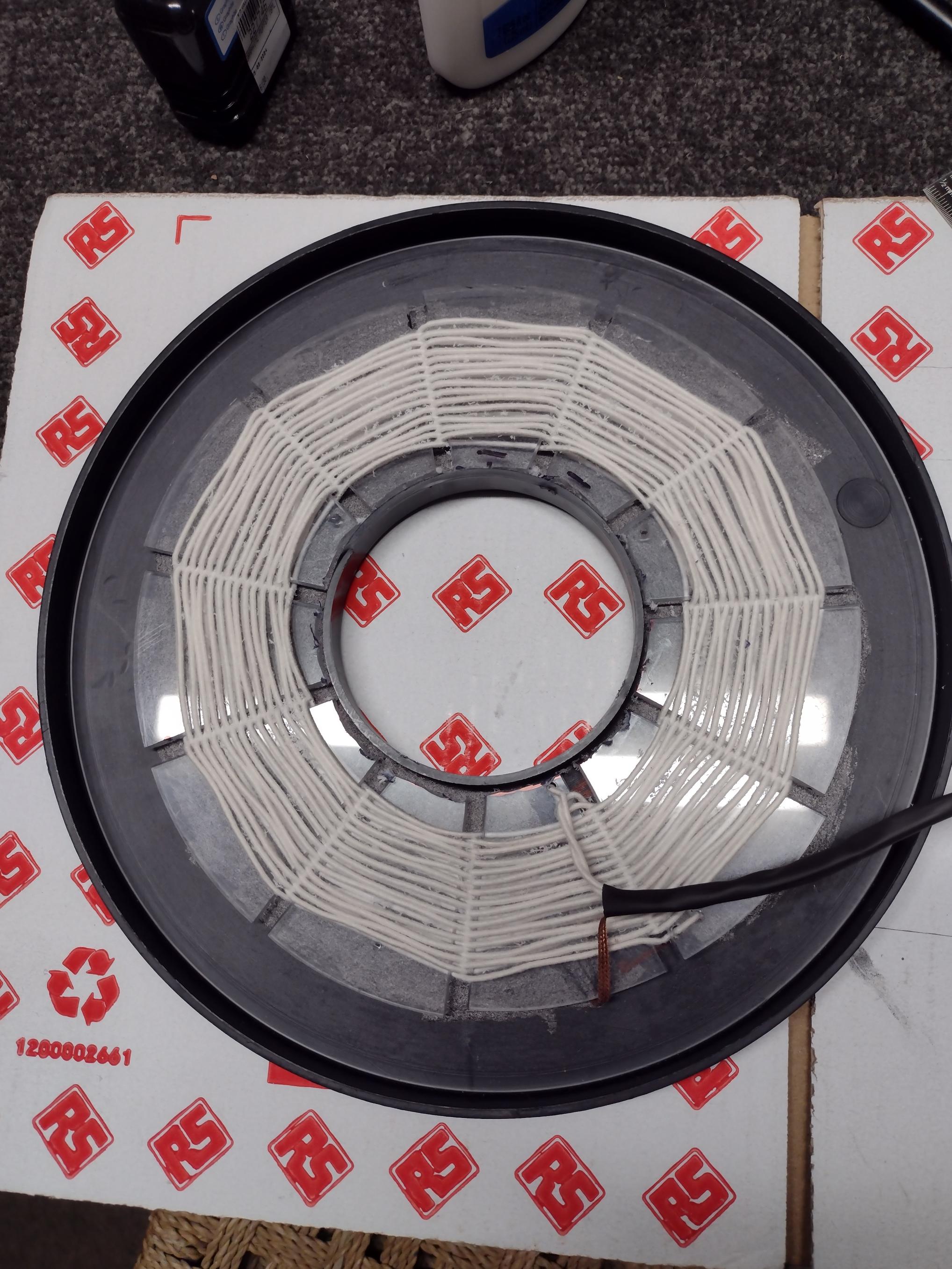

                      I did find some: https://www.synergyelectronics.co.nz...cy-epoxy-resin
                      Has some good specs and Dielectric constant of 4 (permittivity)
                      Here is my coil ready to be epoxied .. shield is made up from a mixture of Elmer's Glue and powdered graphite .. works well.
                      I will embed in a coil support, soon as I have it printed ..
                      Click image for larger version  Name:	IMG_20240228_150135285.jpg Views:	0 Size:	564.6 KB ID:	420854

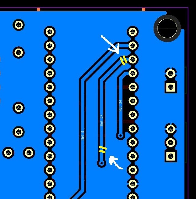

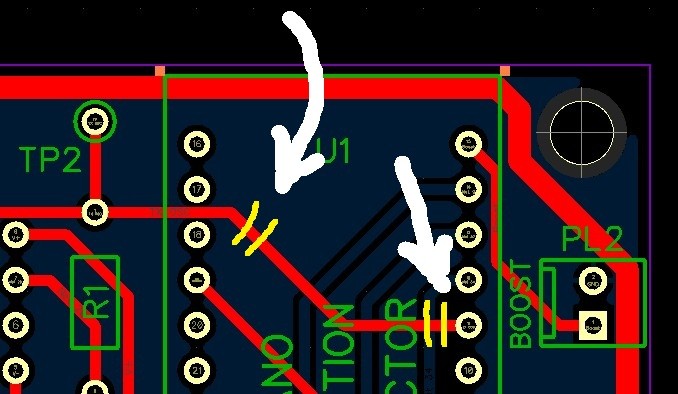

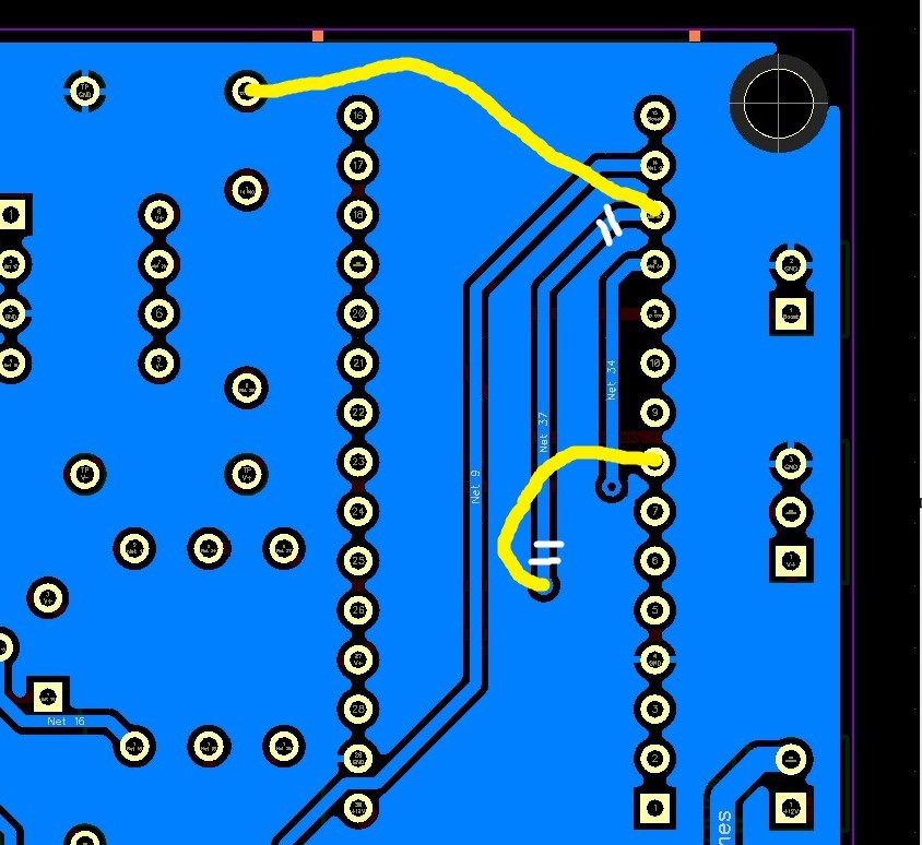

                            Is there a discrepancy between the implementation of PCB mod1 and the final schematic (wrt ArduinoPI_fullPWM_1_0_5) ?
                            The PCB mods move R11 to connect to a new Arduino pin8(D5) which is OK.
                            The PCB mods move R5 to connect to freed-up Arduino pin13(D10) which is OK, but the remains of that net i.e. U2 Oscillator (pin7) is left still connected to Arduino pin11(D8 ) which is shown as a no connect in the marked-up schematic. Doesn't this leave the oscillator unsync'ed? Doesn't R1 north need lifting and connecting to Arduino pin13(D10) also?
                            Am I missing something?

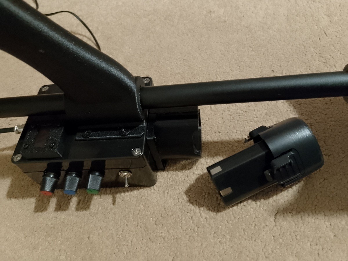

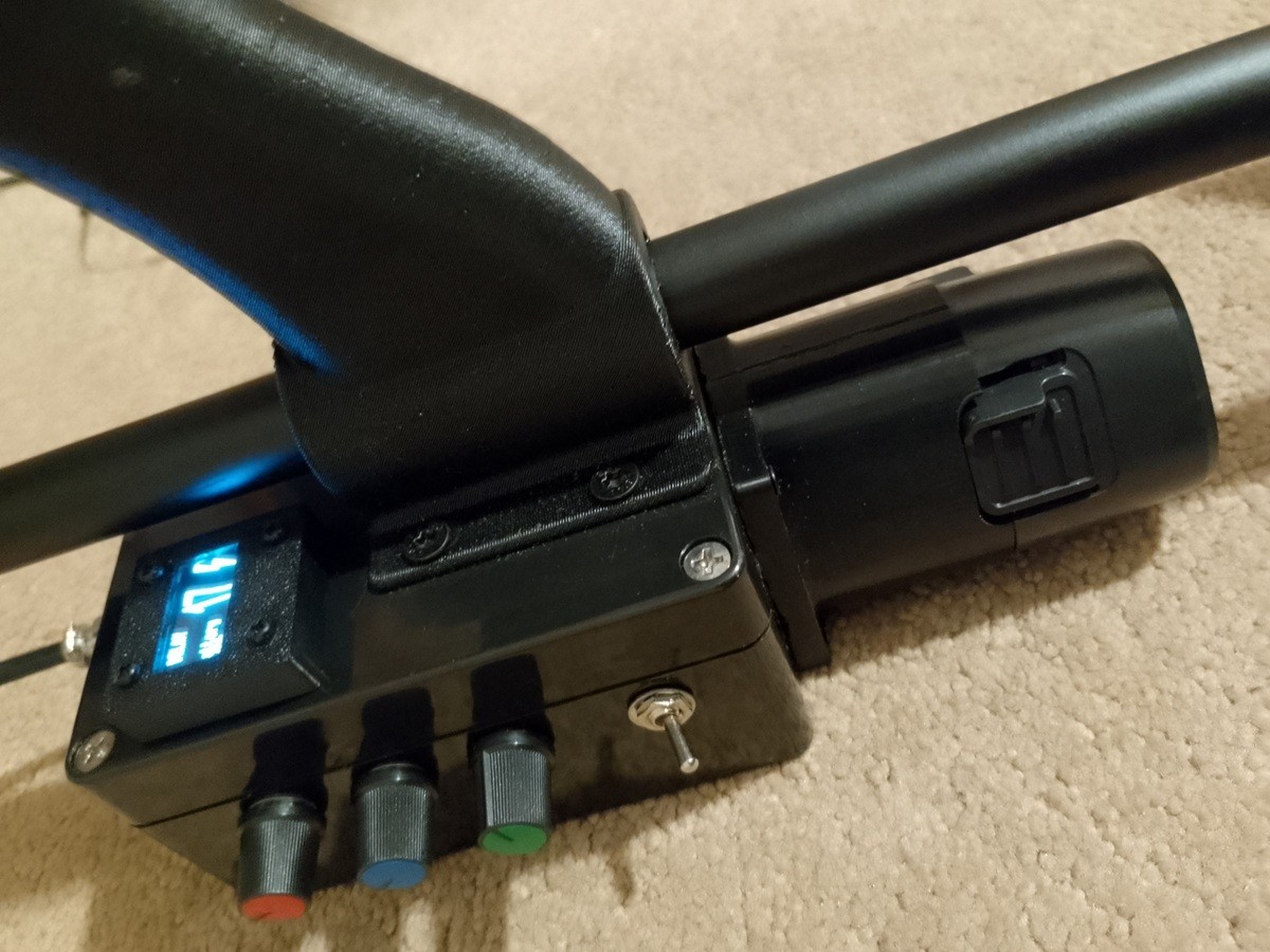

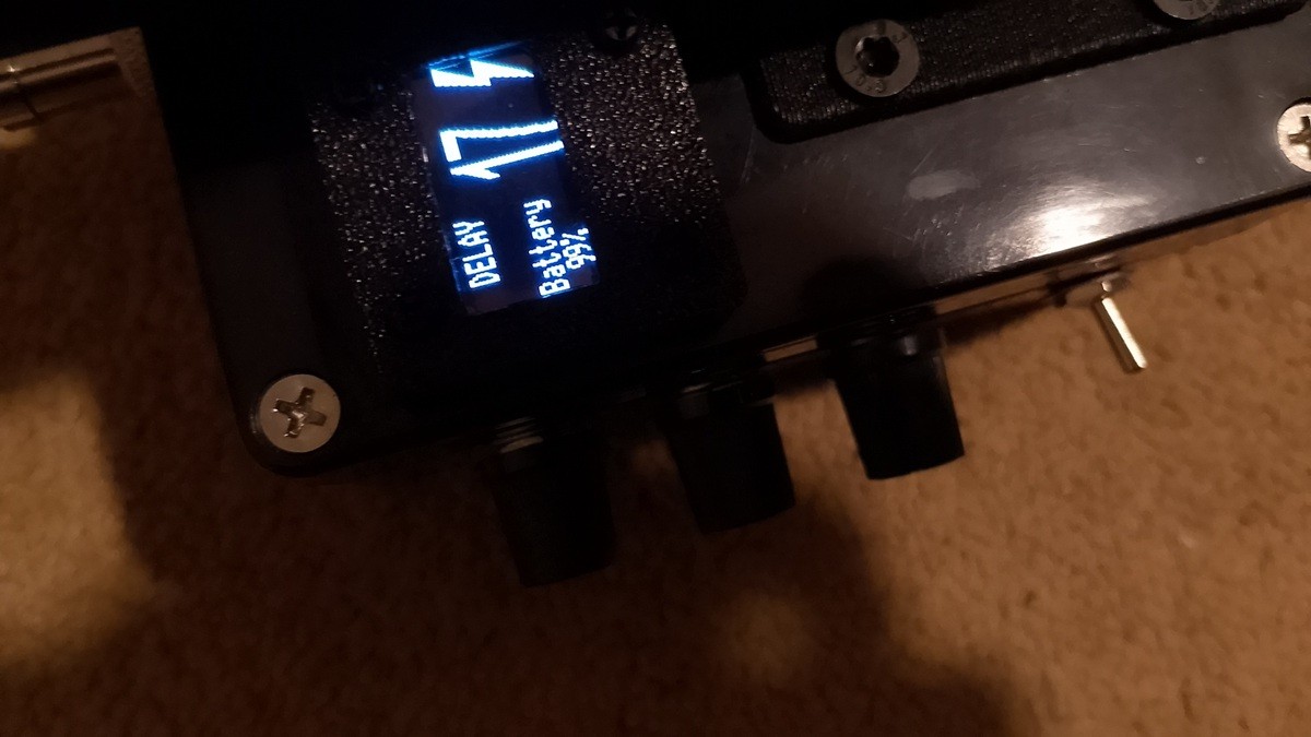

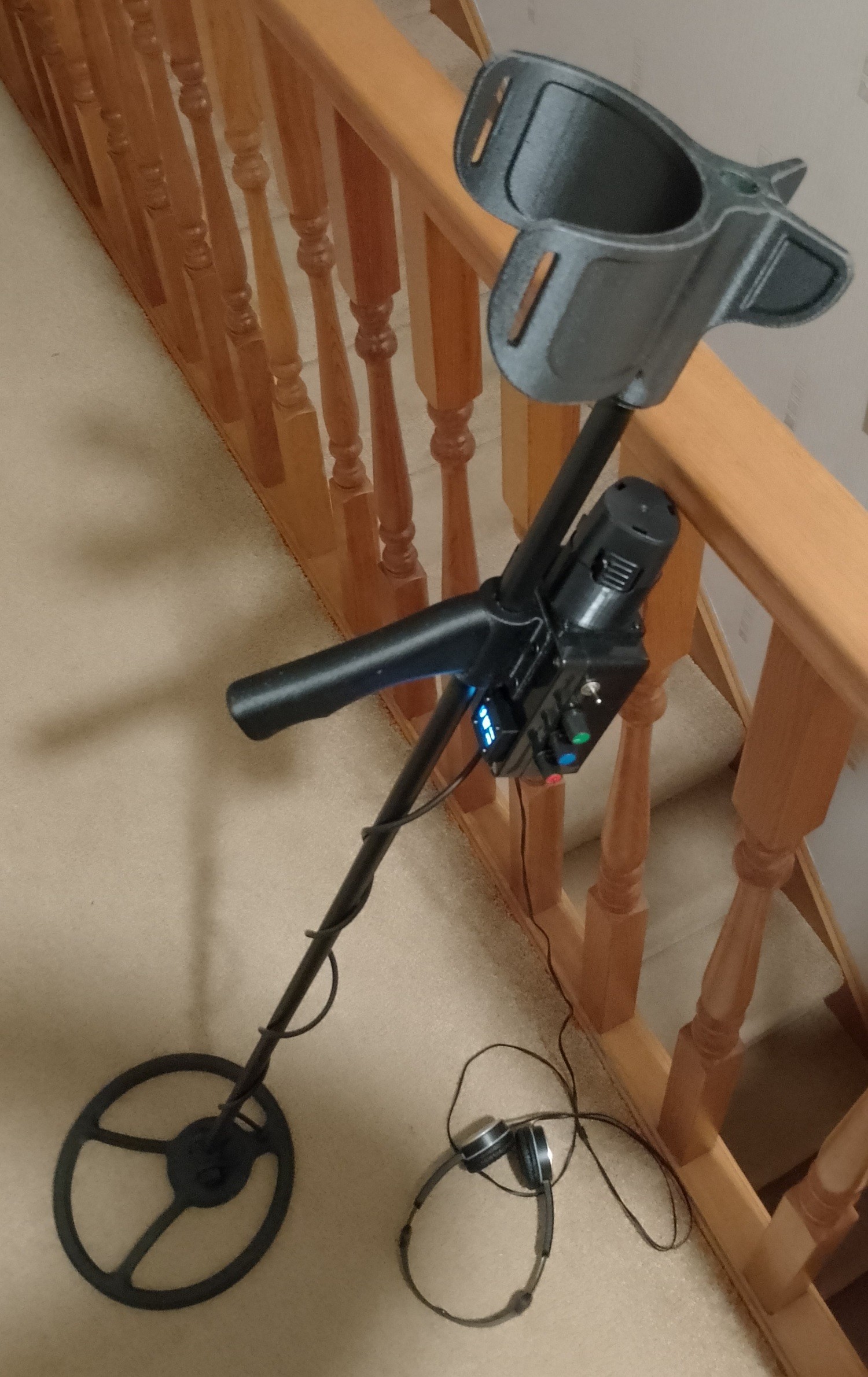

                              I have completed my build, all running well. I made slight change to the mods for swapping Arduino pins 8 &13, also added a pair of resistors to provide a Battery monitor at Arduino pin21 (A2) and tweeked the Arduino sketch to add the battery monitor. Just got some PTFE wire to see if there is any noticable difference when used for the search coil in place of PVC wire. (hope adding attachements works OK)
                              Click image for larger version  Name:	underside cut.jpg Views:	0 Size:	88.0 KB ID:	442524 Click image for larger version  Name:	topside cut.jpg Views:	0 Size:	68.2 KB ID:	442528 Click image for larger version  Name:	links.jpg Views:	0 Size:	137.1 KB ID:	442525

                              Click image for larger version  Name:	IMG_20251114_164154.jpg Views:	0 Size:	120.0 KB ID:	442529​ Click image for larger version  Name:	IMG_20251114_164318_PORTRAIT.jpg Views:	0 Size:	222.3 KB ID:	442526 Click image for larger version  Name:	IMG_20251114_164332_PORTRAIT.jpg Views:	0 Size:	222.2 KB ID:	442527
                              • #60
                                Nice work! I assume you figured out the R1 issue.
