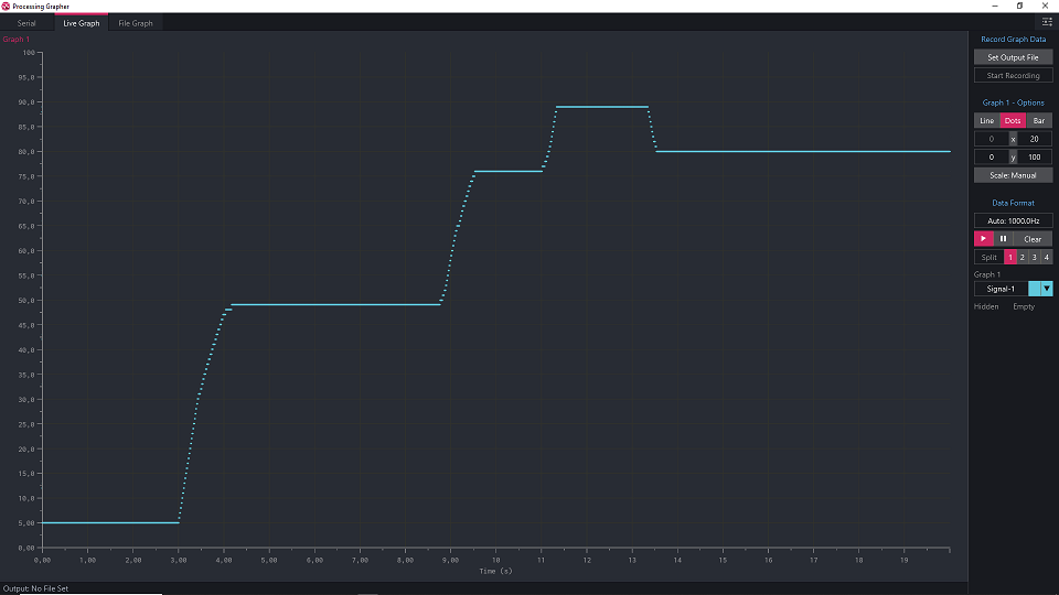

    If it works for you, go ahead. I stick to the IIR filter.
    The step reponse is really nice.
    Click image for larger version  Name:	Schermopname (369).png Views:	0 Size:	57.2 KB ID:	420524
    Just two lines of code
    PHP Code:
     // IIR low-pass filter of pot readings
    potReadingY = potReadingY - (potReadingY >> 4) + potReading;
    potReading = potReadingY >> 4;

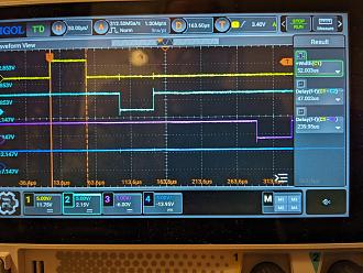

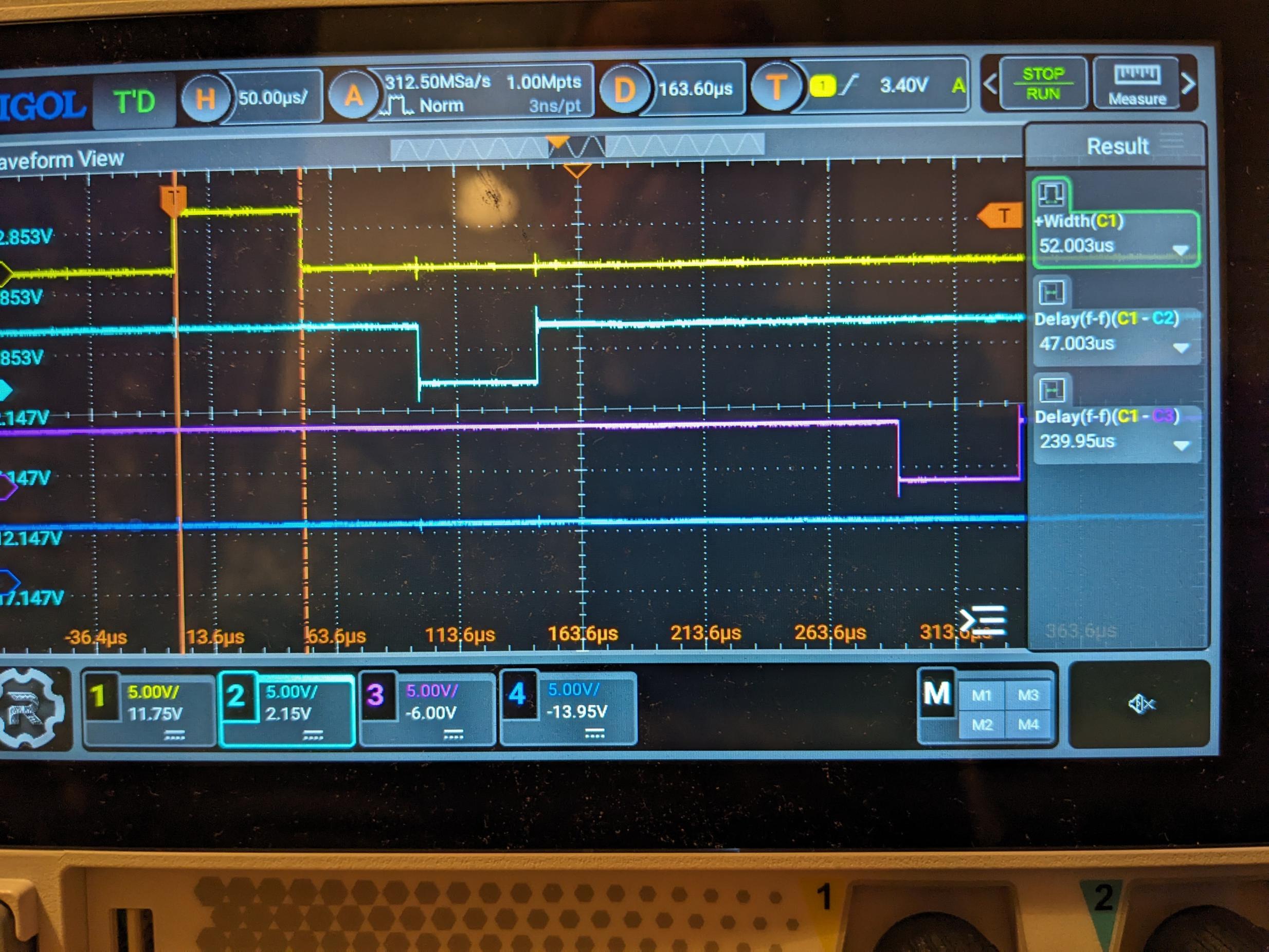

              Hi Teleno Just tried this build on a LGT board by itself. I notice TX pulse width is ~100uS, is that because boost pin will be floating without the rest of the hardware?
              Looks like it, just shorted D12 to GND, and now ~50uS .. will try it in the unit now. Cheers.
              For me it looks like I only have to take the EFI sample to D5 instead of D8 I had it in the other timing thread.

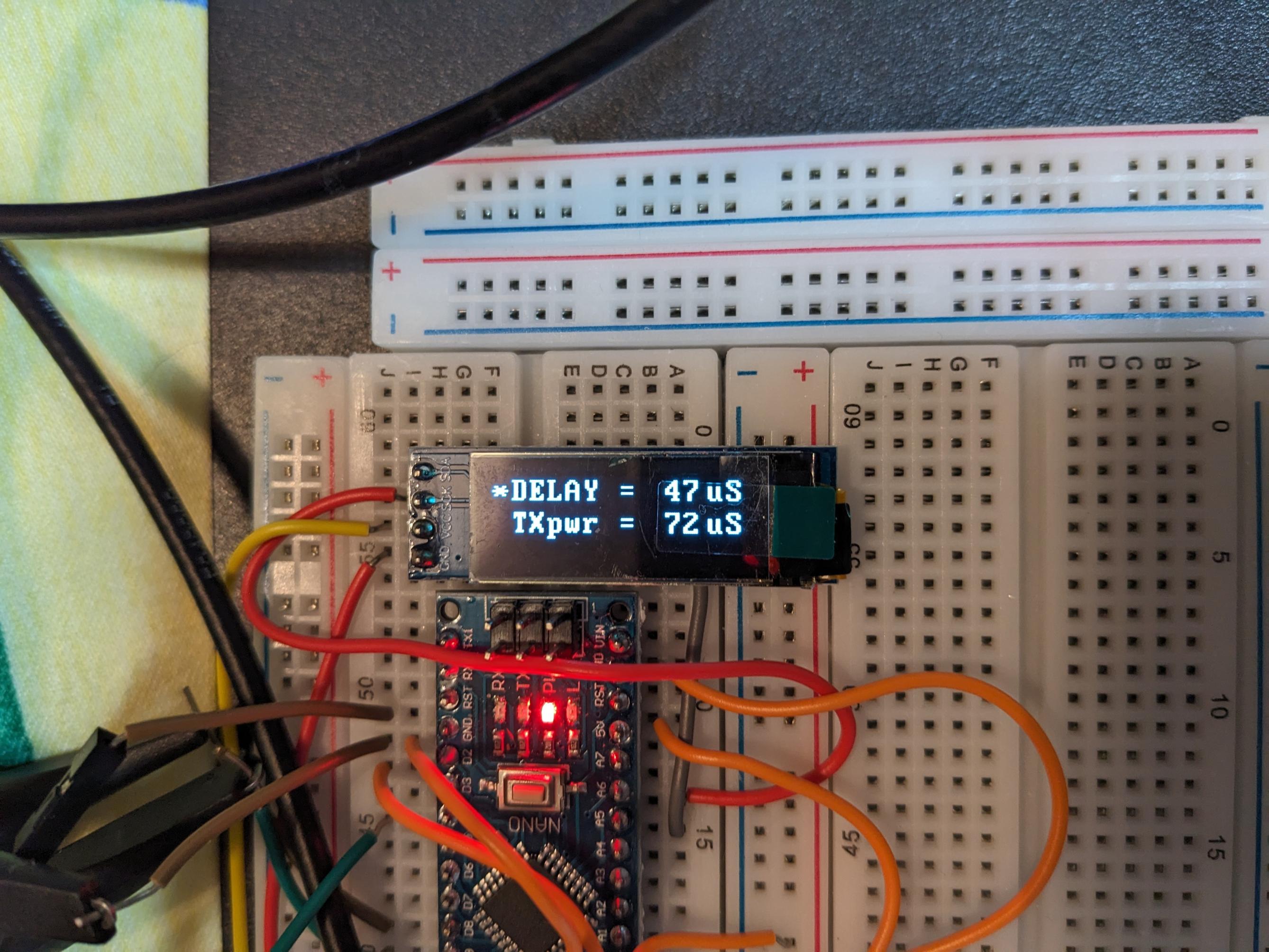

                        ArduinoPI_fullPWM_1_0_5EncoderBoost.zip ArduinoPI_fullPWM_1_0_5EncoderBoost.zip I just wanted to share the latest incarnation of Teleno's excellent PWM version 1.0.5 but now heavily modified to use an encoder to set main delay and TX power.
                        Pressing the encoder button toggles between setting delay or TX pulse width.
                        See attached photos.
                        A lot of stuff needs clearing out to make this a dedicated version without the potentiometer code though. All Teleno's hardware mods are still required for full functionality.
                        Click image for larger version  Name:	PXL_20240224_202411985.jpg Views:	0 Size:	520.6 KB ID:	420748 Click image for larger version  Name:	PXL_20240224_202440275.jpg Views:	0 Size:	503.5 KB ID:	420749
