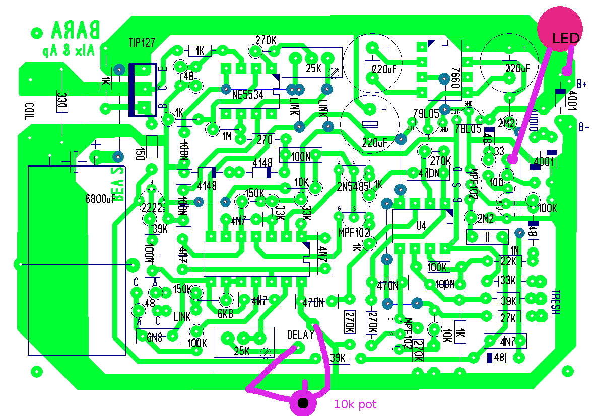

    Just double checking placement of two items . Please let me know if correct.

    by satdaveuk Hi Sinclair The LED is directly wired between +...
    Hi Sinclair
    The LED is directly wired between + supply line and the junction between R35/R36
    It mimics the audio responses perfectly providing your speaker load is 32 ohms as Barracuda manufacture...

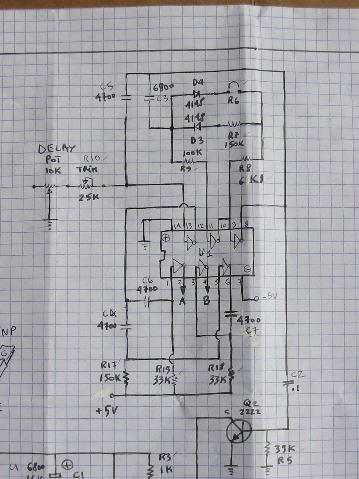

    hello sven
    the second delay 10k is only connect pin1 from pot to 25k trimmer and pin 2 from pot under 470N cap (where the word delay stands)
    i dont use 10k pot
    i only use a 22k external pot instead of trimmer and next there instead of a 10k pot a wire bridge
    it works in a wider spectrum

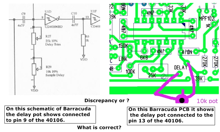

          I have a question that has arose since I am messing with my cuda. The delay has never worked correctly and or the added 10k pot
          does absolutely nothing. I have tried it numerous different ways but still get no response from the pot.
          Which or what is the correct way to wire in the second pot, anyone have a pic of which way is the correct position of the legs, 123, top or bottom of pot
          or does it matter and also please see attached pic, I found this which looks to me like a discrepancy where the trim pot is wired. Is this correct, incorrect
          or what the hey...

            on the board is the right connection according to bara original schema.
              So if that is the case the trimmer connected to pin 9 of the 40106 on the schematic is wrong/incorrect?
              (attached the schematic)
              [schematic deleted]

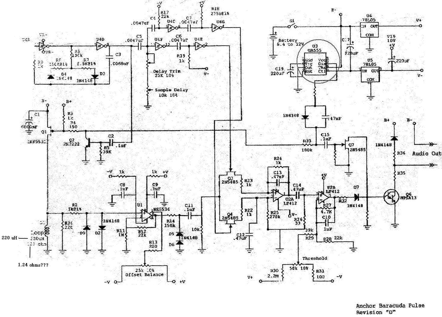

                delete this schema. it was drawed by Alexismex, one from much his revisions. I did not remember that he drawed last rev and without mistakes.
                he left this job at half of a way. use this original schematic.

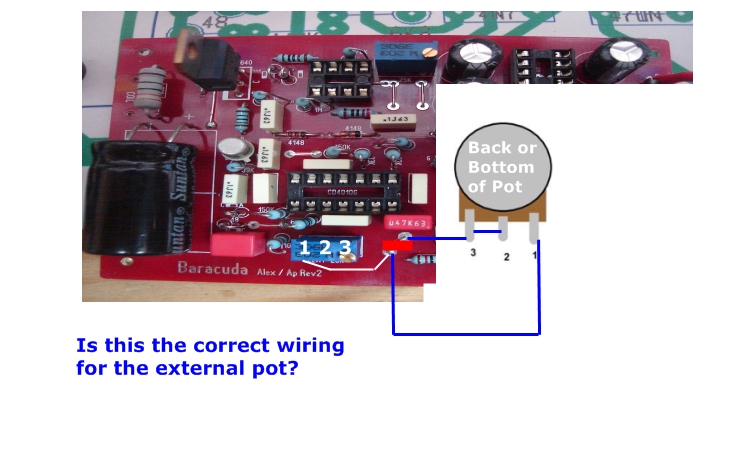

                  Ok, so now I know that schematic is garbage..... Thanks KT315
                  How bout the pot wiring, how to wire the pot correctly with the trimmer,
                  I guess maybe I'm not explaining or asking the right question...

                    Ok, here is a quick mock up of what "I think" is the correct way to
                    connect the external pot.

                    Please correct me if I am wrong... Thanks guys..

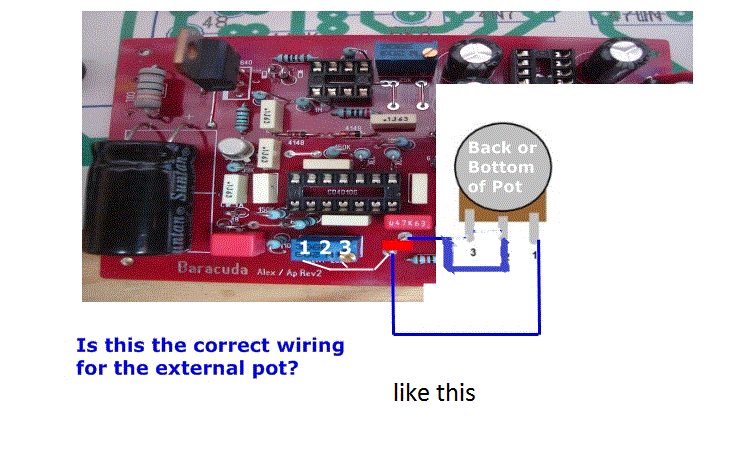

                      dont use terminal 3, lower point to 1, upper point to 2 and 3 not connected.
Name:	pot wiring.gif
                        Oh Thank You Sinclaireuser... That is what I was wondering, I do actually have it wired correct,
                        but just wanted to make sure the 3rd post wasn't being used with the 2nd jumped over....
                        For whatever reason it doesn't seem to make any difference with the added pot, no changes
                        that I can detect anyhow at least for my particular board/build.
                        I appreciate you taking the time to answer...

                          yes lots of us had the same experience which is why it was discarded, bernte's solution up the thread works, replacing the preset with a 22k external pot, but you have to manually set up the detector every time you use it.
                            Ah, ok... Hadn't seen where it hadn't worked so I'll maybe switch it to the way bernte did it.. It works good the way it is
                            just wanted to see what the difference was with the added delay pot.
                            I'm getting decent detection with a makeshift spider/basket coil I wound for it so may just leave well enough alone...lol..
                            Thanks for the help with it...
                              You did cut the track and wind the on board trimmer to zero ?
