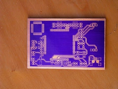

      I have a problem with the gerber files. I want to print it for toner transfer and i have the top copper layer which looks fine for printing,
      but the bottom copper layer looks like the pcb itself, red.
      • Comment
        • Originally posted by BKY1337 View Post
          What is the minimum voltage for the geotech baracuda? Can i run it with a 9V battery?
          The input voltage range for the Geotech Baracuda REV-A is +7V to +15V, as described in the Build Document.
          The PCB layout is not designed to be replicated at home using nasty chemicals.
          The options are:
          1. Send off the Gerber files to a PCB house.
          2. Order a PCB from silverdog.
          3. Make your own single-sided layout suitable for manufacturing at home.

              • Because it cost me less than 10 Euro and its just a little project for a pinpointer. I have everything at home and i just need the parts.
                I have already asked kt314 for the price a week ago , and i sent him a pm today. I think i will buy a board from him, i just need the partslist lol.
                I have heard that he made little changes to the board , so i think the partslist is a bit different too.
                Can you give it to me pls. This will speed things up.
                Or i will send the gerber files to pcbway and get 10 boards for 18 Euro and sell the rest of them.
                Or i will search for a surf pi pro layout which is easier to build and to etch. Is there a single side sprint layout from the surf pi? Not the longboard pls.
