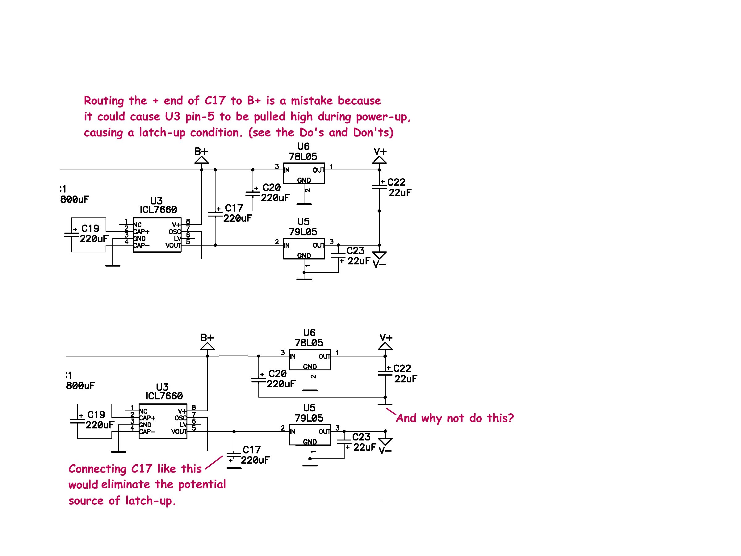

                            • whoops, I intended this for one of the other Barracuda threads.
                              Polymer posted a '7660 Do's and Don'ts around here somewhere, but now I can't find it. That's what I was referring to in the drawing.
