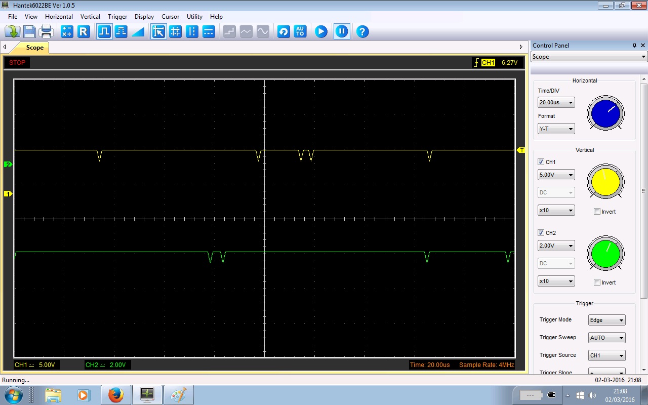

          OK the battery voltage is 11.5V
          Pin2 CH1 Pin4 CH2 here Click image for larger version

          • Impulse, here is what the sampling pulse (bottom trace) and the 5534 pin 6 signal should look like if it is correct.
            http://www.geotech1.com/forums/attac...9&d=1309516746
            Your preamp pin 6 signal is right, the sampling signal is not. In fact all of the signals associated with the 40106 look wrong. Once we get the 40106 working it should be a simple matter to adjust the delay to the correct position.
            Cheers,
            • o and the probes are 10X and the channels have been changed to 10X

                Pin2 CH1 Pin4 CH2 here [ATTACH]35381[/ATTACH]
                Well, those are still wrong (perfect measurement, just wrong waveforms). Don't worry about the time, I now have enough time in it that I must carry on. I will try to keep a stiff upper lip! See post 185 for what the sample waveform should look like.

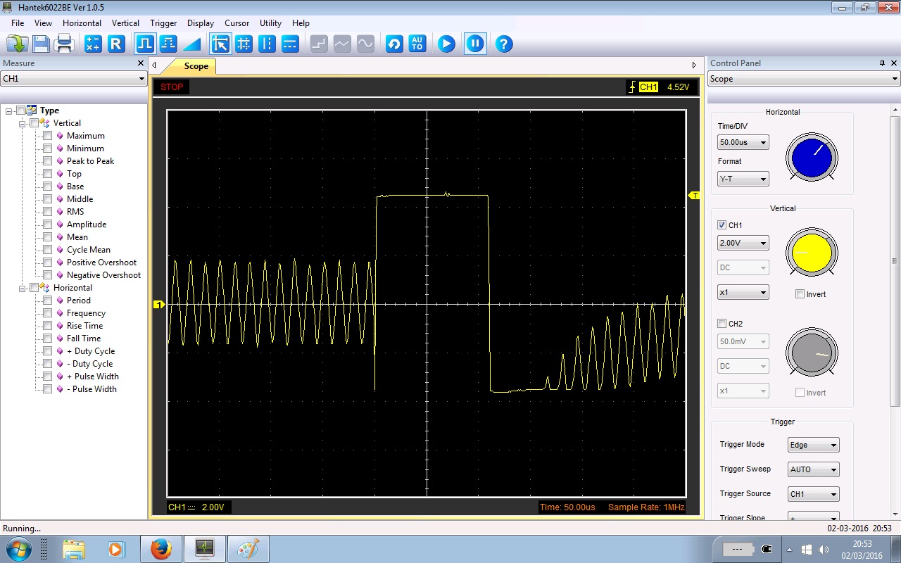

                • Old cart thank you, and out of curiosity i had a look at pin6 of the 5534 and this is what i got since playing with the soldering.

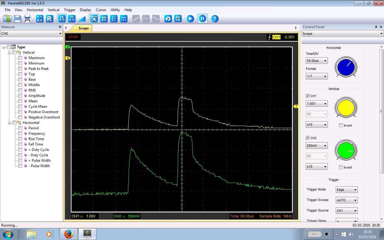

                      i have put CH1 and 2 on the output of 78l05 and 79l05 and this is what i got ?
Name:	78l05 79l05 output.jpg
                        here [ATTACH]35383[/ATTACH]
                        Actually I meant MULTIMETER.
                        • ahhhh i c sorry! ok 5.067v78l05 5.020v79l05 batt 11.45v
                          • Impulse those look good. It would not hurt to charge the battery.
                              here [ATTACH]35382[/ATTACH]
                              This looks like the damping resistor has either burned up or become unsoldered.:<(
                              Looks like you also went back to using x1-GOOD SHOW, you are learning! I thought the x10 was causing loading problems. It was not and making the signal smaller only succeeded in adding more noise.
                              • ok i have measured the damping resistor and i get 2.1ohm (AH!!!!) i will replace it once i get a new soldering iron as my last one no longer functions as it should (should be tomorrow)
