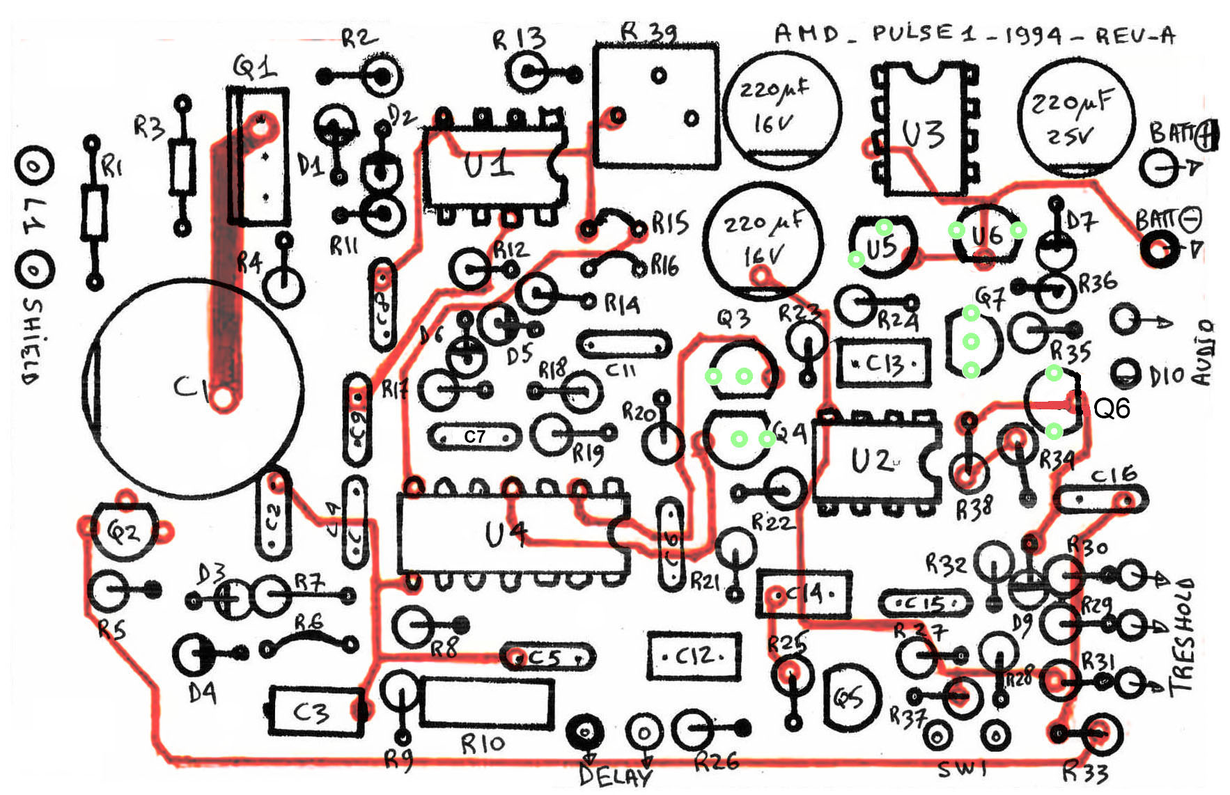

        @kt315.... sorry I just noticed the 40106 is connected to Ground and -5 volts but on silverdogs it's +/- 5 volts...
        Both will work obviously but does anyone one know the reasoning behind the change?
        Can't help thinking it would be better connected to +/- 5 volts...
        Mike
          @mike. is silverdog the developer of the schematic? or Jim Pugh passing away from you an unknown man?
          why you so want to change something in the design?

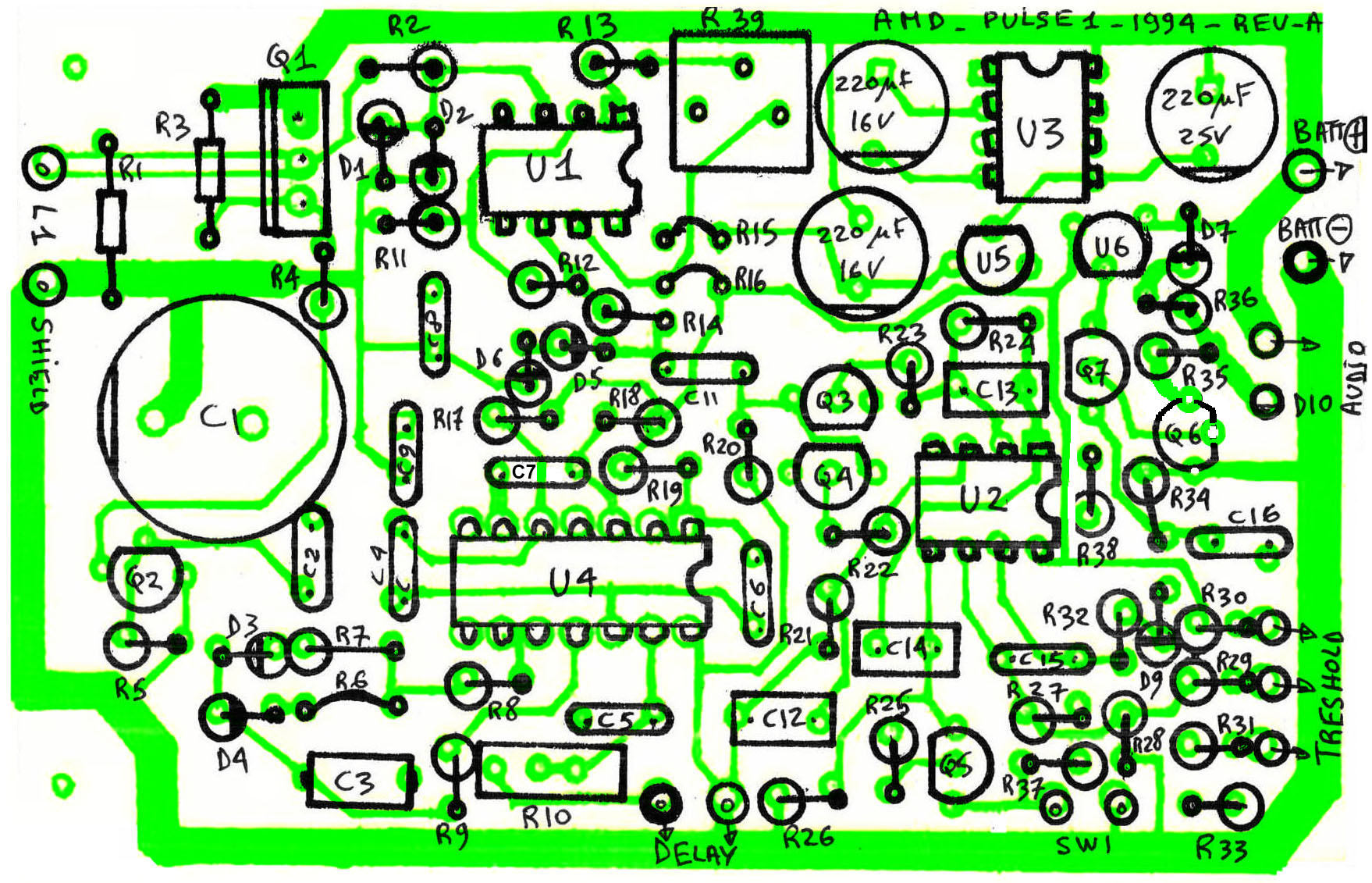

            Originally posted by Michaelo View Post
            @kt315, can you post that image without the the pop-up (Edit Nets window), that way I can see the rest of the traces?
            Mike
ID:	345207Click image for larger version
              I'm new to all this, I don't know who designed the board or the layout, I just want to experiment.

                I also assume the design is in the public domain and there are no issues with building or modifying it?
                No issues.
                  The board in my kit was designed by APBerg
                  If you look in this thread you will see where it all started
                  http://www.geotech1.com/forums/showt...light=baracuda
                    my layout
                    - where possibly almost all traces were doubled on both sides
                    - power supply traces to preamp were optimized for low noise factor
                    - on every IC was set a tantalum on bottom side
                    - you can set on r15 and r16 inductancies instead resistors, 80-100uH
