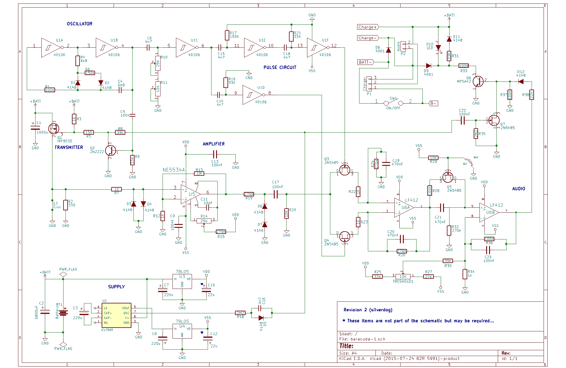

                          • #43
                            Baracuda Rev2 (silverdog)
                            Because all schematics I have found are not correct for Rev 2 (silverdog), I have done a quick schematic containing fixes from Qiaozhi's post (link below)...
                            It's not an exact match as part numbering is different (components cover the values and using any other existing image is a non runner)...
                            All the component values should be correct but if anyone spots errors, please post and I will fix them...
                            Notes:
                            Ignore component numbering for now...
                            Different schematics appear to have the amplifier balance circuit incorrect (according the datasheet), the one presented here is correct...
                            There are a few decoupling capacitors added as they are required for perfect operation...
                            The circuit includes the additional pot (10K) for delay, mounted off the board...
                            The layout is not exactly like the others but over time I will try to get them close...
                            Qiaozhi Fixes: http://www.geotech1.com/forums/showt...486#post215486

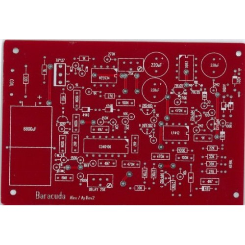

                              Here's an image of the blank PCB from the Silverdog website. It's a bit flurry, but the component values are still quite readable.
                              • #45
                                Juts doing a preliminary check and it has a TIP127 but we use the IRF9640... makes you wonder if there are more differences...
                                Think that's an older version as the board I have has the correct MOSFET marked on it...
                                Will do some googling and see if I can find some more board, you never know...
