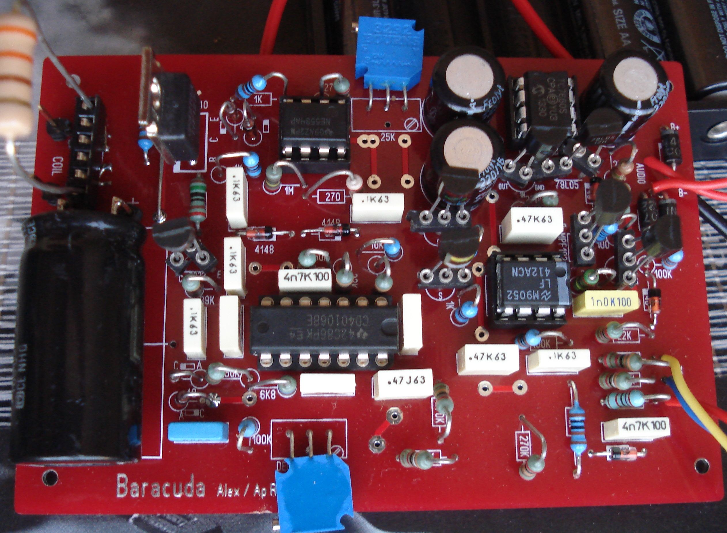

    My pcb Rev2
    • #47
      It also has the TIP127 (IRF9640) but everything else appears fine....
      Now to check my parts...
      Pretty sure I've got the right values now, just one update to the schematic (should be MPSA13, is MPSA42)...
      Thanks guys...

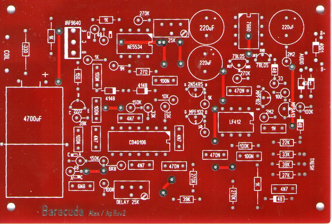

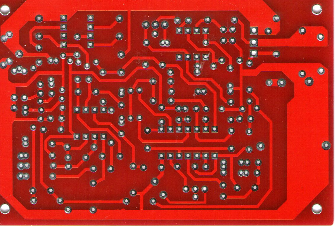

            My pcb Rev2
            Can you post higher resolution version of this? Maybe each side as a separate image, but the same size image for both sides.
            If if no one has a layout with both sides superimposed I wil have my son give it a go with photoshop. This wil give an x-ray like view and make editing and analysis easier.

              • #52
                Later today @ 600 dpi.

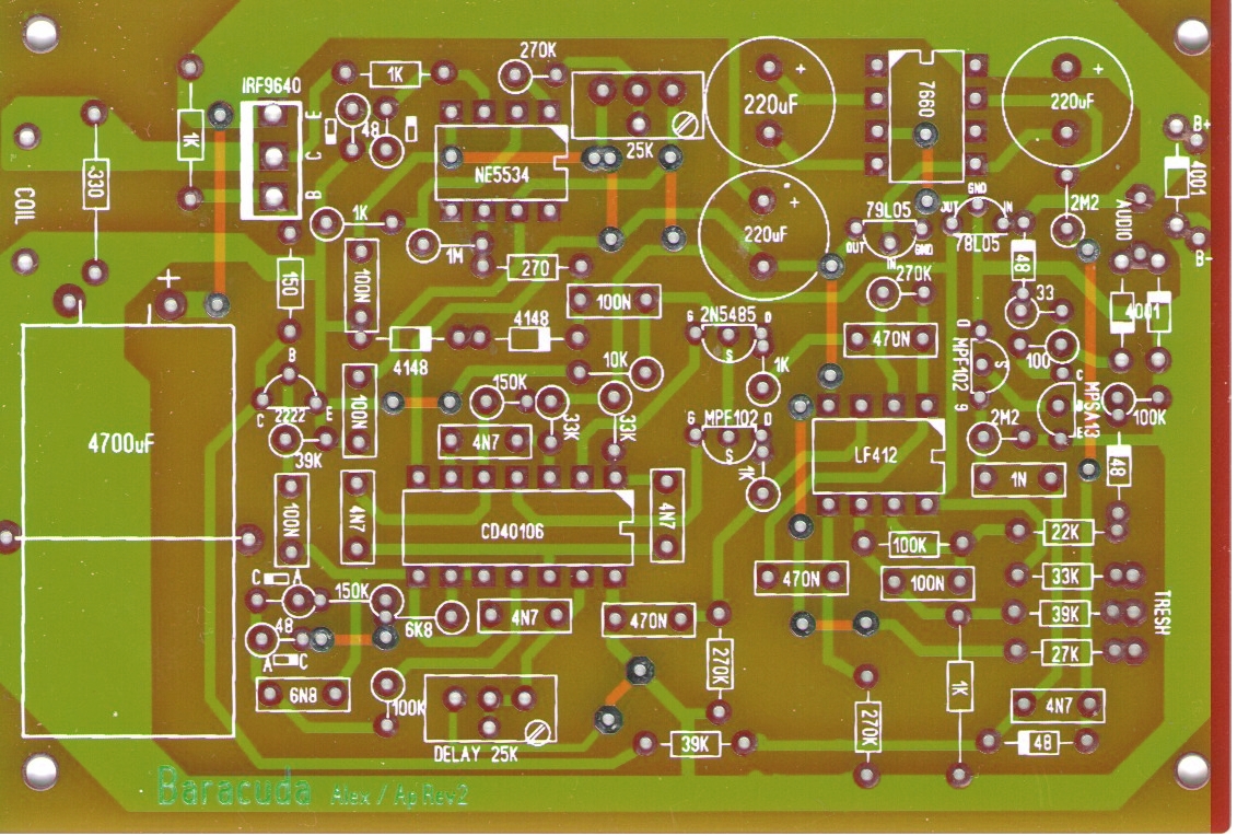

                          @old cart, 6666, Paul B
                          Here a superpostion of Paul B's jpgs of the bara board. Hope it's x-rayey enough ...
                          Made the bottom traces green so as not to mix them up with the top ones.
                          • #58
                            @Paul B... the image is perfect... now I have something solid to work with... thanks for posting...
                            @polymer... ?

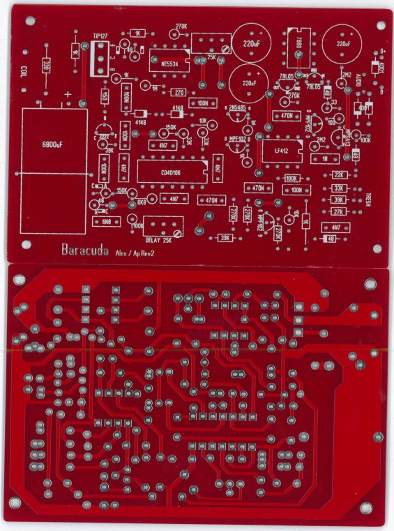

                            • #59
                              My pcb Rev2
                              Just looked at my pcb Rev2, it's different ... the holes and traces for the MPF 102 and resistors are missing ...
                              The plot thickens ... drum rolllllll.
                              • #60
                                [ATTACH]35721[/ATTACH]
                                666 is an early board. The 102 was connected to a switch that was never connected on the original detector. A few people's detector would not fire up until it was taken out. Been dropped from builds ever since with no problems until now. All info on it is in the original long thread
