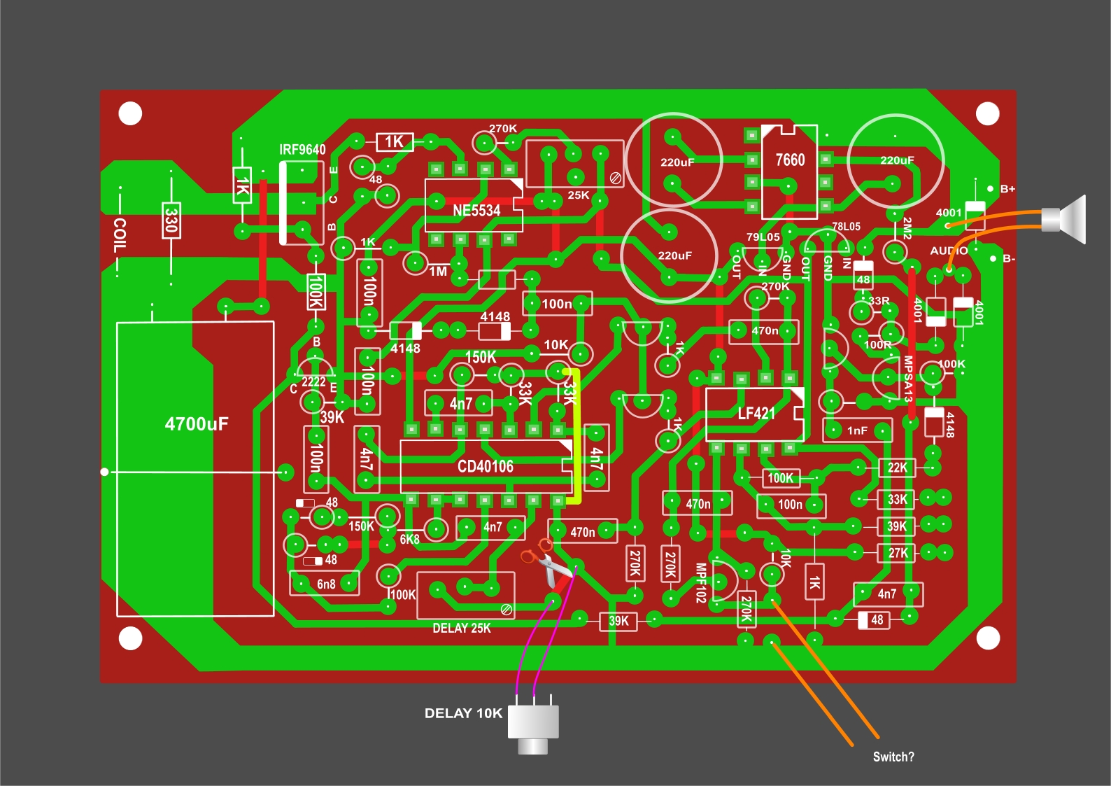

        Rev 2 (vectored)
        Though I play around with Xara (vector graphics) and put together an image inspired by Polymer's xray image...
        Don't appear to be able to attach as inline... ;(
        I like to play with vector graphics and I thought why not... also as my eyesight is poor, being able to enlarge without loss of composition is a bonus... mind you I still haven check every single component yet... I've added the 40106 resistor fix... it might come in useful if you need really large images without blurring...
        Mike

            Very nice! I to have bad vision. Is there any way to change the links on the top of the board to a different color? Red blends in. Better yet make the board gray or black.

              Whats an LF421

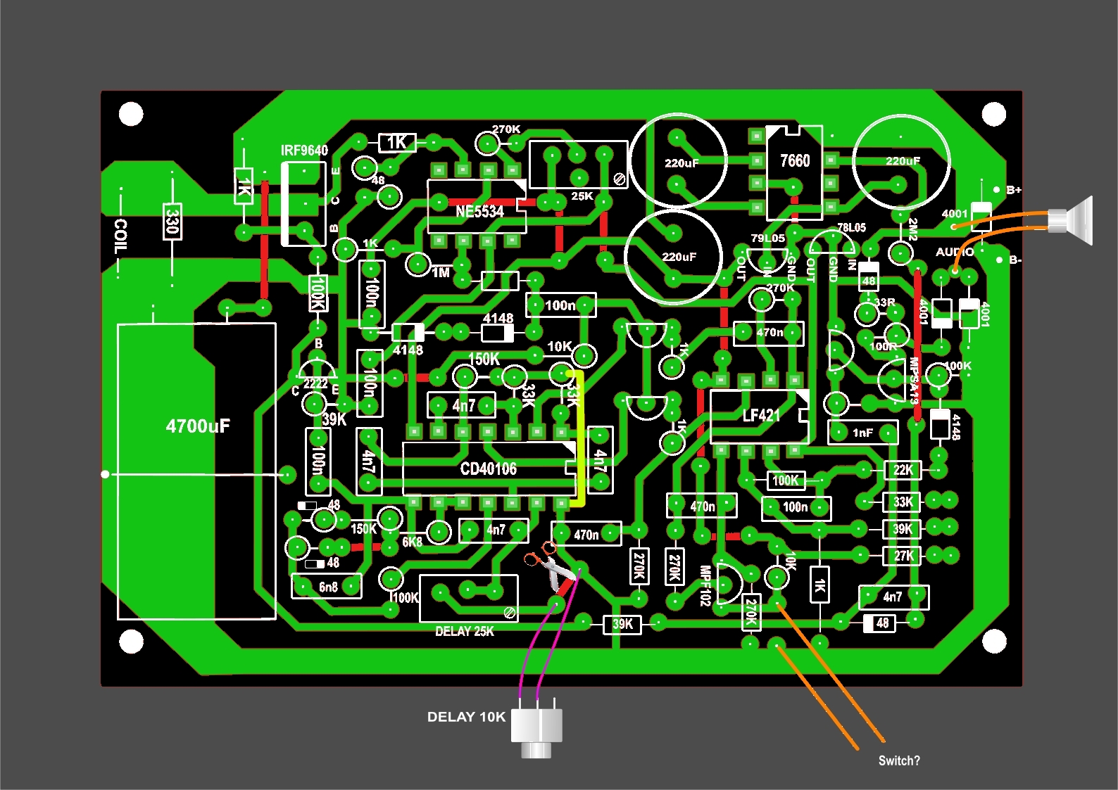

                  • #84
                    Here you go ...
                    • #85
                      [ATTACH]35748[/ATTACH]
                      Mike
                      Nice vectored rebuild Michaelo!
                      What's the light green track doing in there?
                      Please don't put anything new on the board ... yet. It may cause more confusion.
                      As 6666 has mentioned could you please correct the typo "LF421" to "LF412".
                      Thanks!

                            • #89
                              Thanks!
                              I started off making the rev 2 but ended up adding the recent fixes and kept on going... but your right, it will confuse so I will edit and post rev 2 board...
                              I may add one with all official fixes later...
                              • #90
                                I understand how easily things like that can happen. I might have been a bit strict, but I started with the Baracuda 1 1/2 years ago and found reading all the posts quite confusing and put it to the side.
                                I would like newcomers to not have to go through the same experience, although I did learn a lot on the way which I did benefit from.
                                As I see it you have kicked off the development of revision 3 with your thread and I am pleased to see that.
                                Looking forward to having your improvements added to the new version.
